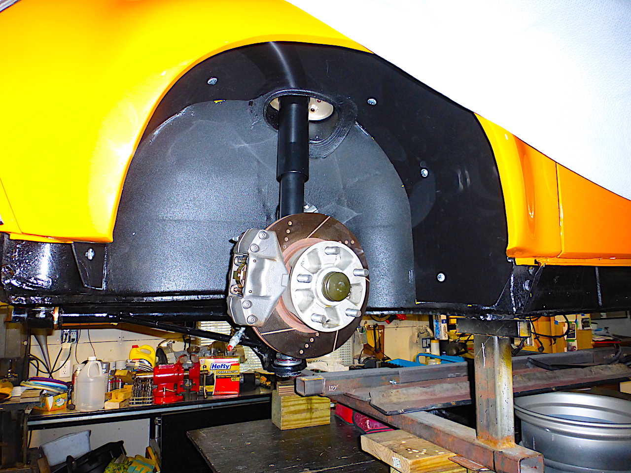

And you can make your own. ABS plastic form Speedway Motors. Mine I made because of the GT Flares. Best, MarkAttached Image
mlindner
post Aug 20 2018, 10:16 AM
Posts: 1,688
Joined: 11-November 11
From: Merrimac, WI
Member No.: 13,770
Not ABS but Polyethylene plastic, comes in rolls 22 inch wide x 10 FT and is 1/8th thick. Great product for fender liners, splitter, inner door cards etc.
