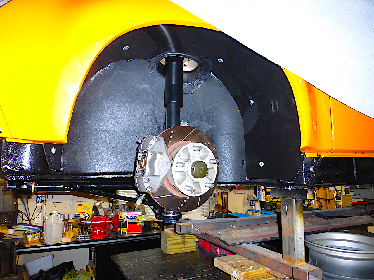

And you can make your own. ABS plastic form Speedway Motors. Mine I made because of the GT Flares. Best, MarkClick to view attachment
mlindner
Not ABS but Polyethylene plastic, comes in rolls 22 inch wide x 10 FT and is 1/8th thick. Great product for fender liners, splitter, inner door cards etc.
