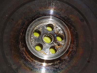

OK, I have a question. Babydoll's flywheel looks pretty good, surface-wise, and has a good pilot bearing. There is an area that looks fairly chewed up, but I don't know if it's anything to be concerned about. In the recess, where the O-ring seats, the flat surface isn't very flat. Is this a problem?
zymurgist
post Jul 10 2005, 08:04 PM
"Ace" Mechanic
Posts: 7,411
Joined: 9-June 05
From: Hagerstown, MD
Member No.: 4,238
Trying to post a picture.
