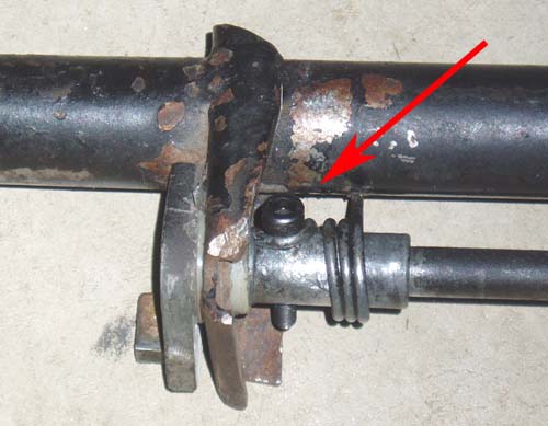

Here's a closeup of the area in question. It appears that there should be a bolt or a pin or something that goes all the way through the tube, and the spring hooks around it to provide tension. Can I just run a high strength bolt through the hole (see yellow arrow) and hook the spring around it?

yea, there should be a little hook looking thing there... it goes into a slotted piece on the cross-member...

The hook is there... it appears to have been retained to the tube by a bolt or a pin in the past. That pin/bolt has since disappeared, allowing the hook to move independently of the tube. I'm guessing that a 12.9 or Grade 8 bolt through the hole should tie them together and form a surface for the spring to act upon.
Apparently the hook is there to set the rake adjustment, with two little hinges at the back of the seat mount where it bolts to the body. At least they look like hinges... they appear to be frozen. Oh well, a little WD-40 should clear that right up.

I haven't gotten to the seat hinges yet, since I would have to take two covers off of Babydoll and it was brutally hot last weekend and now it's raining... but I did find some time to fix the seat frame. I went to my local Ace Hardware and bought a 12.9 Allen head bolt, 5mm x 0.8, 30mm long. I drilled the hole all the way through the bar to make it just large enough to tap the hole, then I ran a 5mm x 0.8 tap through it. The bolt has an unthreaded portion near the head... I just threaded the bolt all the way down to where the thread ends, and then looped the spring over the unthreaded portion. I don't think it will work loose, because the threads go all the way through the bar, and the spring tension should keep the bolt from wandering.
