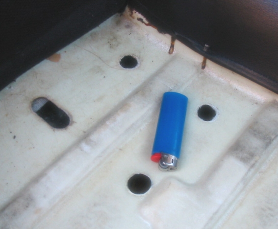

VegasRacer
post Jun 15 2005, 11:08 AM
ELVIRA
Posts: 8,933
Joined: 27-March 03
Member No.: 481
Problem solved. Thanks for the support guys.
Here is the offending object. Another DAPO problem.
Joe Bob
post Jun 15 2005, 11:09 AM
Posts: 17,427
Joined: 24-December 02
From: Boulder CO
Member No.: 5
Didya find the crack pipe?
VegasRacer
post Jun 15 2005, 11:15 AM
ELVIRA
Posts: 8,933
Joined: 27-March 03
Member No.: 481
QUOTE ("*" @ Jun 15 2005, 10:09 AM)
No, but I did find a few mouse turds.
Can ya smoke 'em?
Good shit man! (IMG:http://www.914world.com/bbs2/html/emoticons/smoke.gif)
