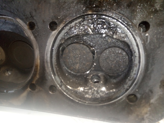

Finally got around to tearing down my 2056. Had seized on me a year ago.
As suspected, I dropped a valve on #2 intake.
Hear you can see seat material hammered into the CC. The piston is pretty borked up too. The bores look undamaged.

That can be fixed if you can find someone who will work on it... (IMG:style_emoticons/default/sad.gif)

I have used Jay's precision in the past. Think I will have him take a look.
