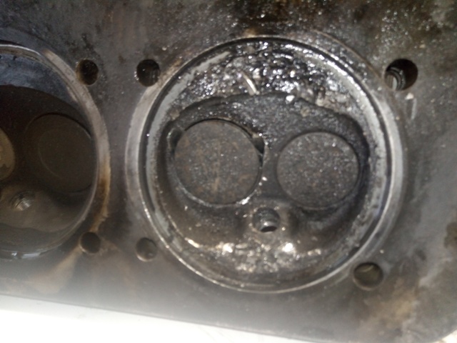

Finally got around to tearing down my 2056. Had seized on me a year ago.
As suspected, I dropped a valve on #2 intake.
Hear you can see seat material hammered into the CC. The piston is pretty borked up too. The bores look undamaged.

I have used Jay's precision in the past. Think I will have him take a look.
