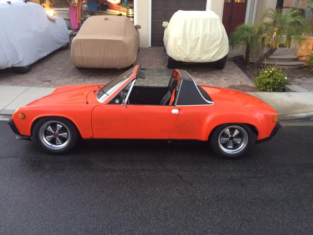

Here is the car I am starting with and I must say that Mark (the seller) has been very helpful during this transition back into 914's. The car will be getting steel flares and a 911 dash as well as a motor.
