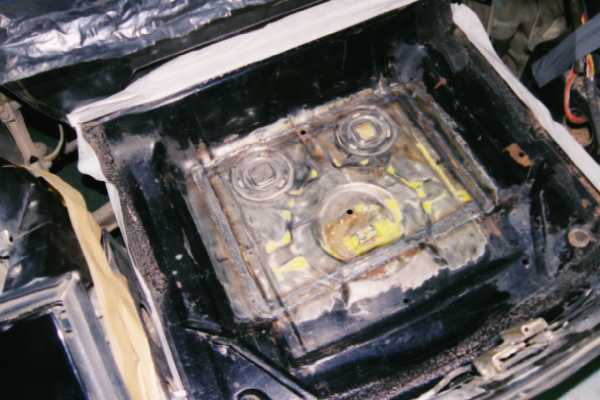

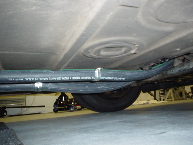

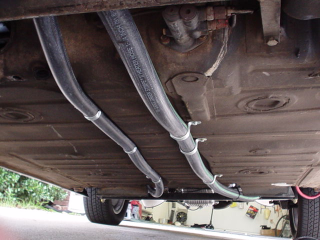

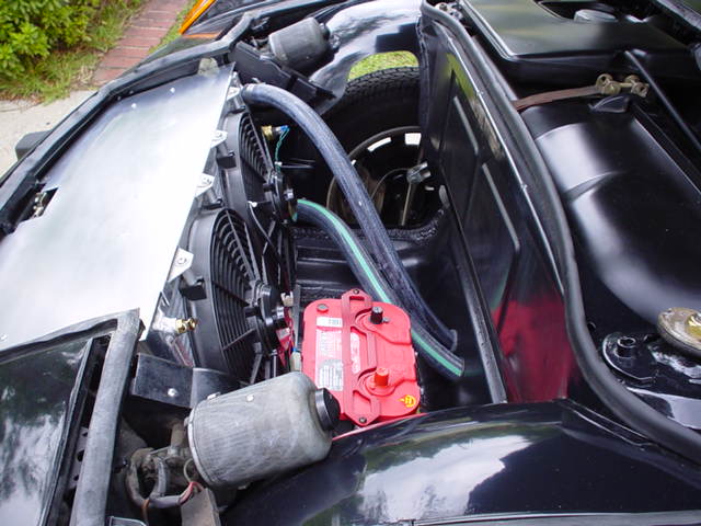

Roger,
You've got the procedure right. Here's a pic that may help. I recommend drilling a small pilot hole for each hose and checking from under the car to ensure no issues.
I cut my holes 1/4" larger that the hose used and installed a grommet to prevent chaffing.
If your using two different size hoses (I did), think about which size goes in which hole for proper routing to/from radiator.
John

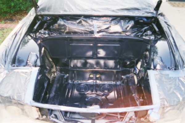

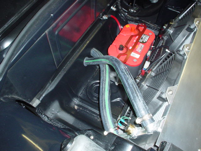

Thanks for the kudos. I made the trip to Vegas and took many pics of Scott's car which helped in just about every area of the conversion.
I picked up my grommets at Lowe's in the electrical section. Could not find the exact size I needed so ended up cutting the largest size they had, spreading the opening on the underside of hose and filling the remaining section with another piece of same size grommet.......if that made any sense.
If you've got your drivetrain installed and radiator mounted, the hose routing is about the easiest part of installation.
I'll attach a few more pics to give you some ideas. The clamps used to secure hose to chassis are also from Lowe's. If I had a nickel for every trip made there during the conversion.
John

This is my best front trunk shot. Krylon rattle can in fact......just take your time doing the prep work. It started off looking just as bad as the majority in the beginning.

Picked up a digital camera during the middle of the front trunk job and this is one of the few taken during that process. As you can see, I had to weld in a new piece to cover the hole left by dealer installed a/c.

Last one.........after about 3 weekends of sanding, having filler piece added, painting, only to have to paint again for not waiting the prescribed time before adding additional coats @#$%. Note to self: follow the instructions provided.
Hope some of these help. Keep us posted on your progress and feel free to post progress pictures. Believe me, you'll regret not taking pictures down the road.

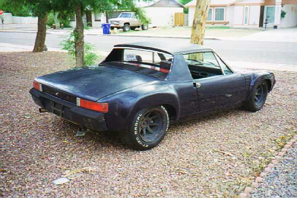

Thought that I would add my .02 with this thread after reading it all when I built my exhaust for my V8 I used a dual in dual out Flowmaster fit great behind the tranny and had to cut the heat sheild but it looked like it was soposto be there and it had the Flowmaster sound. I'd have a picture but I sold the car and am forever looking for another.
Edit Found another picture you can see the exhaust tip thats about it
