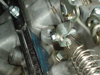

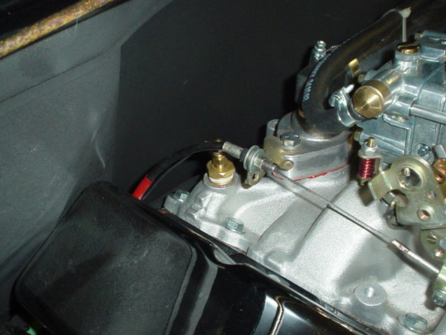

Distributor and passenger side valve cover can be pulled in some cases without actual removal of engine. For the tall valve cover on passenger side, you can remove two bolts securing transaxle to chassis and lower rear of drivetrain a couple of inches to make needed clearance. However, some tall valve covers will allow removal on passenger side without having to lower front of engine.
You could take the same approach with the distributor by removing two securing bolts for engine bar and lowering front of drivetrain. Another approach would be to remove all 4 securing bolts holding drivetrain and shifting forward 2-3"........my point here is to avoid completely pulling drivetrain if at all possible. If you can get the dist. cap on and off without disturbing anything, I would not pull dist. if you already have it running right. Note: make sure your plug wires have the 90 degree fitting on dist. end. You'll need the added clearance when closing engine lid and trunk.
While your working on the ignition fitment, have you decided what type of coil your going to use and where to mount? In my case, I purchased a coil that would only allow a vertical mounting but wanted a horizontal positioning in car. Since this was a mail order purchase, I ended up with two coils before getting it right.
Once you get your throttle connected, get someone else to push throttle to floor while you check for WOT. This ususally needs adjustment the first time and you have some adjustment of the stop under throttle pedal.
Have you lengthed your shift rod 3/4" yet? This will require some welding. Let me know if you need pics.
CV bolts need special attention as well and you should be nearing that part of installation. If you have not reviewed this potential problem area, let us know.

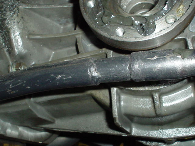

This pic should give you the location of where to insert sleeve (3/4" O.D. steel tubing). 1-1/4" is the amount you want to lengthen it.
Scribe a line at the location you want to make cut of shift rod. Cut your shift rod, insert new piece and use scribed line to line rod back up before welding.

Installed the new throttle cable minus attachment to carb.
Installed new clutch cable minus attachment to fork.
Mad the pilgrimage to "Easy" this morning and picked up some little bits.
Throttle cable screw holder thing that attaches cable to throttle linkage.
