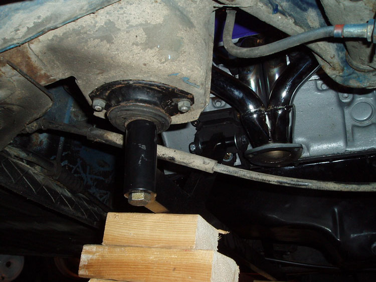

Roger,
This is the best picture I have of this area and only shows the bottom area were talking about. As previously mentioned, the motor mount "bar" is mounted solid at the outboard locations. The only place 911 sport mounts are used are in the rear to secure trans. to chassis and I believe you already have that part figured out.
If your taking pics tonight, shoot both areas to make sure were comparing apples to apples.
John

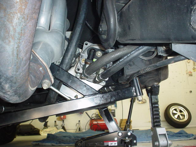

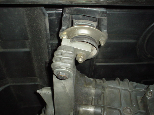

For the mounting of transaxle, this is how I mounted mine using 911 sport mounts.

Here's a little better picture of what the motor mount bar bolts to. What you can't see in this picture, because of the cable in the way, is where your bolt goes through rectangular piece.

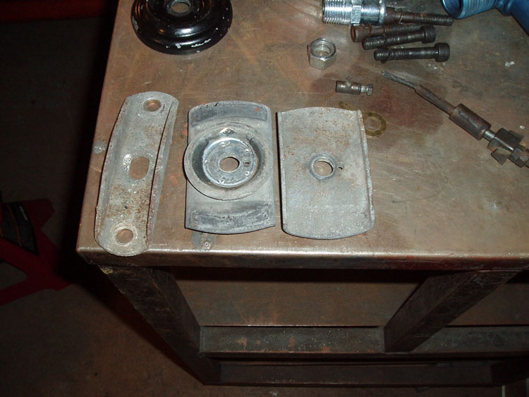

As you may have read, I got this car without engine or trans and a box of bolts. That's it. =-)))
Since i've never put one of these things together i'm having to figure out most of the assembly with the clubs members help.
This is what was included in the box...
I think maybe the pair of brackets will be OK. What do you think?

The one on the left is for the motor mount/bar and is what your bar will bolt directly to. Hopefully you have another to match.
The other two will be used in conjuntion with the 911 sport mount to secure transaxle. You'll see them at the very top of stack in the pic I attached. These could be replaced with large flat washers and only serve to prevent bolt from pulling through rubber on sport mount. You will notice the large flat mushroom shaped piece at bottom of stack. This is part of the original trans. mount and required a notch be cut to fit around trans. adaptor provided with conversion kit. This one also could be replaced with a large, thick flat washer if you don't have these available.
John

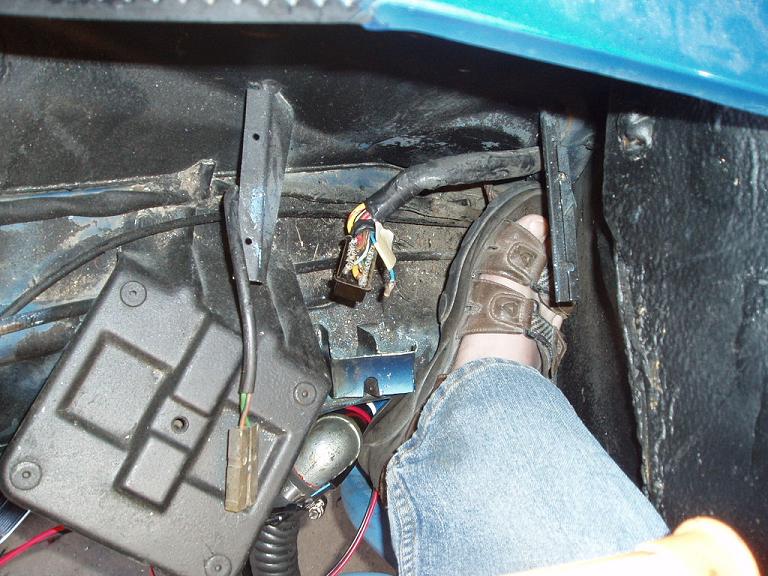

Progress!!!!
Only thing left on cooling system is to wire water pump and mount radiator. All is plumbed including burp locations.
Fuel pump is mounted and wires run to old relay board.
Need to figure out what wires leading to relay board are for. Desperately. (IMG:http://www.914world.com/bbs2/html/emoticons/unsure.gif) The plan is to NOT use the old relay board. I will do something more up to date.
I already disassembled wiring plug and labeled pin numbers. Now just need to know what they're all for.
Mandatory foot shot is included... (IMG:http://www.914world.com/bbs2/html/emoticons/biggrin.gif)

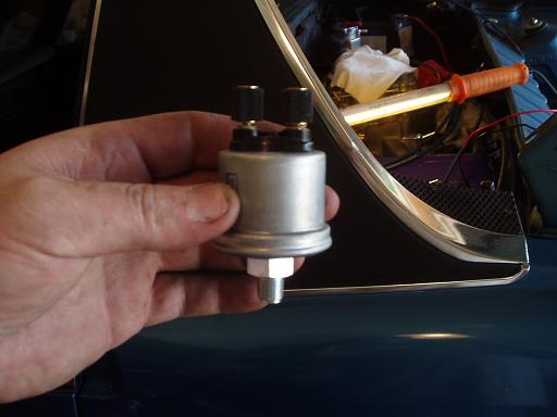

BTW, what's this sender and where does it go? (IMG:http://www.914world.com/bbs2/html/emoticons/blink.gif) (IMG:http://www.914world.com/bbs2/html/emoticons/laugh.gif)

I'm not sure if you were serious, but that sender is your oil pressure sender. If you've got a flashing oil light on the dash, you have got some wiring errors. I will see if I can track down the Renegade wiring cheat sheet if you still need it.

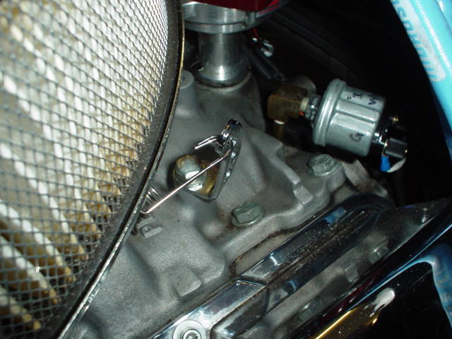

As Chris mentioned, that is your oil sender and screws into block, left side of distributor. Sender is capable of supplying signal for stock idiot light as well as optional pressure gage. There is a mark on each side of sender (i think a G and II) but can't remember off the top of my head which side is for idiot light. Normal operation of oil pressure light is to turn on "solid" with ignition switch on (engine off) and go out when engine is running with normal oil pressure, ie above 8-10 psi.
Note: you'll need a short piece of 1/8" pipe threaded brass (1-1/2"-2") and a 90 degree elbow for clearance. See attached pic.

Hey John, I looked on the Master Cyl and saw little on the side. One electric clip and that's about it. If you have a pic handy that would be great. =-))

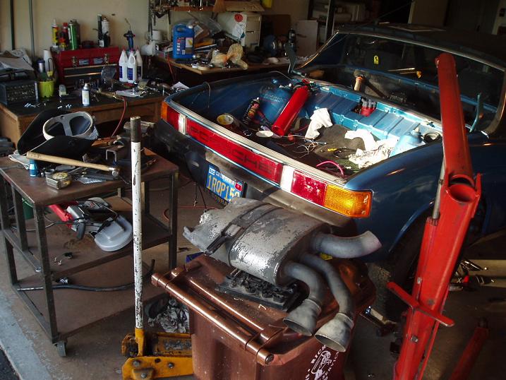

Today i'm extending the shift rod and setting up a custom gas pedal hinge.... (IMG:http://www.914world.com/bbs2/html/emoticons/biggrin.gif) ala door hinge. (no comments from the peanut gallery please.... ) (IMG:http://www.914world.com/bbs2/html/emoticons/laugh.gif)
I straightened the shift rod and it's about 1" short. I cut at the appropriate spot, welded in a 1" piece, and cannot get it in now.
So now i[m going to keep it in half and figure soem sort of disconnect device. easier for an oil change.
Chopped off a Vette muffeler and found that I can snub the end off and it will fit.....
