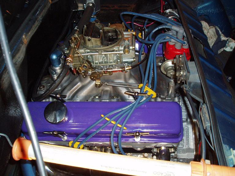

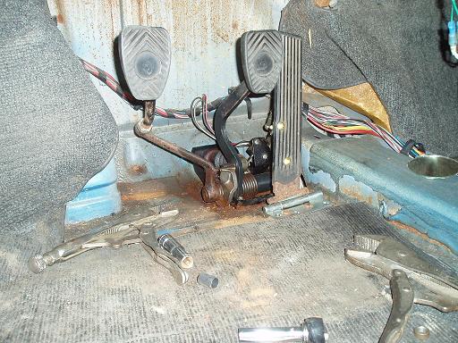

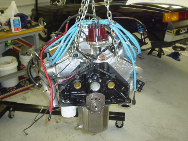

Engine DONE!
Dr. Roger
post Aug 24 2005, 10:24 PM
Post #166
A bat out of hell.
Posts: 3,944
Joined: 31-January 05
From: Hercules, California
Member No.: 3,533
Pedal fix.
Tomorrow my buddy John is dropping by to start her up and stand by with a couple of fire extinguishers.....
More to come.

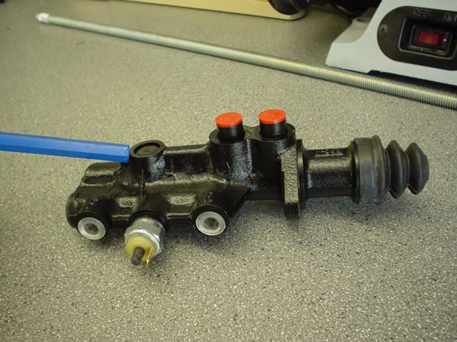

QUOTE (rogergrubb @ Aug 24 2005, 05:43 PM)
Hey John, I looked on the Master Cyl and saw little on the side.  One electric clip and that's about it.  If you have a pic handy that would be great.   =-))
Roger,
Your close. Push the black button right next to the electrical clip that you located. Note: not the one being pointed out with blue tool in attached pic.
John

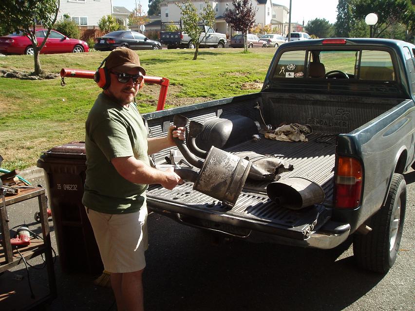

C5 'Vette muffler getting "shortened" (IMG:http://www.914world.com/bbs2/html/emoticons/biggrin.gif) so it'll actually fit.......

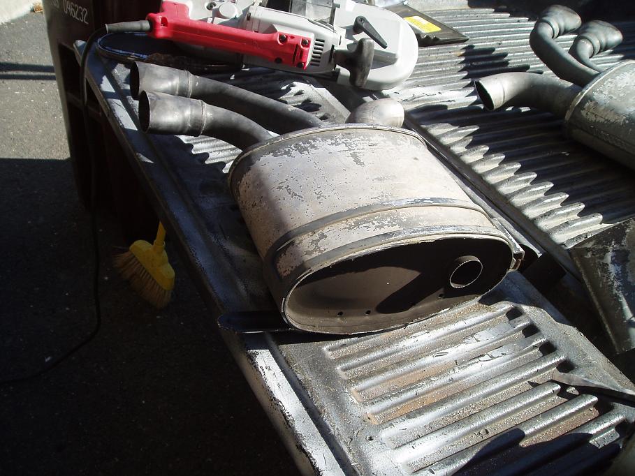

Member No.: 3,533
Vette muff before gutting a little bit.

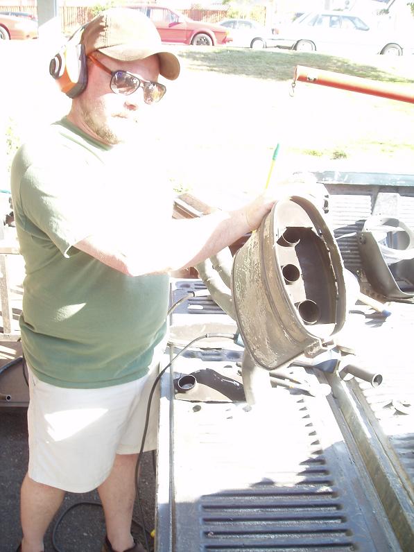

Member No.: 3,533
Getting gutted. (IMG:http://www.914world.com/bbs2/html/emoticons/laugh.gif)
For that "non-factory" sound.........

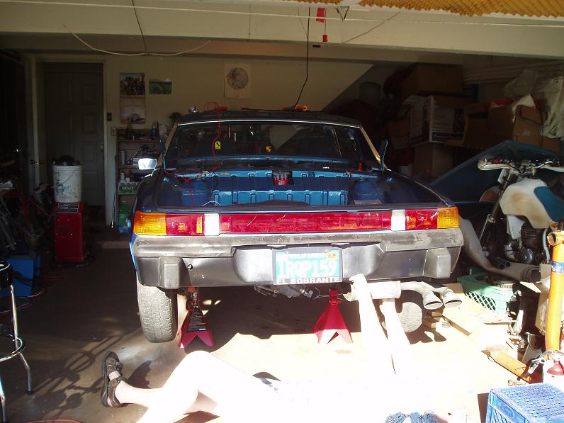

Dumping towards the outsides.
