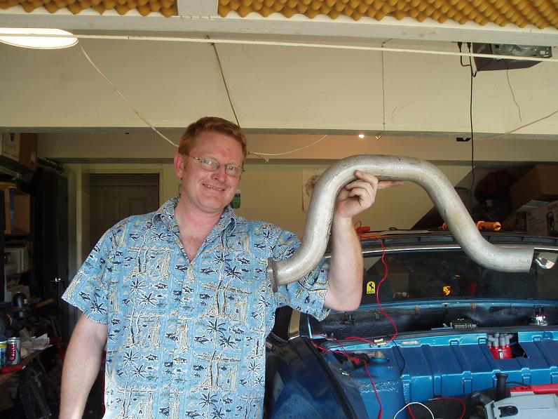

OK, my official consensus is that "I suck". My idea of using the C5 muffs was a good idea but require too much modification for my skill set.
And NO muff shop will touch them... Even after I told them I would sign a hold harmless agreement.... Whatever....
So now i'm looking at a set of Flowmaster 40's.
2 1/2" in/out. Any thoughts on them??
P/N FLO-42543
FlowMaster Muff

The flowmaster 40 sounds good outside of car but may get on your nerves due to the noise in cabin.
No mater which muffler you get, I recommend a offset inlet and outlet for ease of mounting and adjustment.

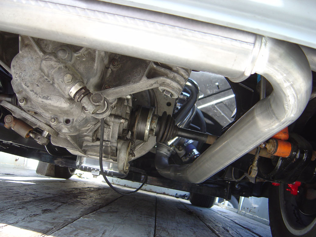

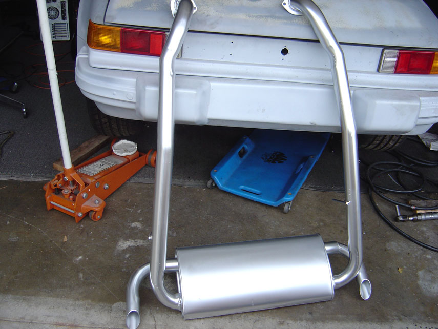

Hey Roger, I just read through your whole thread here, I will attach a picture of my muffler setup for you to look at, it is using a single dual inlet, dual outlet Walker muffler for a Camaro/Trans Am. The sound is nice, quiet on the inside and not really loud outside. Most people like the way it sounds. I know I do. Here are the pictures.

The whole system out of the car.

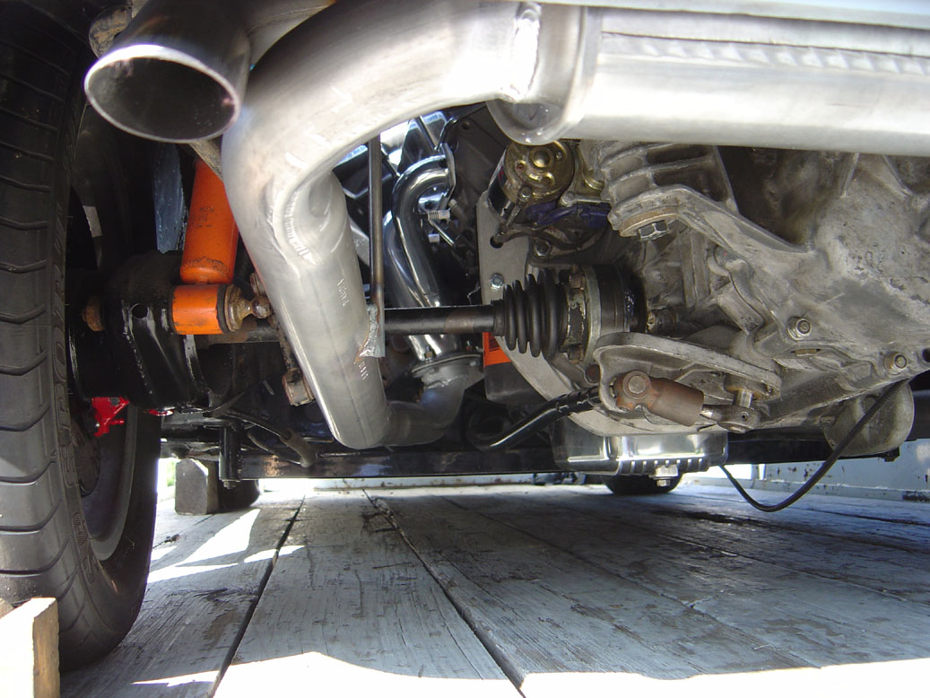

And this is what it looks like from behind

Scott,
That is exactly the muffler I am considering.....I have seen them before, but didn't know the specific application. What year(s) Camaro/Trans-Am is it form?
Looks very nice.
Andy

I think they are from 82 to 92 but I could be mistaken. I had a 93 Trans Am and it was similar so they could have been the same. I know the 80's cars used this muffler.

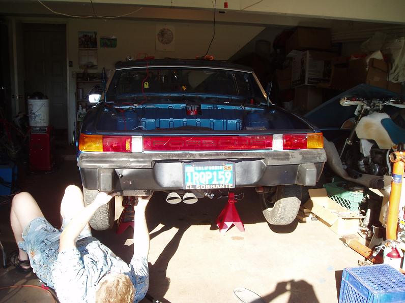

Then I go by a friend of a friends muff shop this morning as a last ditch effort and he say's no problemo' on the Vette muffs.
This mornings turned out to be a great morning!

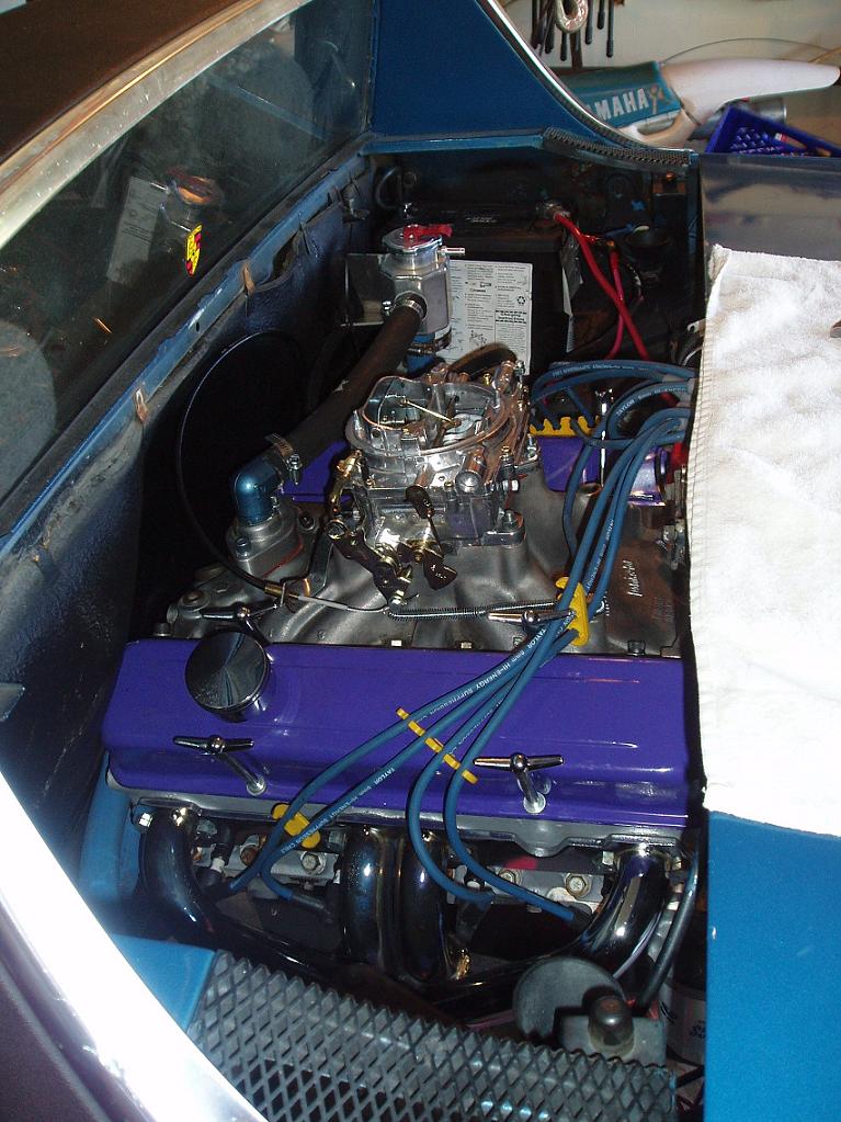

Yesterday a new Edelbrock 750 double pumper went on and got a nice tune. (Not under load yet) but it idles real SICK (good). (IMG:http://www.914world.com/bbs2/html/emoticons/laugh.gif) I love the easy access to primary air screws and the secondaries even have an easy adjustment also.

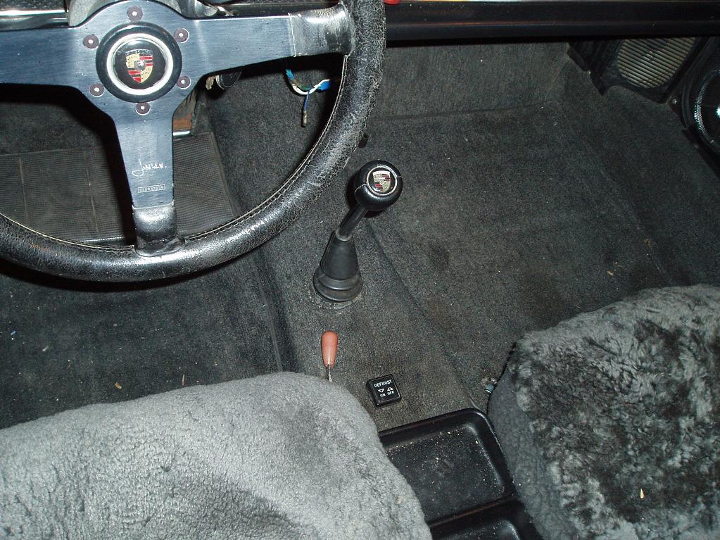

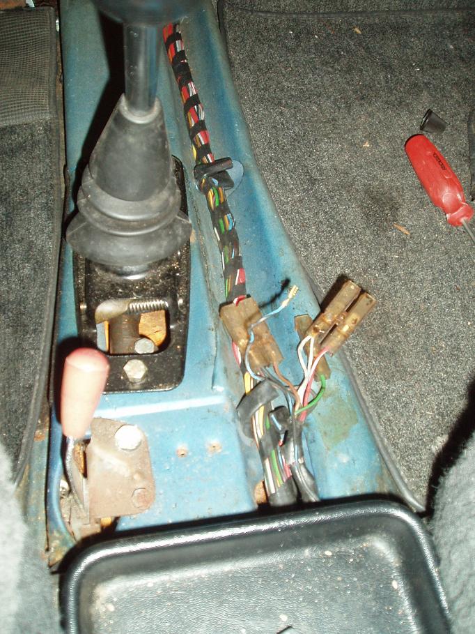

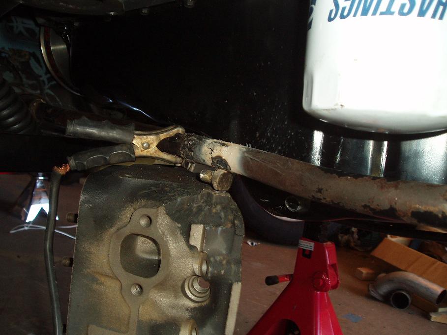

Shift rod is welded and adjusted. Sweeeeeet!
Noted 4 disconnected wires near the shift boot.
Should I be concerned?
Some before and after pics.
Thanks again Aaron. =-)

Wires disconnected.....
Wuzup wit dat?

Shifter adjusted and lookin good. Feels good. =-)
AAA picks up the car in the morning for her little journey to the muff shop.
Then it's off to the races.. so to speak.

disconnected wires are for your center console roger
