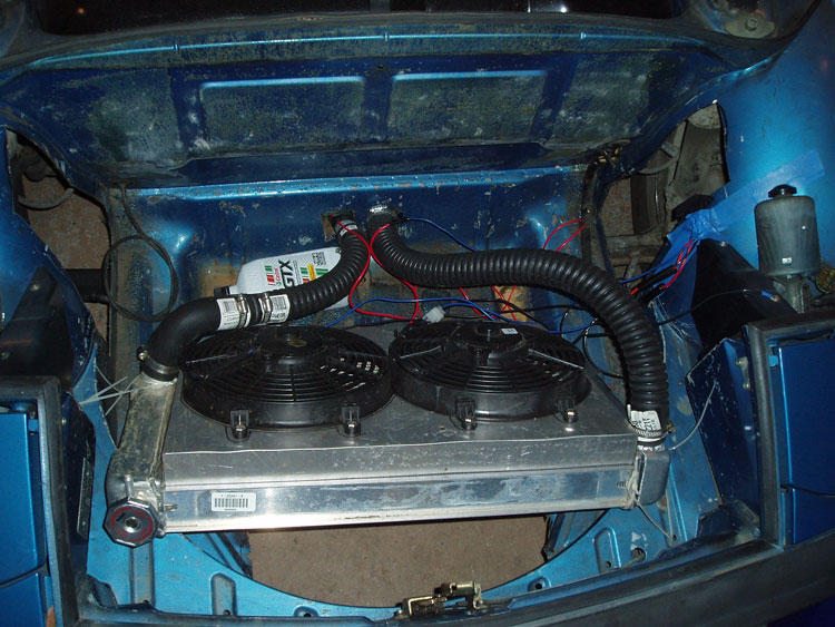

Exhaust wheel well holes big enough?
(note: only the finest zip ties were used to hold this radiator in place.)

The fans you have should work well. Your problem is that you MUST build a shroud that encloses the fresh air intake for the rad. Air will travel the path that offers the least amount of resistance. In your case the path of least resistance is over the rad. The shroud will make the air pass through the rad. I am surprised that you did not over heat sooner.
914GT
post Sep 3 2005, 09:49 AM
Post #223
Posts: 1,101
Joined: 11-October 04
From: Tucson
Member No.: 2,923
Paul is right. And at low speeds a barrier between the intake and exhaust sides of the radiator is required to prevent recirculation. What you have now lets the heated air get pulled back through the radiator and that will severely reduce the cooling efficiency.
John2kx
post Sep 3 2005, 06:29 PM
Post #224
Posts: 502
Joined: 22-August 03
From: Augusta, Ga.
Member No.: 1,066
Roger,
I see two radiator caps installed (one front and back) with no recovery/expansion tanks to collect coolant. If your running your setup as shown in pics, your sucking air back into cooling system everytime you cycle from hot to cold in addition to loosing water.
My two quart expansion tank would easily increase level by over one quart during a heat cycle in summer weather. Without the expansion tank, this coolant is being pushed overboard.
Your fender cutout size is fine.
Shroud the front of rad. as already mentioned.
Do you have a additional opening in front of car other than what you cut out in trunk floor?
One other IMPORTANT thing..........unless you crossed your radiator hoses somewhere between the front of car and water pump, your plumbed up backwards, ie sucking out the top of radiator instead of bottom.
John

John,
YOU get the grand prize for my secret mistake.... Yes the water pump is plumbed backwards..... to the radiator.
I'm going to switch the hoses up front tomorrow. (IMG:http://www.914world.com/bbs2/html/emoticons/huh.gif) (IMG:http://www.914world.com/bbs2/html/emoticons/laugh.gif) (IMG:http://www.914world.com/bbs2/html/emoticons/laugh.gif) (IMG:http://www.914world.com/bbs2/html/emoticons/laugh.gif)

Don't forget the expansion tank! With your "2" radiator cap installation, you should pick one to feed and receive from expansion tank. I recommend the higher point in your engine bay. For this to work you need to have the radiator cap in front to have a higher pressure relief or plug the overflow line. RH recommends a 16lb. cap with their cooling system. You could also go with a 20lb. cap in front and the 16lb. at your fill port and get the same results.
Connecting the radiator to pump correctly and installation of expansion tank may work without the front ducting but I doubt it. It wouldn't hurt to give it a try, just don't veer too far from home.
You could use cardboard, foam and duct tape to temporarily fab up a duct to see if the sizing and path work prior to spending several days with fiberglass.
Your system has got to be full of air given the plumbing error and lack of exp. tank. I recommend going back through the burping procedure outlined earlier to remove as much air as possible prior to hitting the road again.

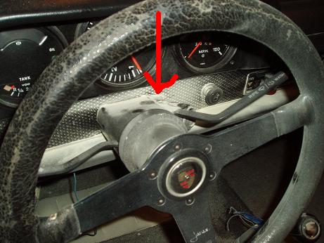

Well I must say, today was so crazy.
I had to give three friends rides and man, that was fun.... starting to push it a little harder. had another reverse lock turn. (IMG:http://www.914world.com/bbs2/html/emoticons/cool.gif) i planned it though.
took it over to visit with some friends and then it got dark.
started her and turned the lights on and nothing happened.
then i noticed no lights worked on the entire car. except the green oil light.
everything worked yesterday...
took a chance and drive it home and as i was pulling into the garage, "Poof".
a flame was seen shining through where the ignition steering column goes through the dash. See pic. and red arrow.. OH SHIT< NOt in my f-ing garage.
I gave it a blast with the extinguisher and that was that.
electrical in nature as it stunk to high heaven. whatever that smells like .

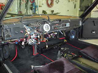

upon furthur inspection i noted that the PO had sone some custoom wiring to the stereo and left other wires just exposed under the dash...

my last day of vacation will be figuring out this wiring thing now... (IMG:http://www.914world.com/bbs2/html/emoticons/dry.gif) (IMG:http://www.914world.com/bbs2/html/emoticons/mad.gif) (IMG:http://www.914world.com/bbs2/html/emoticons/blink.gif) (IMG:http://www.914world.com/bbs2/html/emoticons/ar15.gif) (IMG:http://www.914world.com/bbs2/html/emoticons/headbang.gif) (IMG:http://www.914world.com/bbs2/html/emoticons/pissoff.gif)

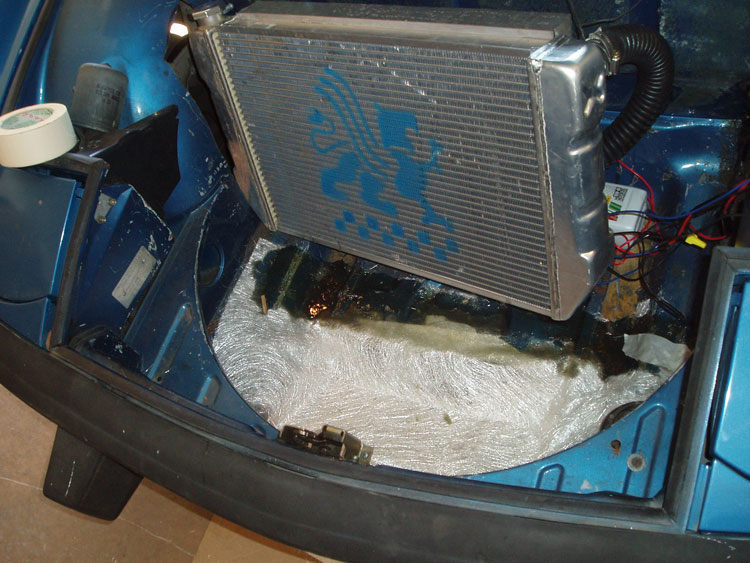

starting fiberglass air ducting.

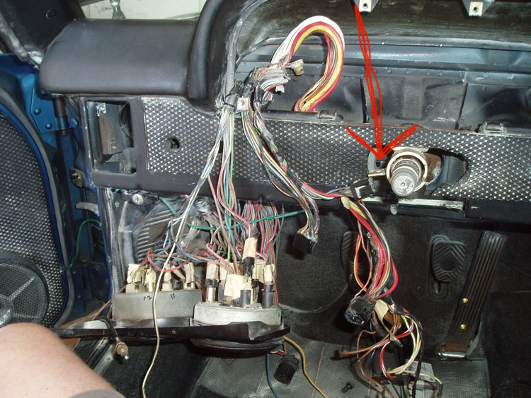

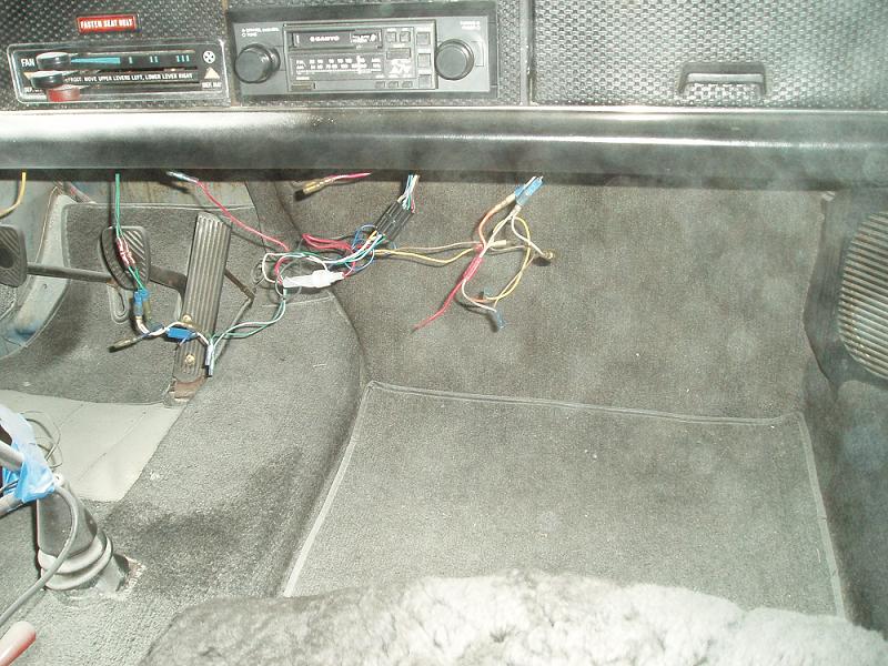

And the details of the electrical fire....
red arrow points to where the harness was cut by steel support bracket for the steering column.
aparrently shorted a non-fused wire resulting in a little fire. fire exstinguisher is always by my side....... I strongly suggest everyone do the same.

That ducting is a little low...
You might find yourself cursing every time you go over a bump..
I guess we'll see it tomorrow!!

yea, i figure it's easier to take some off than add... bebe is still down with wiring issue so you'll see her next time. sorry. (IMG:http://www.914world.com/bbs2/html/emoticons/biggrin.gif)

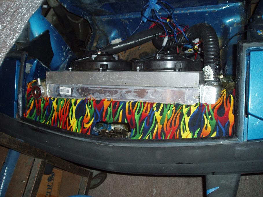

I was so inspired by the electrical fire, that I had to add some flames to the car. I don't know if it looks good or bad but it's better than the plain fiberglass that was going to go on there. =-)
No more blow-by or recirculating air. (IMG:http://www.914world.com/bbs2/html/emoticons/boldblue.gif) (IMG:http://www.914world.com/bbs2/html/emoticons/clap.gif)
