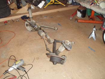

u want pics... yea', i know.... so here ya' go.
this ones of the old suspension. in great shape BTW... new bearings and ball joints feel right on the money. FSBO. anyone need one?

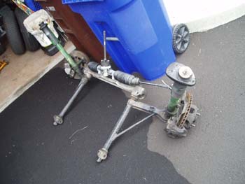

5 bolt w/newer rack and pinion and fresh rotors and pads.

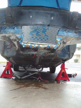

coolant lines dropped and suspension off

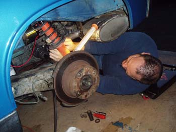

mikey workin' his magic.
work it, work it, work it. (IMG:http://www.914world.com/bbs2/html/emoticons/wink.gif)

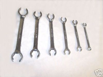

Hey Roger...thanks for dinner and the grease under my fingernails, hahahha
make sure you buy the correct brake line wrenches (IMG:http://www.914world.com/bbs2/html/emoticons/smile.gif)

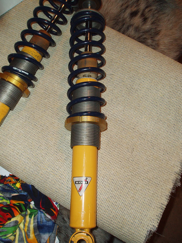

I scored some Koni adjustables w/Coleman perch's and 140# Hypercoils. May need to go up on the spring rates later but until then.... also picked up the Sheridan rear flares today. they're so dang light!!!! the lady at greyhound asked me if i wold pick them up because they looked so big and heavy. i reached over and picked them up together with two fingers. (IMG:http://www.914world.com/bbs2/html/emoticons/biggrin.gif)
this thing is going to be so bitchin'....
also going to pickup new CV boots for the 930 axles and expect the axle adaptors tomorrow or the day after.

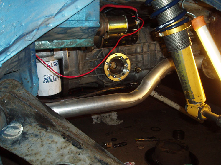

the entire rear drivetrain assembly is now going to be a fresh flipped H gear 901, going into Patrick Motorsport axle adaptors, to 930 axles, CV's, and stubs, thru 914 swing arms, 5 bolt hubs, thru 911 vented/cross drilled/milled rotors, and "spaced" 914 calipers to retain the emergency brake.
just waiting on the PMS adaptors and bearings to put it all together!!!! Yea' baby!!! (IMG:http://www.914world.com/bbs2/html/emoticons/boldblue.gif)

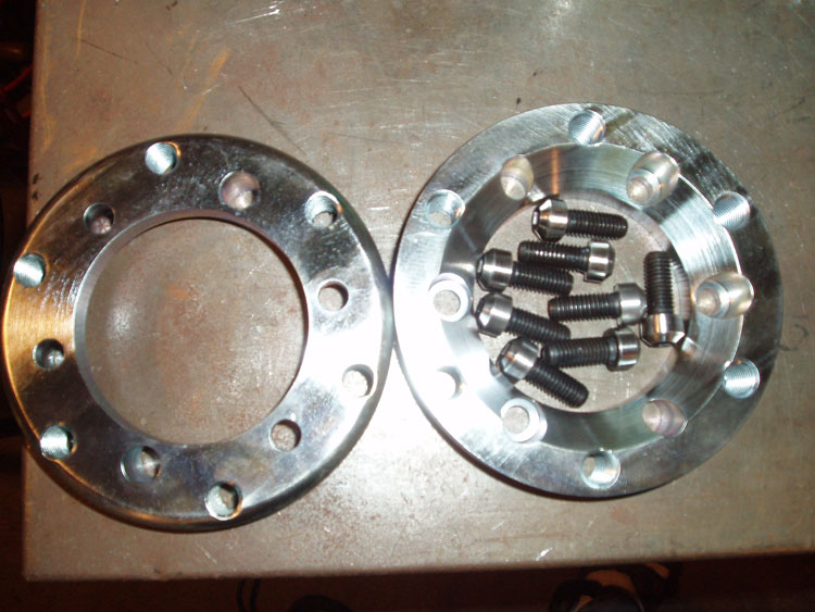

more progress.
CV adaptors.

Member No.: 3,533
adaptors installed with threadlock.

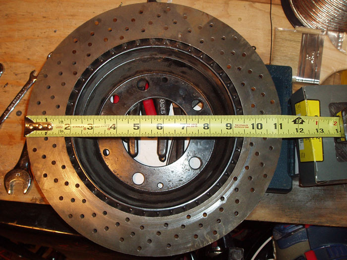

Member No.: 3,533
this rotor, part#901.352.041.14, needs to me machined down to 11.25" across to clear the spaced 914 calipers. 11.20" would be even better. =-)

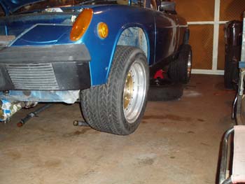

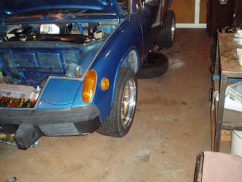

Member No.: 3,533

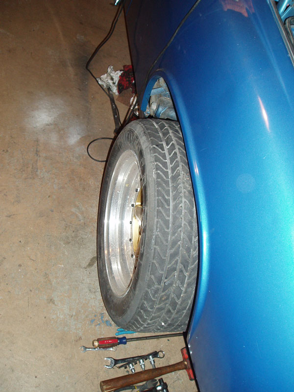

(IMG:http://www.914world.com/bbs2/html/emoticons/laugh.gif) tire and wheel temporarily installed.
maybe just roll the fenders??? (IMG:http://www.914world.com/bbs2/html/emoticons/wink.gif) NOT! (IMG:http://www.914world.com/bbs2/html/emoticons/laugh.gif)
