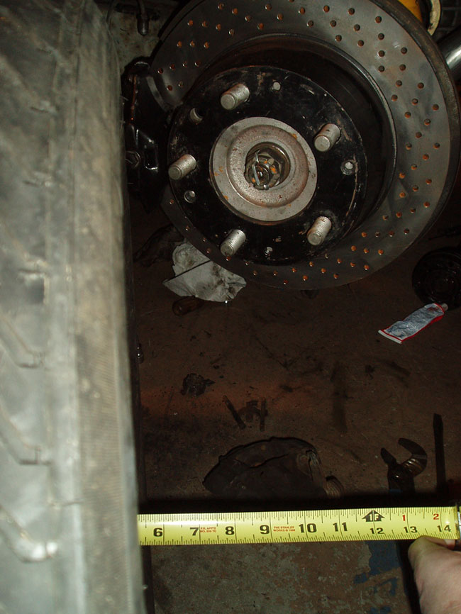

a few people were asking about width and back spacing.
the tires measure 10.5 inches sidewall to sidewall.
backspacing is 5.5 inches.
they protrude a lot and will require a 2" to 3" flared fender. no spacers.

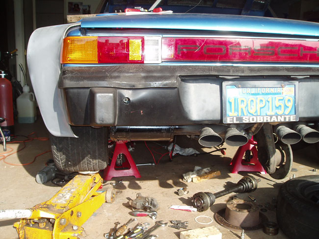

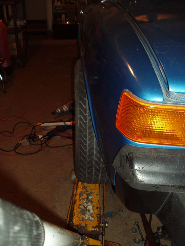

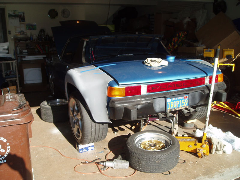

geeez,
taped on the sheridan flares and they stick out furthur than i expected. dunno if i want to space the wheels to meet the fenders or chop the fenders to meet the tires (mostly because i've never chopped FG fenders to mate with steel stock fenders).
now i'm thinking of not using the flares and just doing a little surgery on the stock fenders.
to cut or not to cut? that is the question...

Roger, if you wanna do a panel beating tech session I can host it at the shop and lend what knowledge I gained doing Felix's flares. Flaring your steel wouldn't take much. (IMG:http://www.914world.com/bbs2/html/emoticons/wink.gif)

From your last picture I would say the Sheridan flairs are overkill. But if needed, I have (4) each 2” wheel spacers you can have. What size (width) tires are you using? It’s hard to tell from the pictures.
Mark

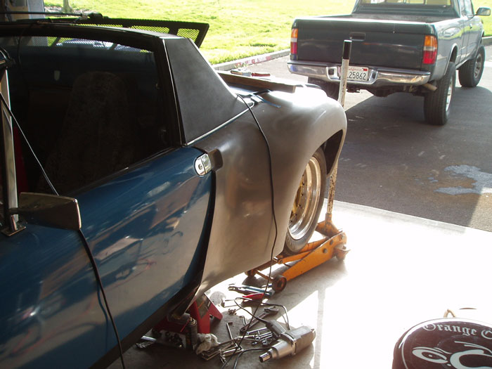

Geeeeeez, I guess I should check my progress thread every once in a while. (IMG:http://www.914world.com/bbs2/html/emoticons/laugh.gif)
Mark, that is a very gracious offer. I will give it some serious thought while i'm finishing up the rear suspension/brakes and get back to you.
Is the "proper" way to beat it out and maintain the lip or trim the lip off?
I was atctually thinking of using my angle grinder to cut off the lip of the fenders using a thin cutting wheel, then beat out the fender, then welding the lip back on to keep the stock lipped look. =-)
What are your thought on that?
AND "reedhmb" the other Mark...
I will measure what the spacing is with whees on and fenders temporarily attached and if the spacers are close i'll take you up on that. (IMG:http://www.914world.com/bbs2/html/emoticons/smilie_pokal.gif)

Yeah dood... slicing the lip first and putting it back looks best.

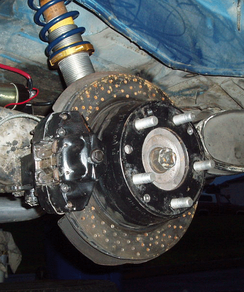

Alas! One new rear corner is complete.
914 caliper with spacer and E brake.
911 vented/drilled rotor, milled/diameter to fit within caliper.
914 pads.
911 brake pad pins, clips, and springs.
Washer/spacers to bring caliper inward "just a little bit".
911 hub and stub.
Turbo carrera axle, CV, and adaptor.
Calipers E brake is adjusted.
SWEET!

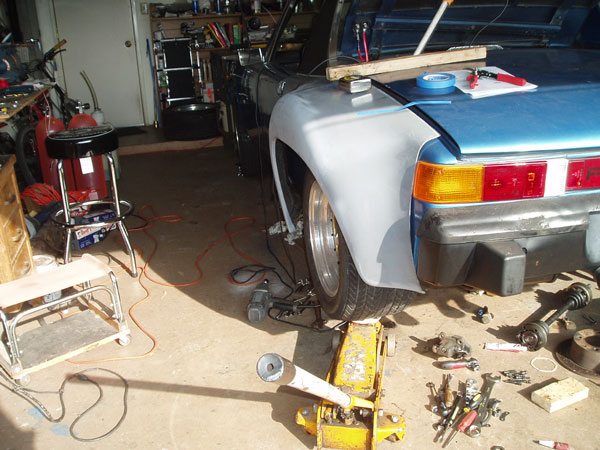

Well I measured the Sheridan fenders for spacers. Looks like 3 1/2" is needed. That would give me about 3/4" to play with.
3 1/2" is a little too big for my comfort so I think i'm going to go the steel fender flaring route. Save the Sheridans for when this car gets turned to a 100% sick street car.

run some 11" rims with a different offset... (IMG:http://www.914world.com/bbs2/html/emoticons/biggrin.gif) and some fat ass tyres (IMG:http://www.914world.com/bbs2/html/emoticons/rocking nana.gif)

Too wide or not too wide?
That is the question.
