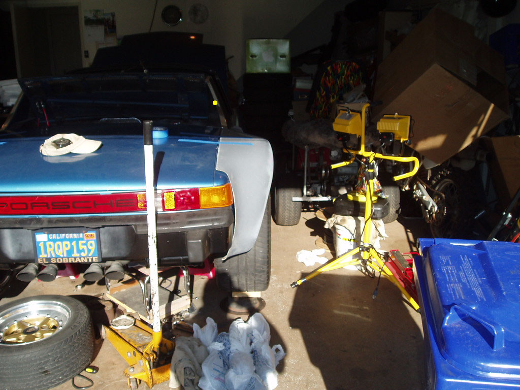

btw, you'll need a 1in spacer to bolt em up..( maybe even a 1.5, dont know that offset..)
add that to your 3.5...
Cut your flares, just cut them on the back about 2 inches. cut the tops of the flares at a taper towards the top front, see if thats enough.. If not, do another inch. , secton out the 2 inches that you cut, and on the inside and outside of the pannel fiberglass it back..
get the look you want without having to kill them bearings..

Andy, so your suggesting that I dont space-out the wheels to the fender?
rather, space the wheels just enough to fit the arms, and bring the fenders IN to the wheels?
this idea sounds much better as I don't want to over stress the bearings and it does look a bit WIDE. (IMG:http://www.914world.com/bbs2/html/emoticons/biggrin.gif)

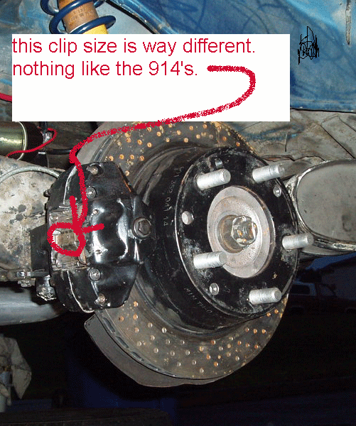

914 caliper with spacer and E brake.
911 vented/drilled rotor, milled/diameter to fit within caliper.
914 pads.
911 brake pad pins, clips, and springs.
Washer/spacers to bring caliper inward "just a little bit".
Are those 914/6 rear calipers????

technically speaking thay are not 914-6 calipers.
they are spaced 914 calipers with 911 rotors. Which are similar to a 914-6 setup.
"pro's":
i get to keep the E brake and there is MUCH more thermal reserve to the rear braking system.
John
post Feb 23 2006, 11:01 AM
Post #310
member? what's a member?
Posts: 3,393
Joined: 30-January 04
From: Evansville, IN (SIRPCA)
Member No.: 1,615
"pro's":
They take 914/4 rear pads? The pads look bigger to me for some reason. They almost look like front 914/4 pads (which would make them 914/6 calipers that have been spaced for vented rotors)
914/6 cars had solid rear rotors but larger pads (same as 914/4 front pads).
I'm just wondering which pads fit your calipers in the rear.

the pads you see in the new spaced calipers are 914-4 rear pads.
madder of fact i'm temporarily using the old 914-4 rear pads out of the old calipers. (IMG:http://www.914world.com/bbs2/html/emoticons/wink.gif)

Yes, Yes... and
yes...
You want almost 5inches of spacer on that thing?
No...
But you do want it to be really darn close to the lip so the tires look bigger.. and fill out the flares.
actually, take a tape measurer and measure the distance between your hub and the wheel mount (were the wheel would sit on the hub) with the wheel as close to the inside edge of the fender as possible.
Thats how much spacers you need.
I'll be running 2 1/4 on the back. and I think thats streching it.
Making the flares to fit would allow you to get it as close as possible to the inside edge of the fender.
Thanks
(IMG:http://www.914world.com/bbs2/html/emoticons/idea.gif) (IMG:http://www.914world.com/bbs2/html/emoticons/idea.gif)
Got me thinking about this again. I need to turn the rear rotors down to 11.2" OD, space out the calipers, spacer between caliper and mount ear, 911 rear spreader and pins...
If you don't mind, which 911 rear spreaders and pins? Thanks a bunch. (I know how to get longer bolts)

actually i'm pretty sure the 911 caliper spacers are incompatible. I'm only guessing as i've heard no one talking about doing that.
the ones on my calipers are custom made.
the pins, clips,springs are from a 911.
914's need a wide entry hole on the caliper and a narrow hole at the tip of the pin. 911 pins vary.
there is a guy who made custom pins for spaced 914 calipers. he details the thickness's at the ends and the center.
The easiest way to find which ones work is to find your favorite Porsche dismantler and go through their pile 'o calipers.... I would have except for a fine member/non-member of 914world.com offered to send me his, FREE! =-) WITH springs/clips.

Roger,
I am mainly interested in the Pad Pins, the springs and the clips.
The spacers I have under control.
I can get the calipers wide enough and centered on the rotor. I can turn pins to whatever shape is required, the clips should be able to be stock 914/4 clips. Inserted in holes in fabricated pins.
The spreader springs are my primary hangup. I don't think they would retract correctly if I didn't use any. I suppose they could be frankensteined from 911 parts and 914 parts.
I believe the pin spacing between 911 rear and 914/4 rear calipers is different.

springs and clips are different. big time. much wider due to the wider rotor. (IMG:http://www.914world.com/bbs2/html/emoticons/wink.gif)

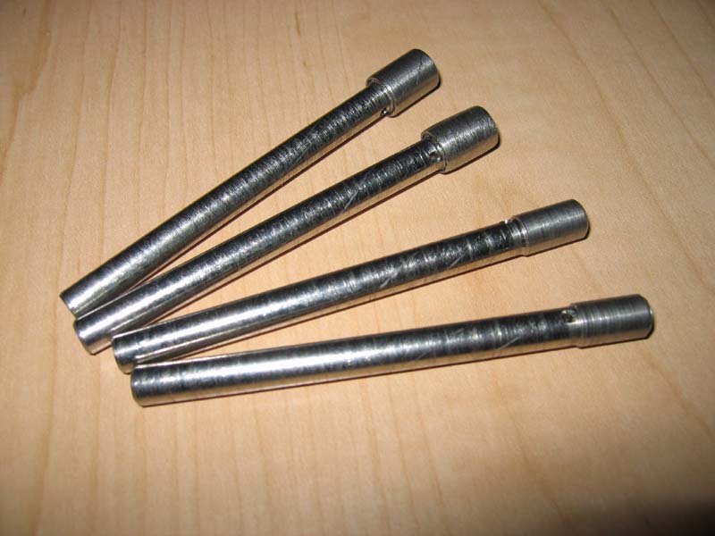

Pins are custom. Springs are too.
Springs are simple. Use the 911 spreader and the 914 wings that go under the pins. They're riveted from the factory so just drill them out and POP rivet in the new ones.
Pins need to be machined. I have sets available that we use in our v-caliper kits.

Here's the pins.
We machined off the 'humps' because none of the rear pads come with the larger hole in one side anymore. You can still see the butt is wider on that pin though.
