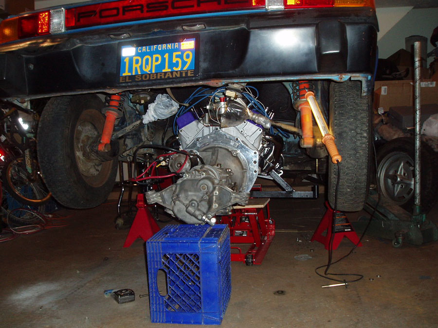

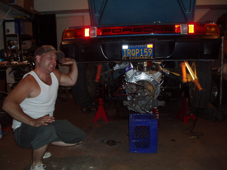

Engine went in.
Engine came out. Front clearance. Had to trim lip that protrudes at the level of the water inlets. Quick job with a 6" angle grinder and a cutting wheel. =-)
Today I run all water lines off the engine, figure out any wiring that should be connected before engine goes in again, and charging wires.
After that, it's fuel, shifting, throttle systems.... and after that it's......... Drive it!!!!!!! (IMG:http://www.914world.com/bbs2/html/emoticons/huh.gif) (IMG:http://www.914world.com/bbs2/html/emoticons/smilie_pokal.gif) (IMG:http://www.914world.com/bbs2/html/emoticons/cool.gif) (IMG:http://www.914world.com/bbs2/html/emoticons/rolleyes.gif) (IMG:http://www.914world.com/bbs2/html/emoticons/ohmy.gif) (IMG:http://www.914world.com/bbs2/html/emoticons/wink.gif) (IMG:http://www.914world.com/bbs2/html/emoticons/smile.gif) (IMG:http://www.914world.com/bbs2/html/emoticons/biggrin.gif) (IMG:http://www.914world.com/bbs2/html/emoticons/mueba.gif) (IMG:http://www.914world.com/bbs2/html/emoticons/aktion035.gif) (IMG:http://www.914world.com/bbs2/html/emoticons/happy11.gif) (IMG:http://www.914world.com/bbs2/html/emoticons/beerchug.gif) (IMG:http://www.914world.com/bbs2/html/emoticons/driving.gif) (IMG:http://www.914world.com/bbs2/html/emoticons/driving.gif) (IMG:http://www.914world.com/bbs2/html/emoticons/driving.gif) (IMG:http://www.914world.com/bbs2/html/emoticons/driving.gif) (IMG:http://www.914world.com/bbs2/html/emoticons/driving.gif) (IMG:http://www.914world.com/bbs2/html/emoticons/driving.gif) (IMG:http://www.914world.com/bbs2/html/emoticons/driving.gif) (IMG:http://www.914world.com/bbs2/html/emoticons/driving.gif) (IMG:http://www.914world.com/bbs2/html/emoticons/driving.gif) (IMG:http://www.914world.com/bbs2/html/emoticons/rocking nana.gif)
A few pics.
My buddy Mikey is the bald dude. I suggest that anyone doing this get a friend. If for nothing else, moral support. This is not easy.

Roger,
A couple of us here in Ga. were wondering how it was going. Glad to see your making progress. The R&R gets easier each time.
Removing the rear wheels/tires and using a furniture dolly would really cut your install time down as it provides more room and easier movement of drivetrain as it mates with chassis. I've done it that way by myself several times.

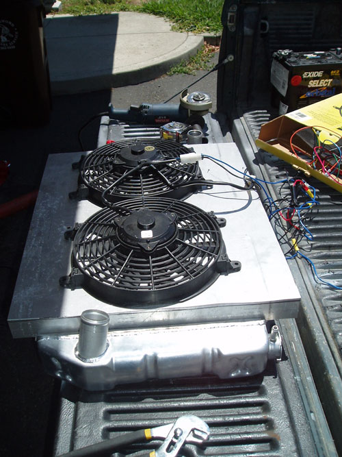

Good progress the last few days.
Got the engine in. Then out. then made some "clearance" adjustments... =-) Now ready to go back in.
Figured out some electronic stuff. Running wires and starter, water pump, alternator, ... ignition. Nothing very important.

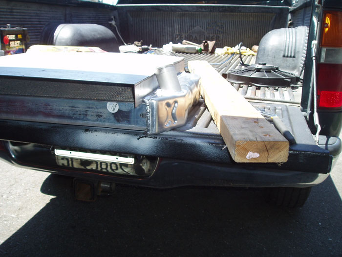

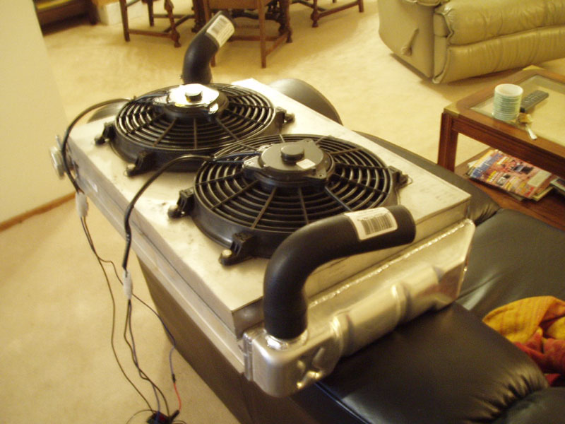

Then fabricated the fan shroud out of stainless steel. Came out pretty good considering I've never done this kind of thing before. Just watched the fellas' at the OCC. LOL (IMG:http://www.914world.com/bbs2/html/emoticons/laugh.gif) (IMG:http://www.914world.com/bbs2/html/emoticons/cool.gif) (IMG:http://www.914world.com/bbs2/html/emoticons/biggrin.gif)
This post has been edited by rogergrubb: Jul 20 2005, 11:20 PM

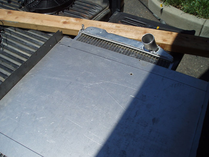

Tracing for the openings.

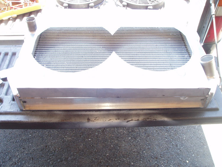

Finished product. Whoooo hooooo!
Check that off the list.

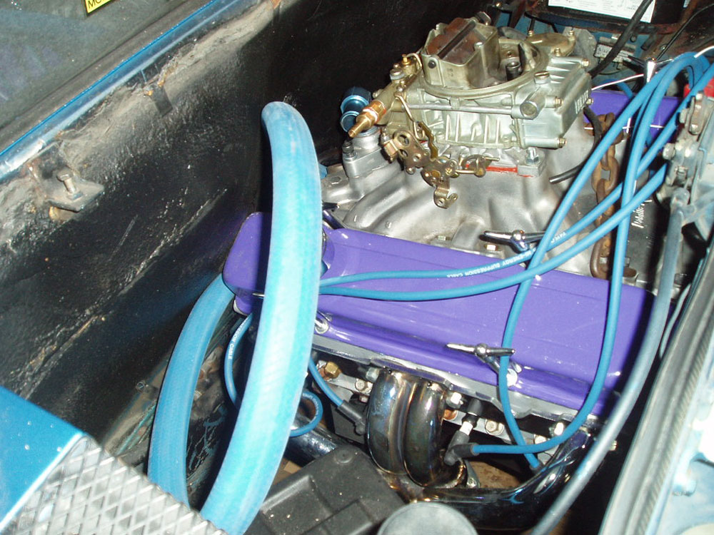

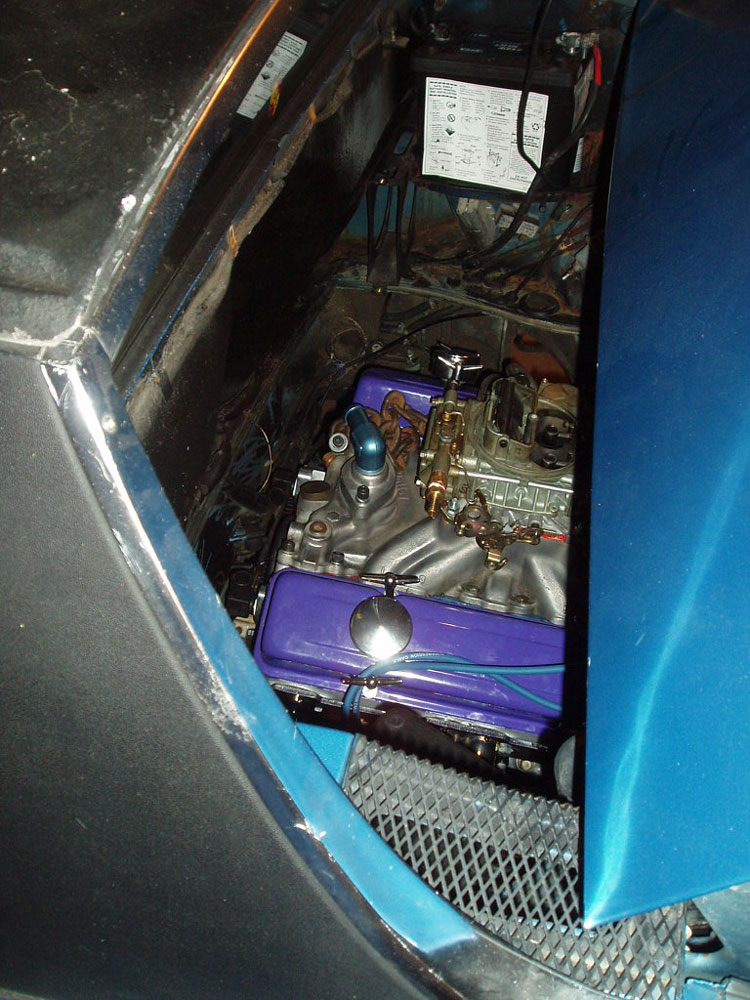

Now it's in.
We'll see how long that lasts..... (IMG:http://www.914world.com/bbs2/html/emoticons/smile.gif)

Congradulations!!!! It looks like that carb just might fit under engine lid too.
John
