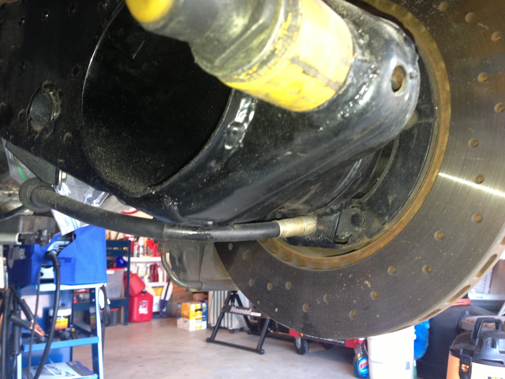

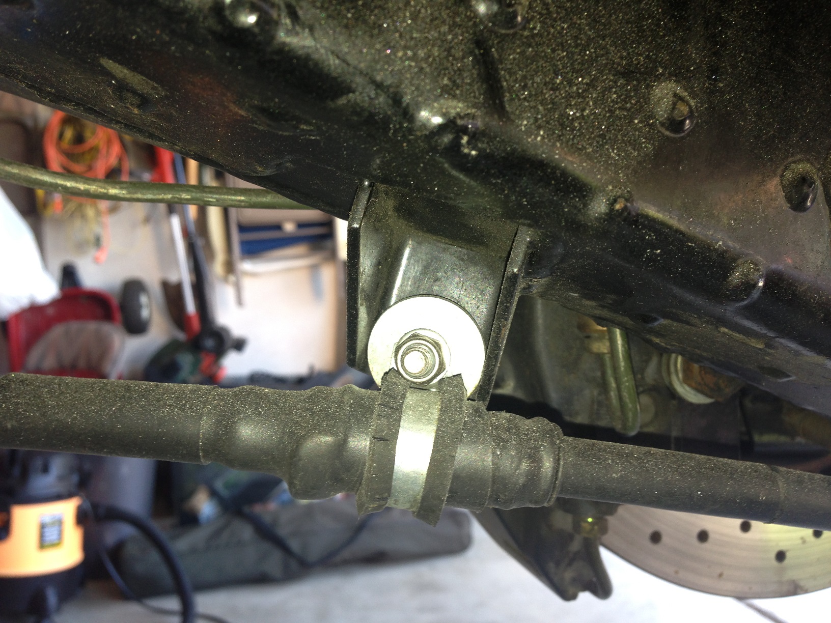

From my build thread, I created a crankarm, welded a pivot and slightly relocated the parking brake cable bracket so the standard cables could be utilized. Been on for 10 years and work great.
(IMG:http://www.914world.com/bbs2/uploads_offsite/farm5.static.flickr.com-9101-1280710809.1.jpg)

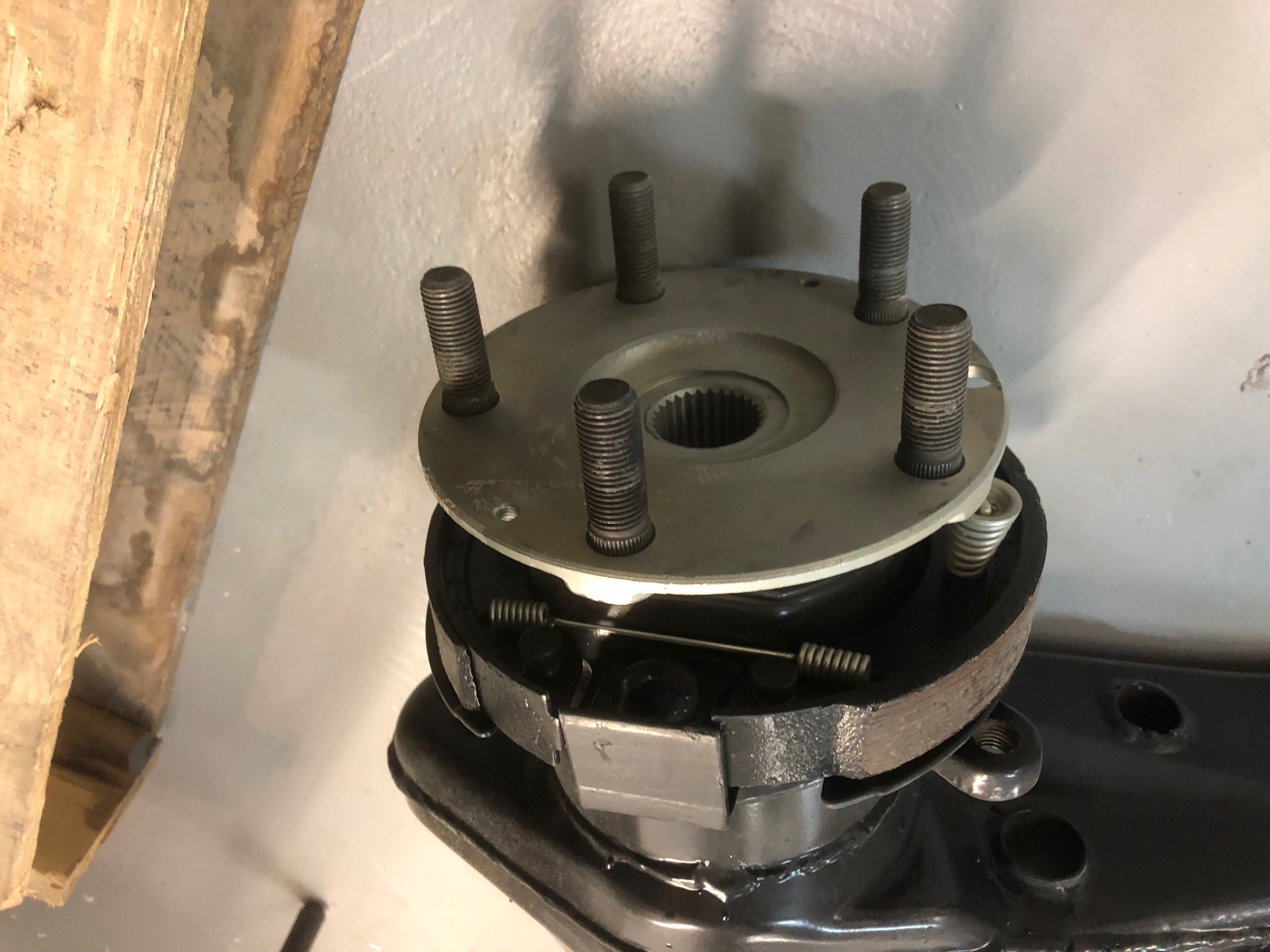

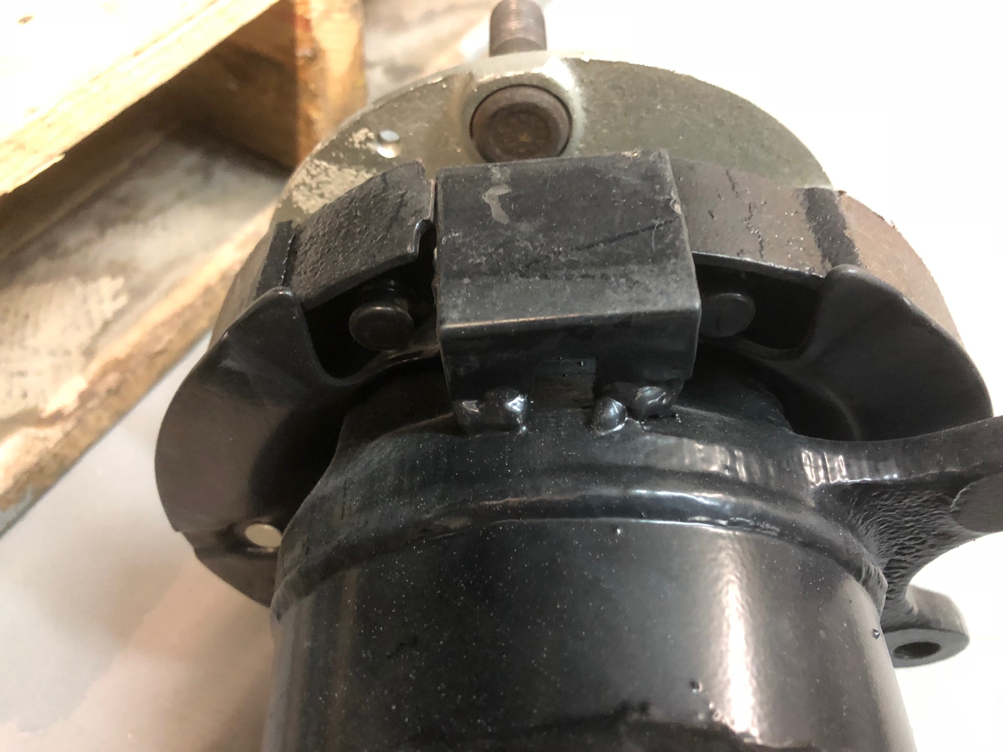

The biggest hassle is welding the angle iron parking brake stop to the trailing arm. After that it’s just grinding down the sides for the 911 parking brake assembly to slide over. On my car I just modified two 914 clutch cables for the e-brake cables, but that was before Tangerine made adapters. Others have welded a stop to the shoe assembly, but that will not hold up during an emergency stop. It will work fine as a parking brake. Compare the 911 trailing arm, it has a beefy stop, so you can apply the emergency brake at speed and not have to worry about the shoe assembly braking loose.

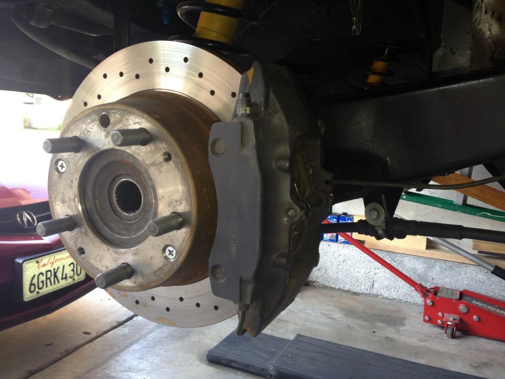

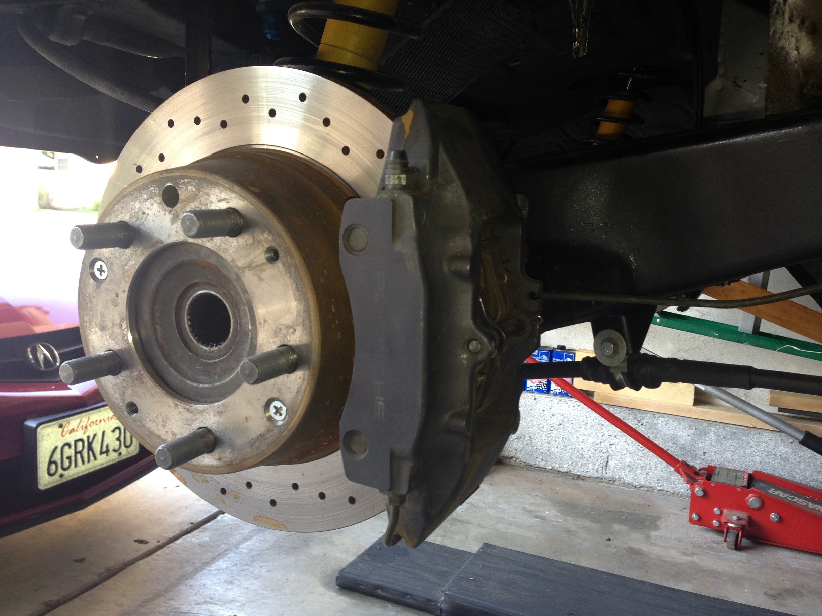

I’m running Boxster calipers front and rear on my car.

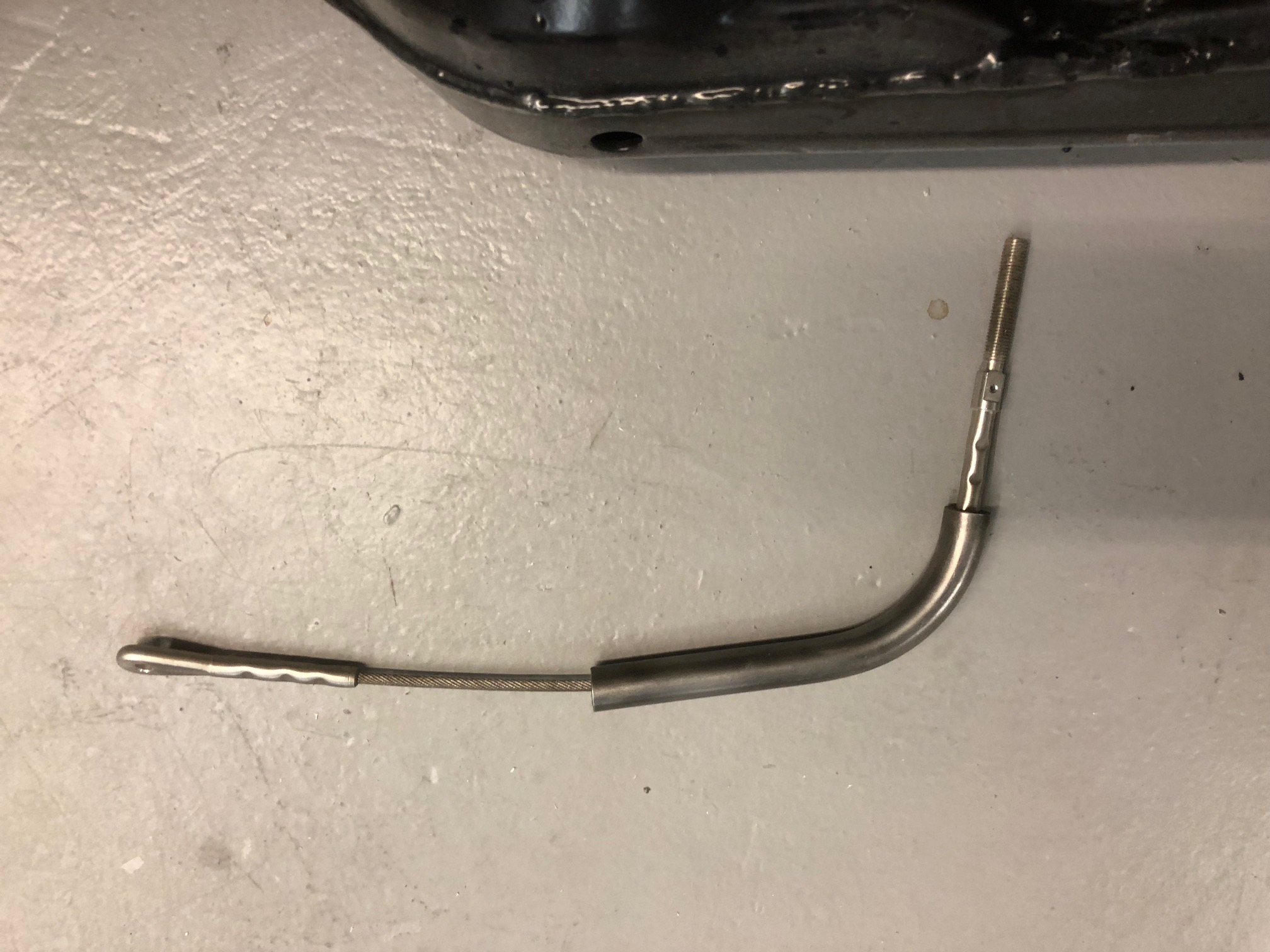

I can recommend the Tangerine racing set up with the swaged ends. You can use standard cables, you need some spacers made up to set up the align the shoes correctly with the inner hub - and mostly welding.

My set-up done by PO has no stops for the shoes,they make a hell of a mess when they fail,no strength in the backing plates only....ask me how I know (IMG:style_emoticons/default/sad.gif) ,I plan to weld something really solid to replicate whats on the 911 trailing arm.
The placement of these stops is important so the shoes are centered correctly.
My cables go through the trailing arms and and I have curved tubes to guide the cable ends,this system works well pity the PO didn't understand the meaning of emergency brake (IMG:style_emoticons/default/headbang.gif) .

From: Rescue, Virginia
Member No.: 10,318
I'd take a hard look at using the Wilwood spot caliper for a parking brake...
https://www.wilwood.com/calipers/CaliperLis...ame=Mech%20Spot
Inexpensive, simple and light weight....
