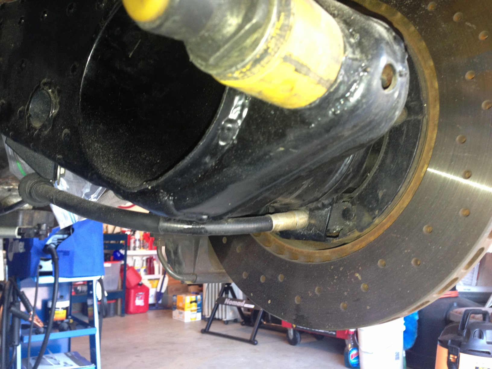

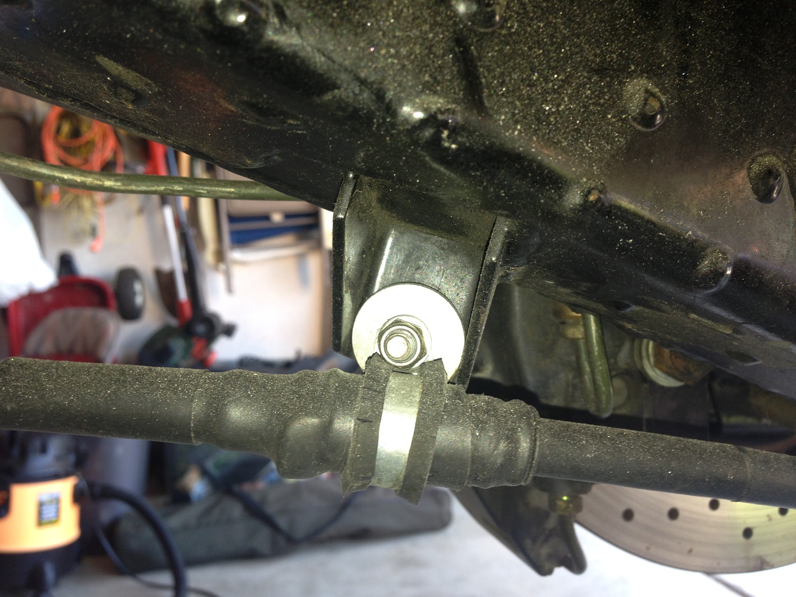

From my build thread, I created a crankarm, welded a pivot and slightly relocated the parking brake cable bracket so the standard cables could be utilized. Been on for 10 years and work great.

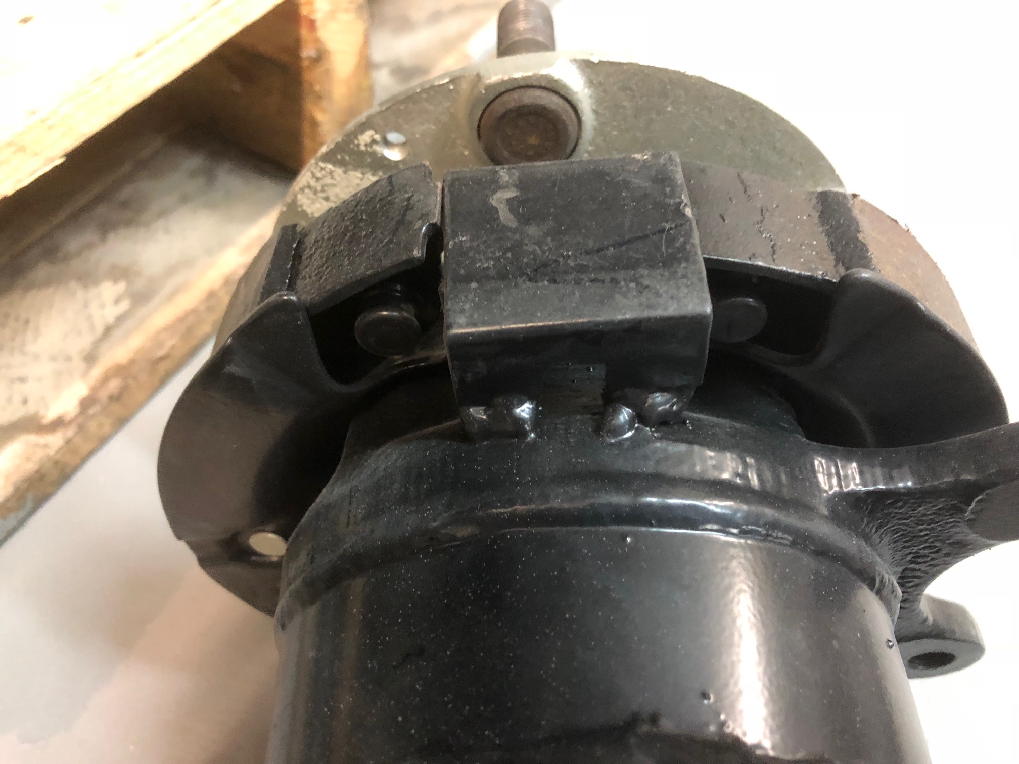

The biggest hassle is welding the angle iron parking brake stop to the trailing arm. After that it’s just grinding down the sides for the 911 parking brake assembly to slide over. On my car I just modified two 914 clutch cables for the e-brake cables, but that was before Tangerine made adapters. Others have welded a stop to the shoe assembly, but that will not hold up during an emergency stop. It will work fine as a parking brake. Compare the 911 trailing arm, it has a beefy stop, so you can apply the emergency brake at speed and not have to worry about the shoe assembly braking loose.

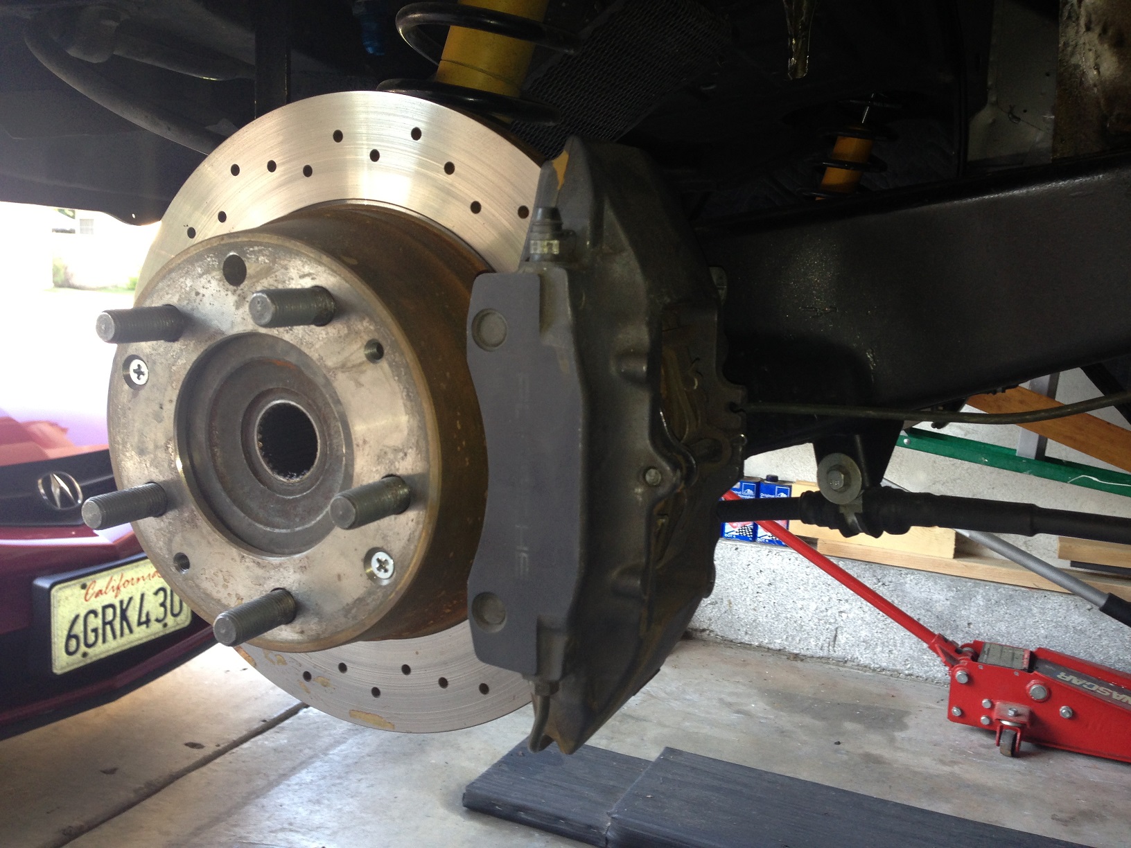

I’m running Boxster calipers front and rear on my car.

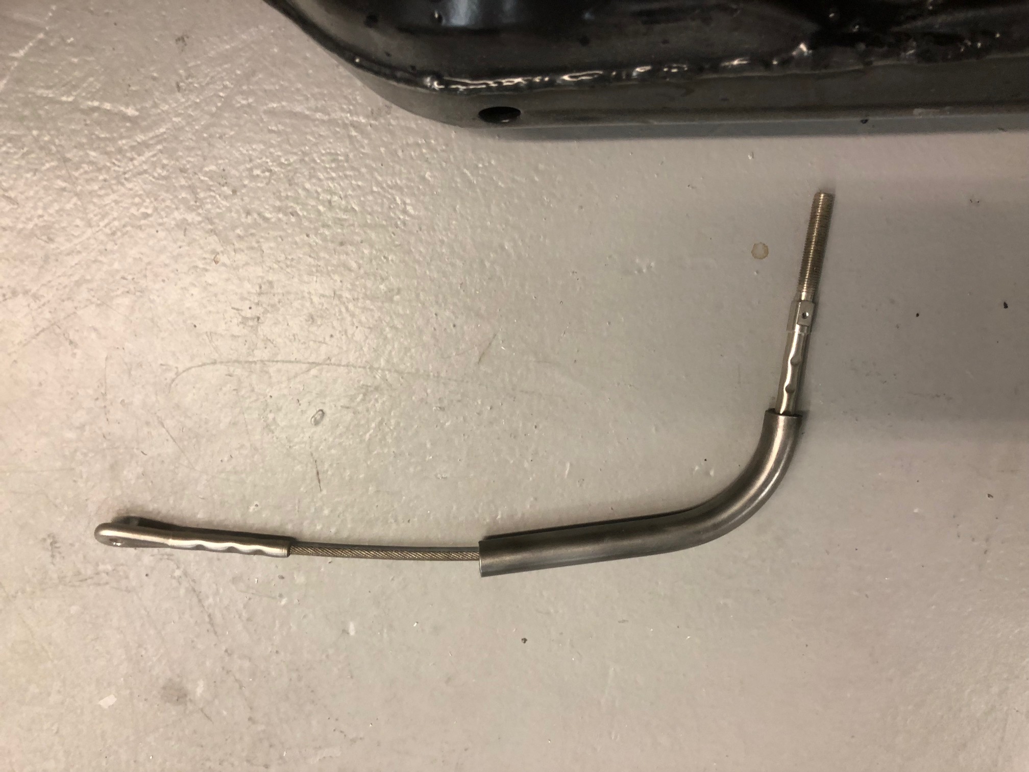

I can recommend the Tangerine racing set up with the swaged ends. You can use standard cables, you need some spacers made up to set up the align the shoes correctly with the inner hub - and mostly welding.

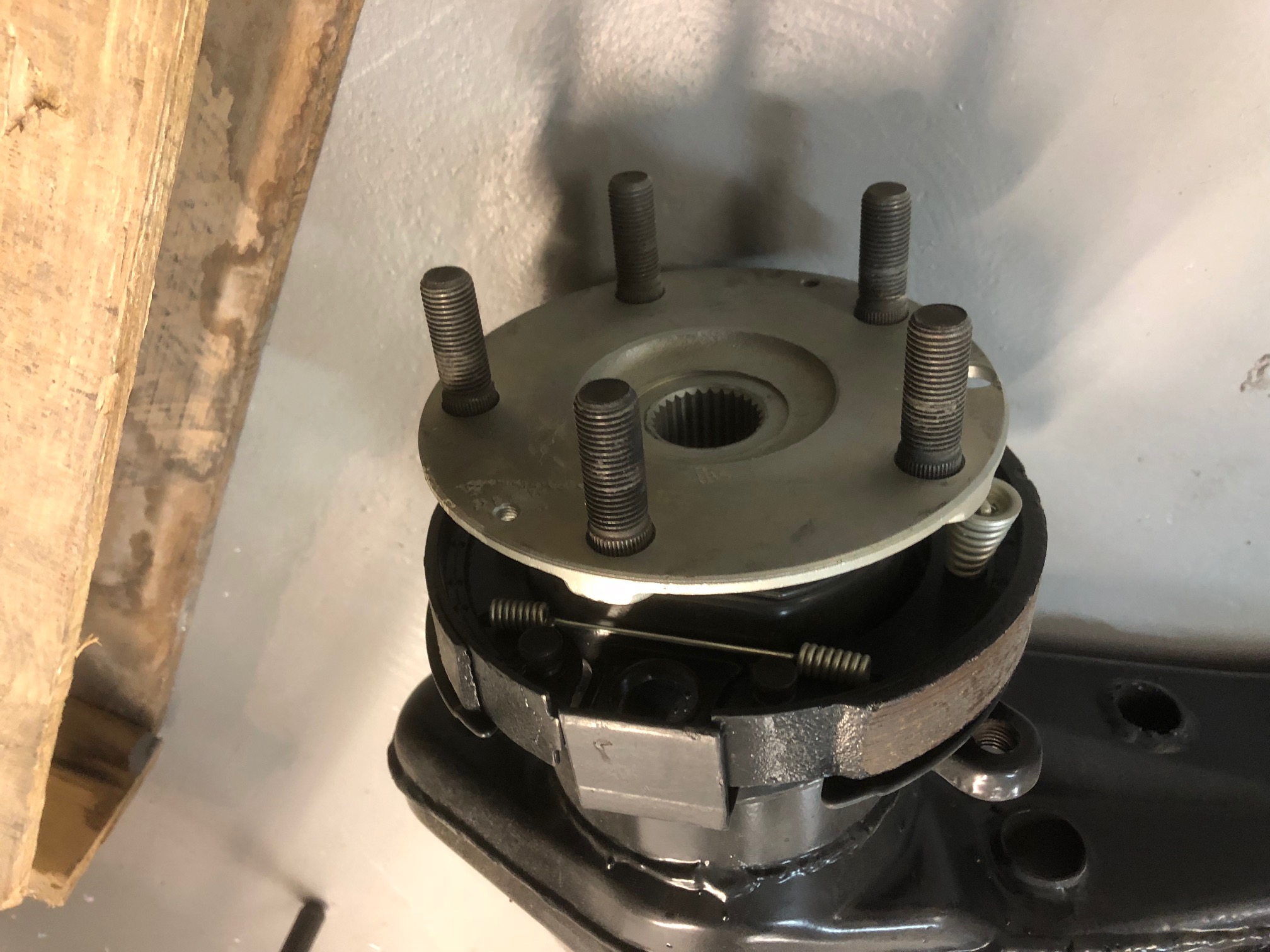

I found a set of used 911 E brakes, and then I got the cable kit from Tangerine. I haven't installed yet

Had a quick inspection in the workshop yesterday. I have a set of trailing arms with the 911 parts, two hand brake wires (don't know if they can be used?) from a 914-6 clone i used to own piratenanner.gif
I suppose I can either replace the trailing arms or I can use the parts, and do some grinding and welding, on the ones on the car.
What is easiest do you think? I suppose if I switch trailing arms I should probably replace all bushings in them, which I suspect is a shitty job(?)
burton73
You are all set. Put some new bushings and stainless-steel shaft and move the rest over. It looks like there is some extra welding done on the trailing arm. Get Tangerine cable and weld its sheath on the arm and get the disk with the set up for the brake and well you should be done. You could drill and weld a tube inside of the trailing arm if you wanted to reinforce it more. I let PMB do that for me.
