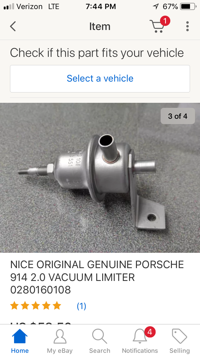

I cant find mine andni wastes an hour looking- i have to cap these off now and try and get battery gas and oil in car to test run - please pm me
and Admins, yes i put this here not in WTB because 1. i was hoping for a gift but i will buy, and 2. i need it asap and many dont go to the classifieds so ......
if anyone is going to okteenerfest and can spare one or wants to do a deal please let me know.

this

Cap the lines till you get one.. It'll run without it.

What goes wrong internally with the valve?

It will certainly run without it, but be careful. My understanding is that its primary purpose in life is to limit vacuum during deceleration to protect the diaphragm in the MPS. So limit the down shifting and engine braking. You don't want to be buying a MPS.

Actually, the function of the decel valve is not related to the MPS. Otherwise they would not have put them on L-Jet cars.
It's function is to hold open a bypass of the throttle plate when end engine experiences high vacuum on the intake manifold. Without it, a snap close on the throttle can cause the engine to stop.
