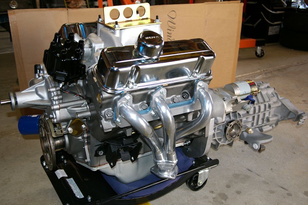

This is a photo of the 3.8 liter Buick V6 that will be going into my 75 914. This apparently used to be fairly popular swap. Unfortunately no one (that I could find) makes the front motor mount cross member adapter anymore. I emailed Renegade but got pretty close to zero help from them, other than being told just short of I’m nuts to do that swap when I could do a V8. Well, I didn’t want a V8, I wanted a V6. The folks at Desert Hybrids were much nicer but didn’t have a suitable (for me) solution to my front mount problem.

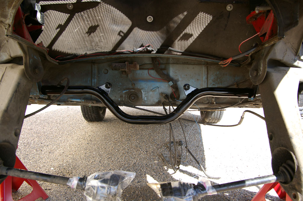

What I did find via an internet search was a cross member for putting a Buick V6 into a street roadster. It is very stout and cost a grand total of $58 to my door (the Renegade V8 cross member runs $275 plus shipping!). It will take a wee bit of adaptation to use the roadster cross member but appears to be fairly simple and straight forward (see photo).

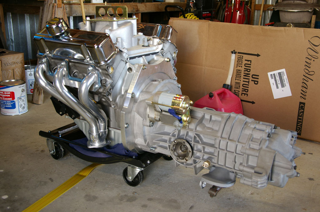

The folks at Kennedy Engineered Products, makers of the Buick V6 to Porsche 901 transaxle adapter plate, clutch, etc., were a delight to deal with, especially Jodi. She quickly responded to my emailed questions, provided some great advice, and was simply a pleasure to deal with.
What I like about the V6 conversion is the ability to not have to resort to an electric water pump, or much of any other front of the engine modifications. Also, the Buick distributor is at the front of the engine where it is easy to get at.
Once this one is complete I also have a 4.1 liter Buick V6 that I am rebuilding that will go into my white 76 914. The type IV engine in both cars ate a valve; I got tired of dealing with the perpetual oil leaking type IV engine and all its peculiarities.

dbledsoe   Cross member photo.   Jun 16 2005, 11:04 AM

dbledsoe   Engine front view.   Jun 16 2005, 11:17 AM

nocones   I have always wanted to do a Buick GN motor in a 9...   Jun 16 2005, 12:25 PM
neo914-6   Don, Nice work, did you bead blast the tranny? S...   Jun 16 2005, 02:38 PM
messix   the gn motors are very easy to get 400-500 hp out...   Jun 16 2005, 02:46 PM

dbledsoe   Just for the record; my Buick V6 3.8L was rebuilt ...   Jun 16 2005, 03:16 PM
messix   stock cam? if so, without the smog stuff your go...   Jun 16 2005, 03:25 PM

messix   keep in mind that the early 80s smog fix was to ch...   Jun 16 2005, 04:13 PM
