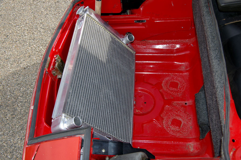

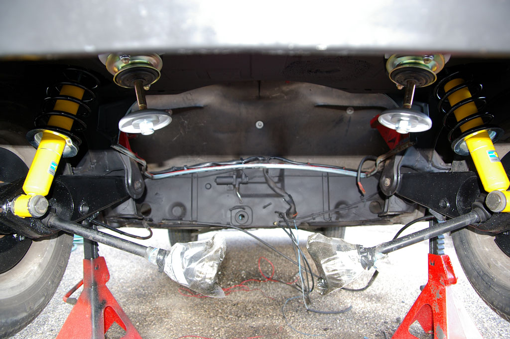

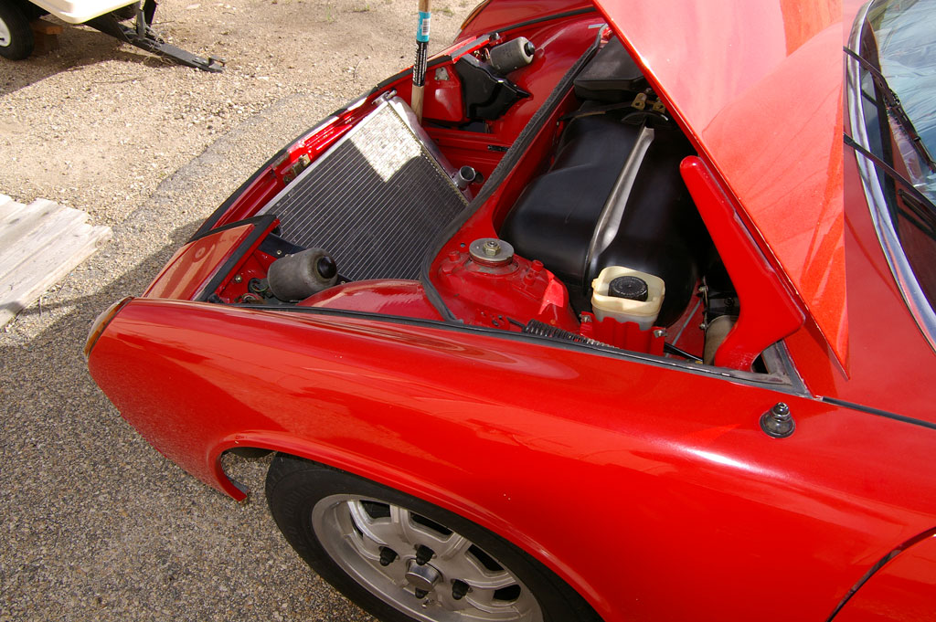

A couple of minor updates: Engine bay/undercarriage cleaned up, degreased, some touch up painting done (some still left to be done), new Bilsteins installed with new 180 lbs. springs, and new transmission mounts installed. Also shown, is the new Griffin aluminum radiator. It's only sitting in place at the time but the orientation is about correct.

Griffin
dbledsoe
post Jun 28 2005, 11:15 AM

Griffin again
