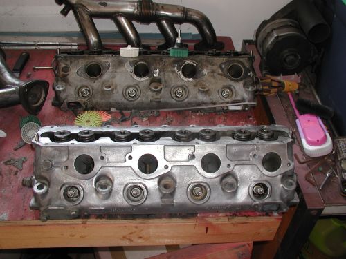

I use these pads made by 3M they have them in green and white. They are 2 in dia. and clean carbon and gaskets like crazy.
spare time toys
post Jun 16 2005, 06:10 PM
hooked on grilling food.
Posts: 4,059
Joined: 3-April 04
From: West Plano Tx
Member No.: 1,884
Before and after I have cleaned up 1 head in this shot
