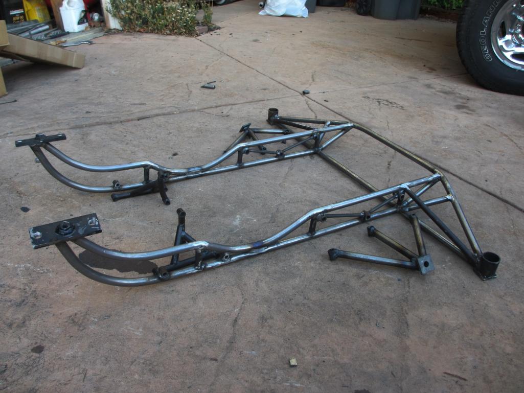

Just buy some square tubing 0.120 wall. Weld a stack of washers at the ends and it will look almost like the stock bar. Then weld your brackets.
Or build one of these...

and Mike Bellis,..If I could build that I would be way ahead for for sure ..and NO road issue's with that set-up..!!
