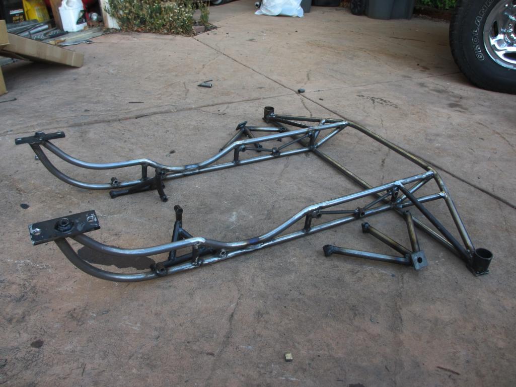

Just buy some square tubing 0.120 wall. Weld a stack of washers at the ends and it will look almost like the stock bar. Then weld your brackets.
Or build one of these...

well I had some 1/8 walled square tubing but when I set that engine on it bow's a little I guess I could weld another piece to it,I don't know how strong of tubing I bought but it seemed pretty stout.

and Mike Bellis,..If I could build that I would be way ahead for for sure ..and NO road issue's with that set-up..!!
