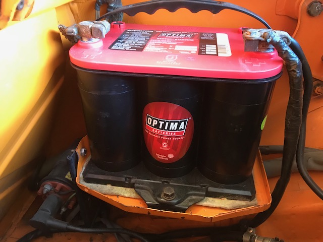

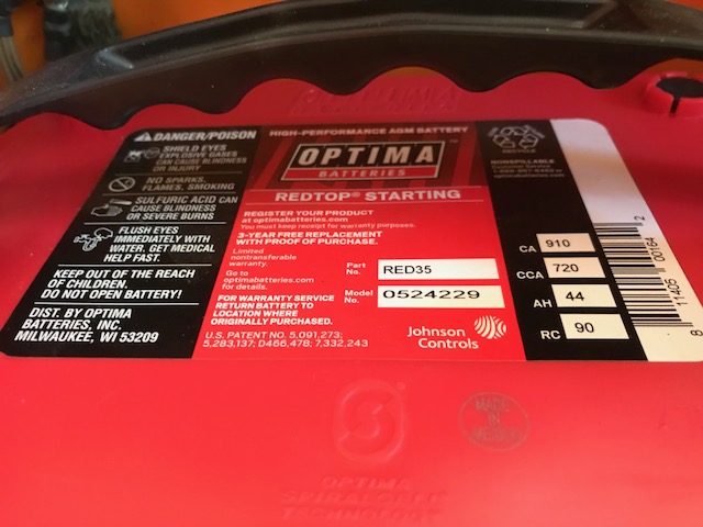

I use the Red Top 35.
I got twelve years out of the last one. Installed in 2006, and just replaced this past weekend.

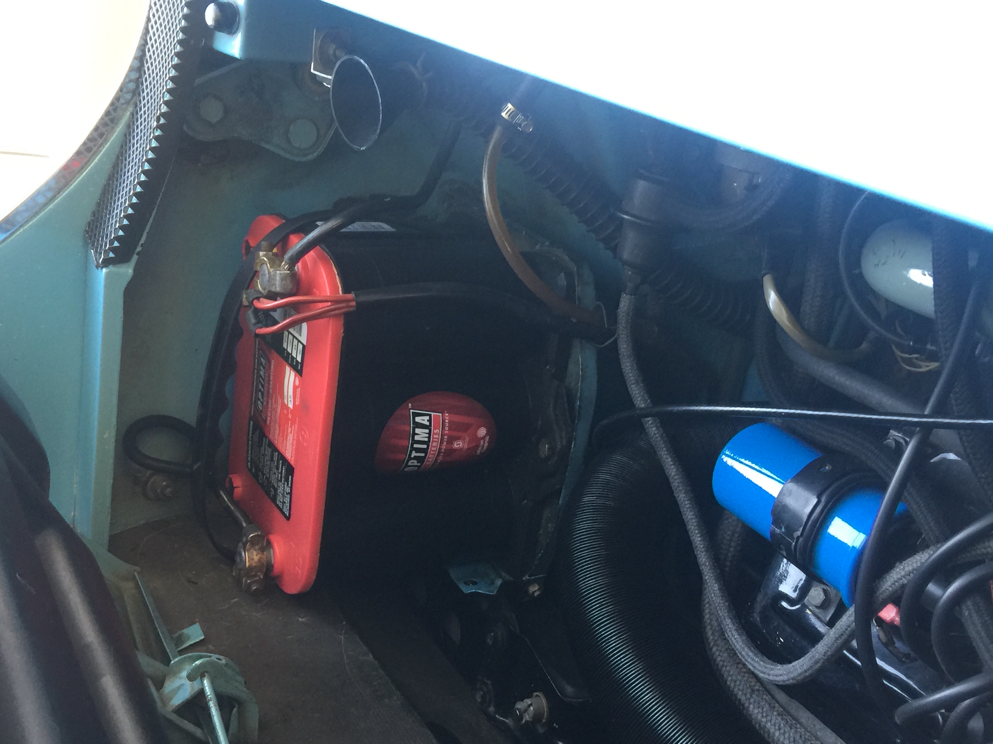

No mods required.
In the picture you can see the battery hold down bracket.
The 35 has plenty of cranking amps to turn over my 3.2 engine.

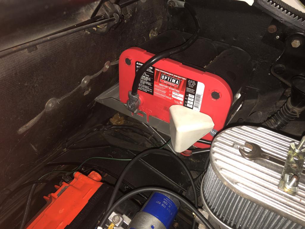

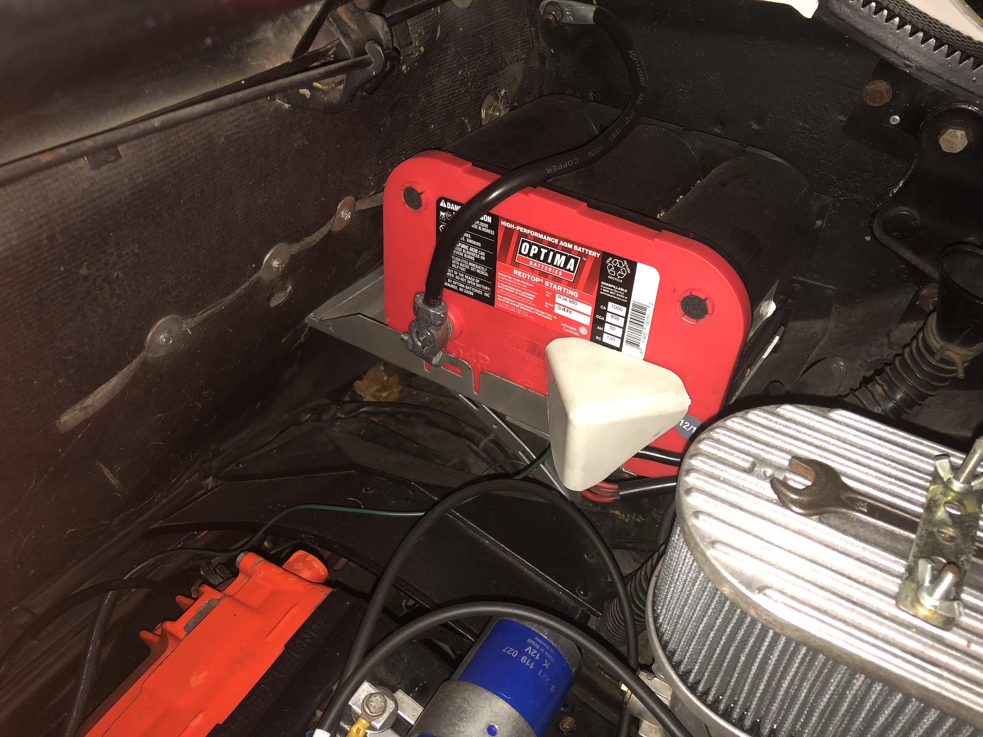

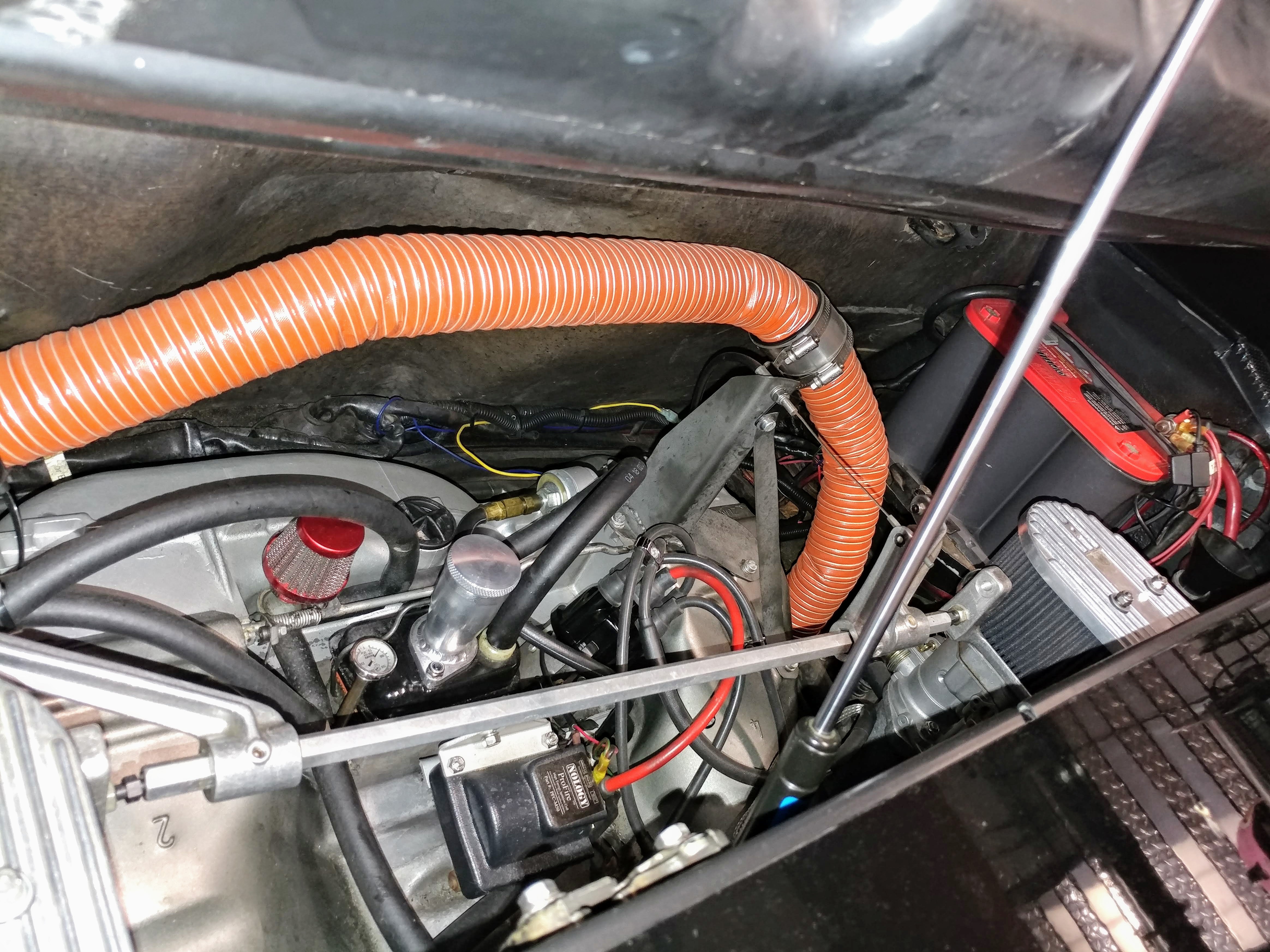

Mount it sideways and you will NEVER have a clearance problem closing the engine lid.

QUOTE(Ansbacher @ Sep 18 2018, 05:19 PM) *
Ansbacher

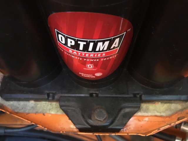

If the positive terminal is as close to the metal battery pan as the negative one shown, that's not a good setup (can't see under the white cover). Also, how is the battery secured in that fashion to not slide back and forth in the pan?
As far as Optima longevity, I have one in each of my 997s, in my 928, in my 914, and in my DD pickup. The one in my 914 has been in there since 2000, yup, 18 years. Granted it isn't driven all that often and is always connected to a Battery Tender charger/maintainer, but that's still a remarkably long time for any battery. The one in my silver 997 has been in there since 2013, as has the one in the pink 997, and the one in my truck even longer. Even run the Blue Tops in the boat.
For the Cayenne, because it takes a much larger battery, I went with a Napa Gold AGM. I'll never buy another lead acid battery again.
Here's the setup in the 914

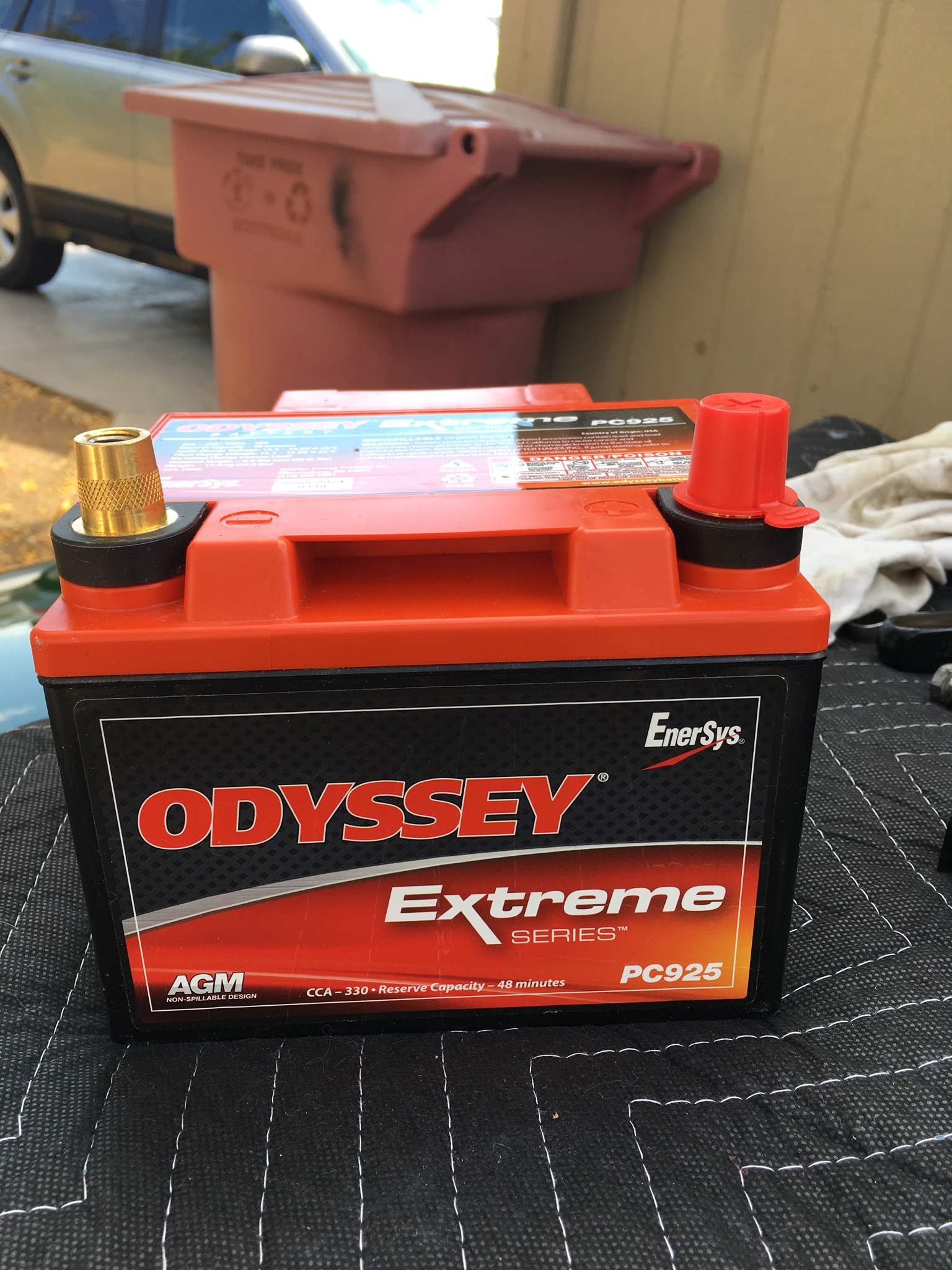

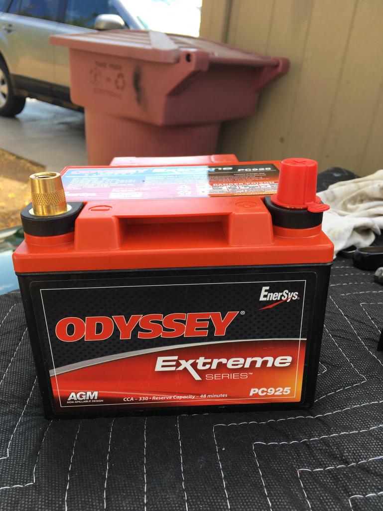

I am also a fan of the Odyssey PC925. Bought one for the 'BB' (2056 w/ 9.5:1 C/R) back in 2012. It's a little smaller than a 'normal' size 914 battery, so you'll need to fab a bracket to secure it (easy task).
I took the car off the road mid-2015 and the battery sat on a shelf for 3 years. In mid-2018, I charged it up with a 1.25 amp Battery Tender for a few days and reinstalled it in the car. It cranked over the motor just fine.
If you buy a PC925, don't forget to order the SAE terminal kit so your OEM battery terminal clamps will still work.

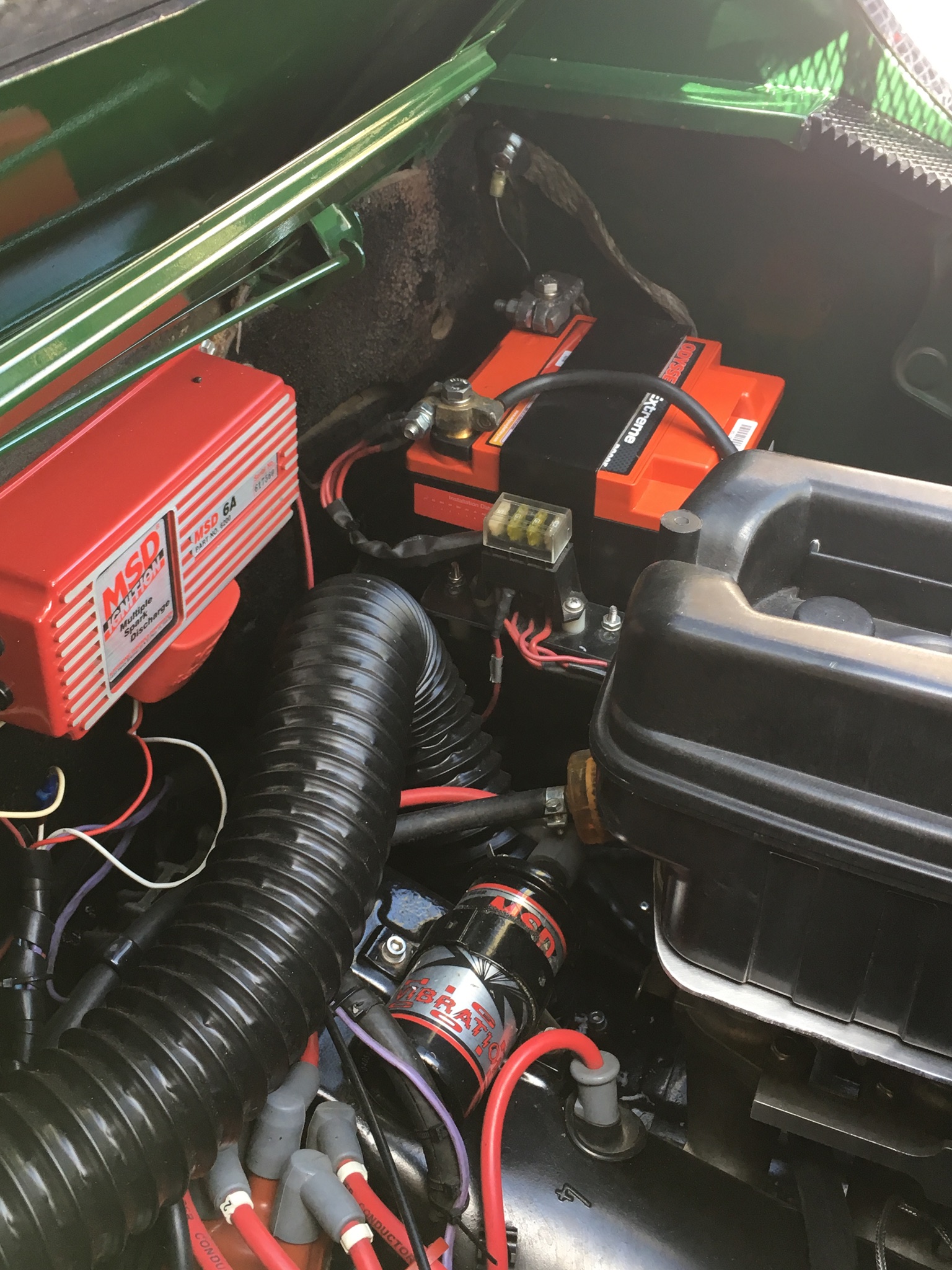

This is the Odyssey I installed using PMS’s adapter bracket
