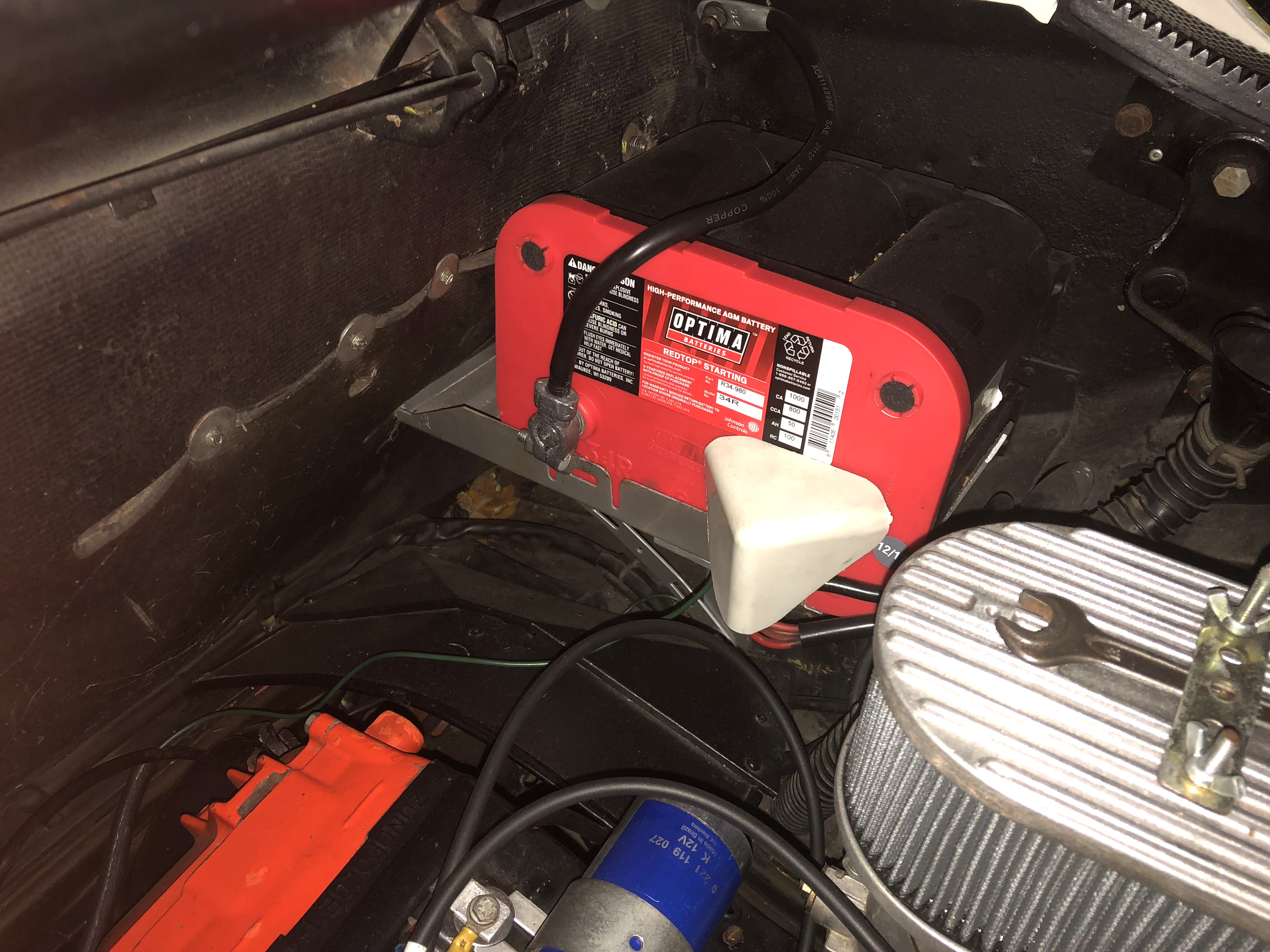

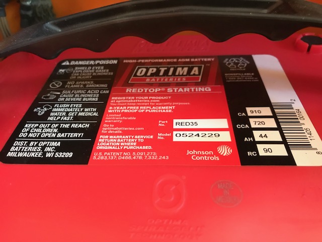

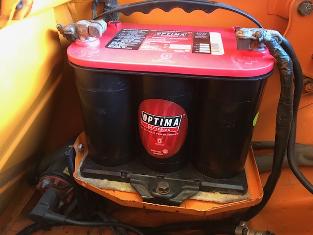

I use the Red Top 35.
I got twelve years out of the last one. Installed in 2006, and just replaced this past weekend.

QUOTE(don-6 @ Sep 18 2018, 04:47 PM)
Click to view attachmentClick to view attachmentClick to view attachmentdoes it fit without any mods thanks Wac
don-6
Sep 18 2018, 06:12 PM
No mods required.
In the picture you can see the battery hold down bracket.
The 35 has plenty of cranking amps to turn over my 3.2 engine.

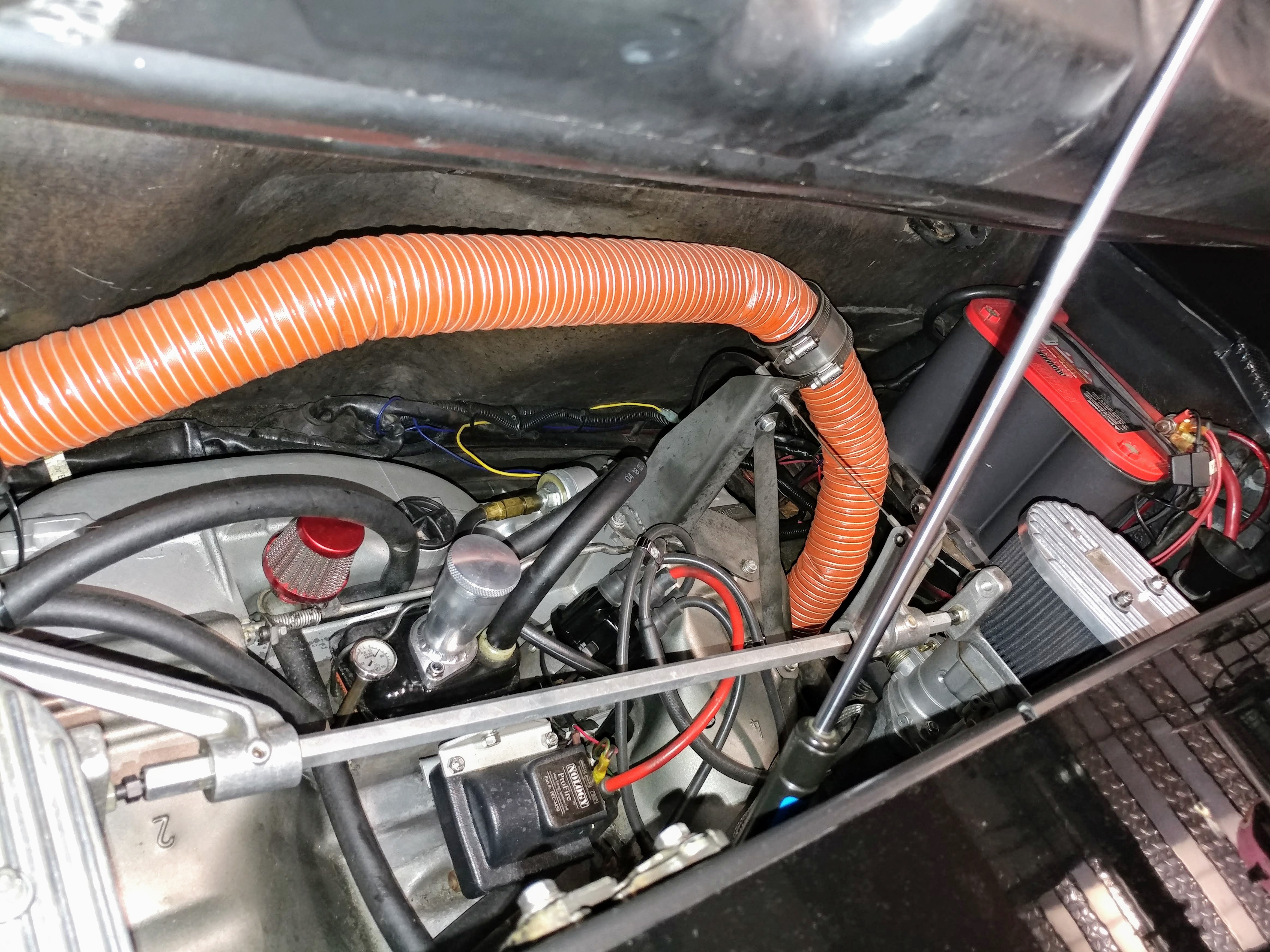

Mount it sideways and you will NEVER have a clearance problem closing the engine lid.

QUOTE(Ansbacher @ Sep 18 2018, 05:19 PM)
Ansbacher
Click to view attachmentIf the positive terminal is as close to the metal battery pan as the negative one shown, that's not a good setup (can't see under the white cover). Also, how is the battery secured in that fashion to not slide back and forth in the pan?

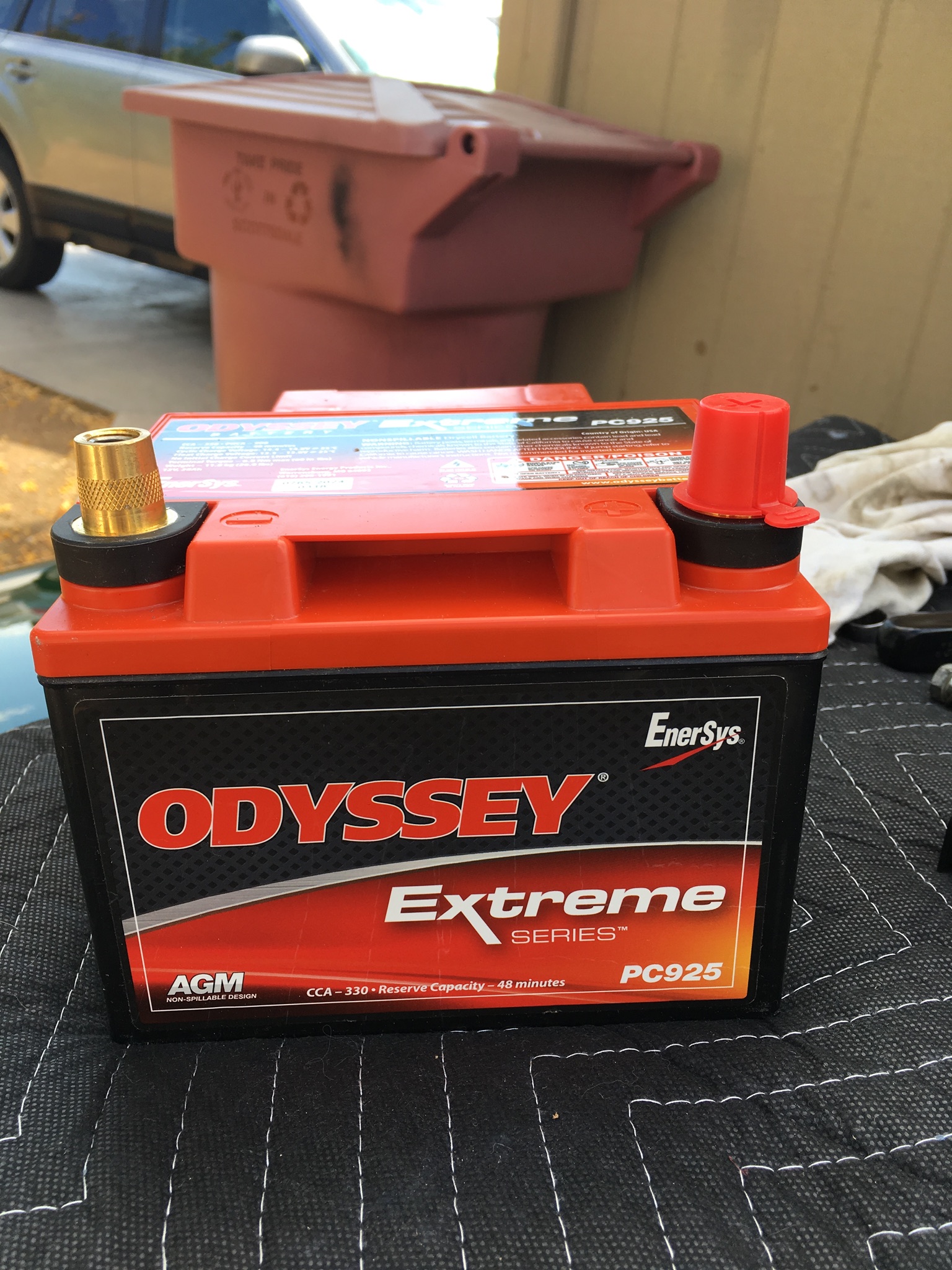

I am also a fan of the Odyssey PC925. Bought one for the 'BB' (2056 w/ 9.5:1 C/R) back in 2012. It's a little smaller than a 'normal' size 914 battery, so you'll need to fab a bracket to secure it (easy task).
I took the car off the road mid-2015 and the battery sat on a shelf for 3 years. In mid-2018, I charged it up with a 1.25 amp Battery Tender for a few days and reinstalled it in the car. It cranked over the motor just fine.
If you buy a PC925, don't forget to order the SAE terminal kit so your OEM battery terminal clamps will still work.

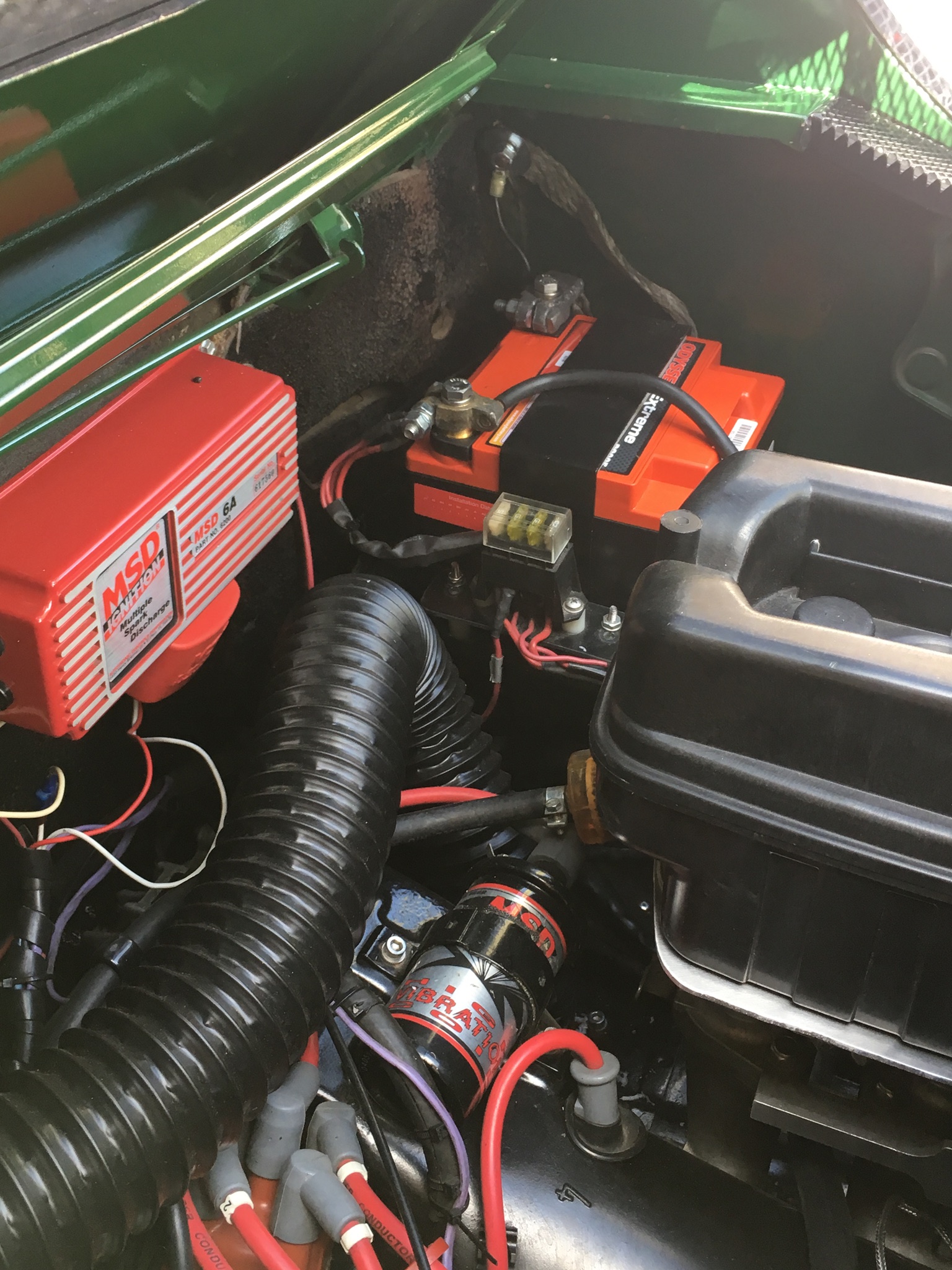

This is the Odyssey I installed using PMS’s adapter bracket
Click to view attachment Click to view attachment

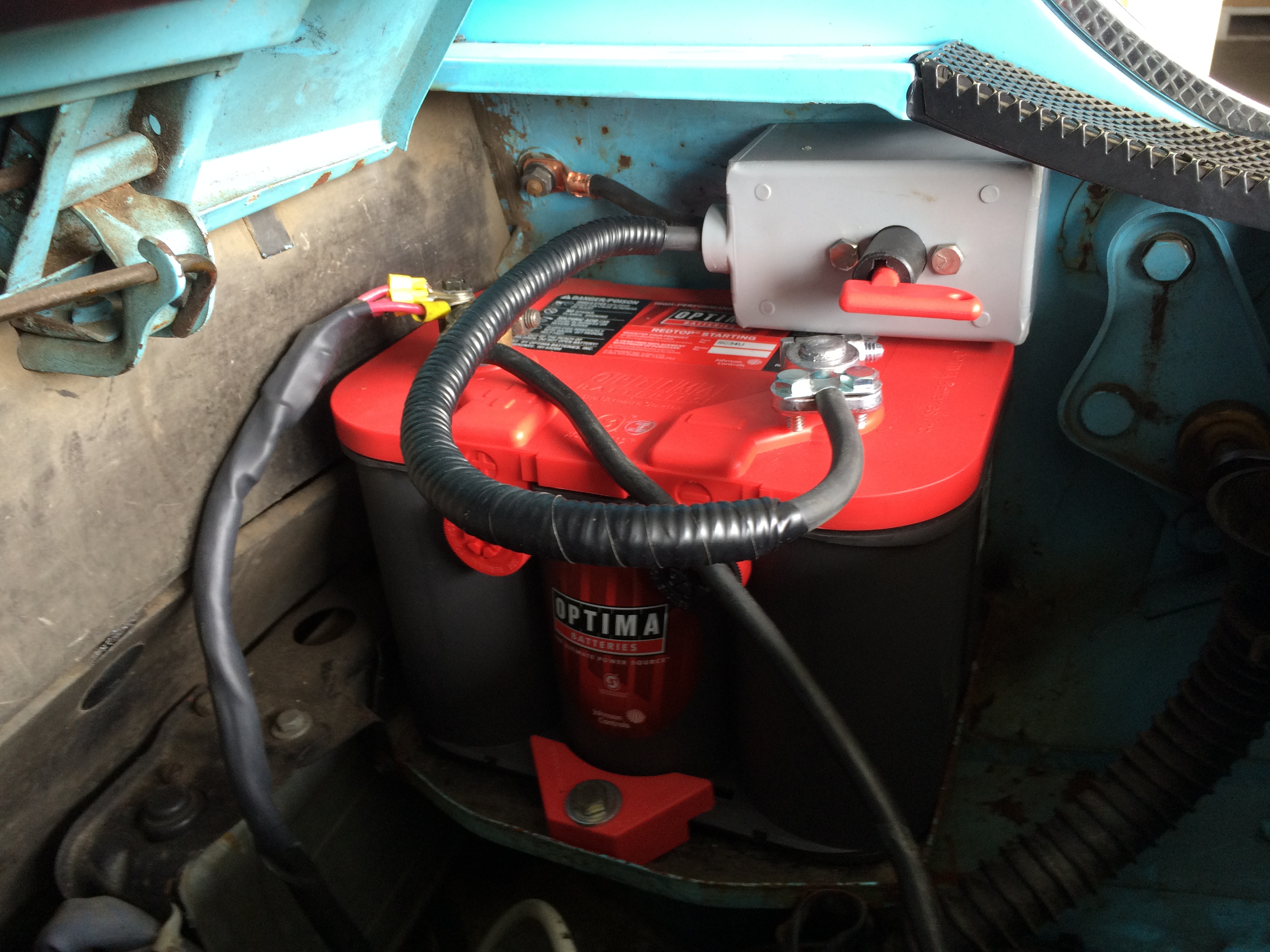

I've only had the Optima for 2 years. No complaints. Note the battery cutoff switch I fabbed. It reduces stress about electrical greblins working while parked in the garage and provides a small measure of thief deterrence.
