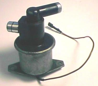

This is it. It'll be on the driver's side on top of the engine, just in front of the intake runners.
Remove it from the car. Soak in carb cleaner, WD40, etc overnight. If you have a bench DC power supply, you can test it by putting 12VDC on the wire lead and ground on the body of the AAR. With power applied, it will heat up and slowly close until you can't blow air through it.
