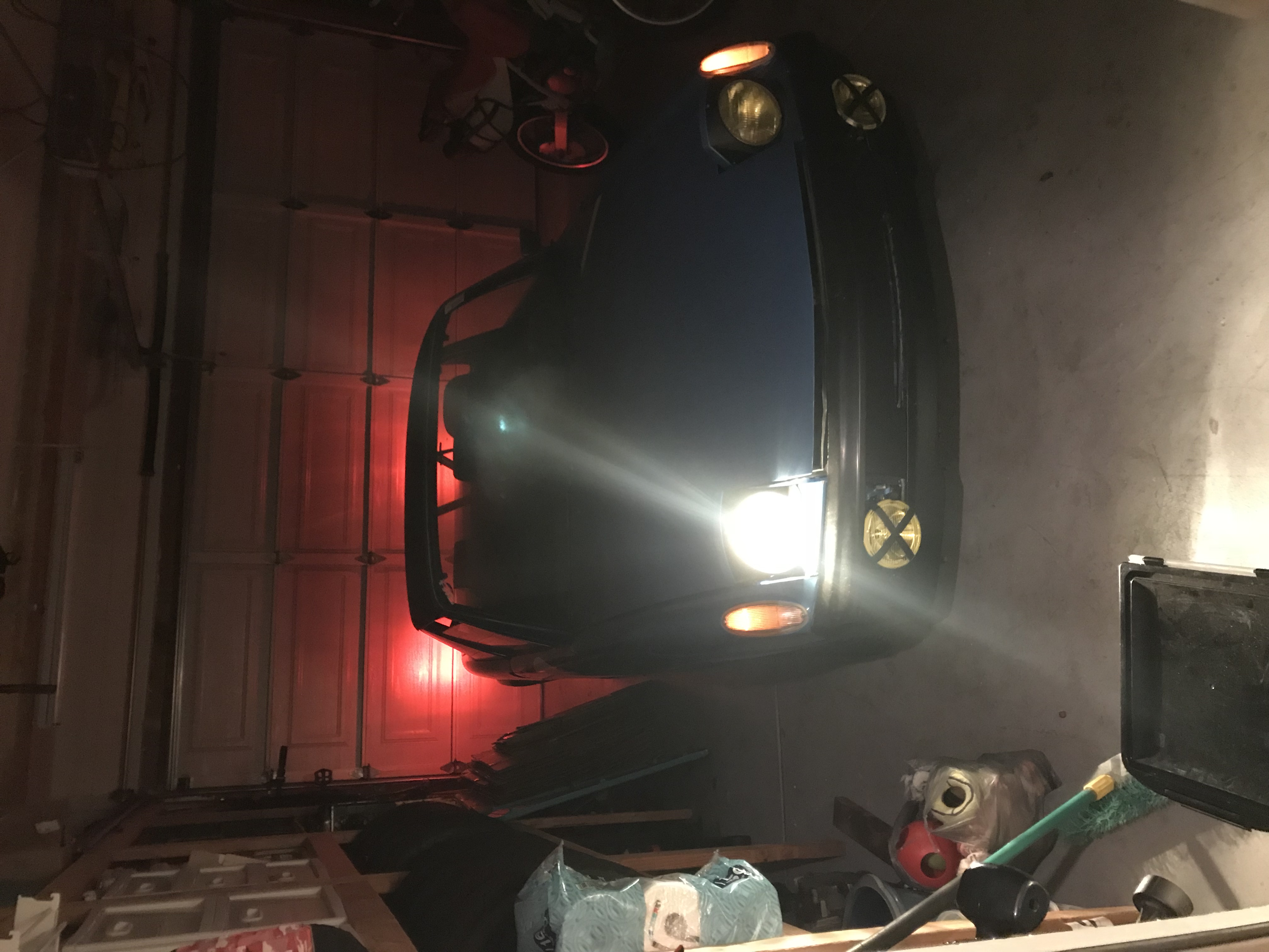

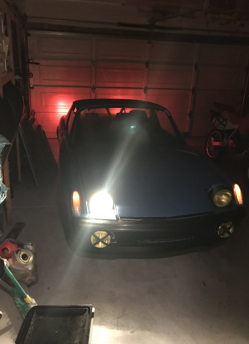

24 hours later, I'm gone and my wife calls me and asked if there was a reason I had the 914 lights on in the garage. I tell her that is not possible, the car is so dead it turned off while driving...she sends me the below pic...
I have never seen this... could the battery have regrouped and mustered some power on its own? haha, I shut the lights off, and for the hell of it turned the key to start and just got a "click" as if its dead again...
Not sure if I should take the battery to get checked by auto zone or an exorcist (IMG:style_emoticons/default/biggrin.gif)
I had charging issues before, and it was just the ground wire that came off, I checked that again and its still attached so now I have to check the alternator or any other suggestions to check would greatly appreciate.

Was the GEN light on when this happened?
What voltage did you measure on the battery when you drifted home?
What voltage did you measure on the battery when you turned the lights off?
If the car was hard to start, it could be oxidation on the battery terminals but the vehicle lighting shouldn't be affected.
Maybe get the car running and check voltages at the battery and the VR.
BTW, you have a headlight burned out.

Or a fuse out.

Anyway, The headlights and foglights worked when I was driving, when the car turned its own lights on, it only decided to do that one headlight, parking lights, and tail lights. haha. I'm hoping that it is not a wiring gremlin somewhere.
When I had the charging issue before a few months ago, I took the batt to get checked and it passed, I cleaned and scuffed the terminals as well. I did not, however, test the output of the alternator because I discovered the loose ground and it seemed to solve it.
What I am hoping is that the alt was going bad and the wire got loose, so it's a simple alternator fix, I really hate hunting down bad wires!!! (IMG:style_emoticons/default/headbang.gif)
