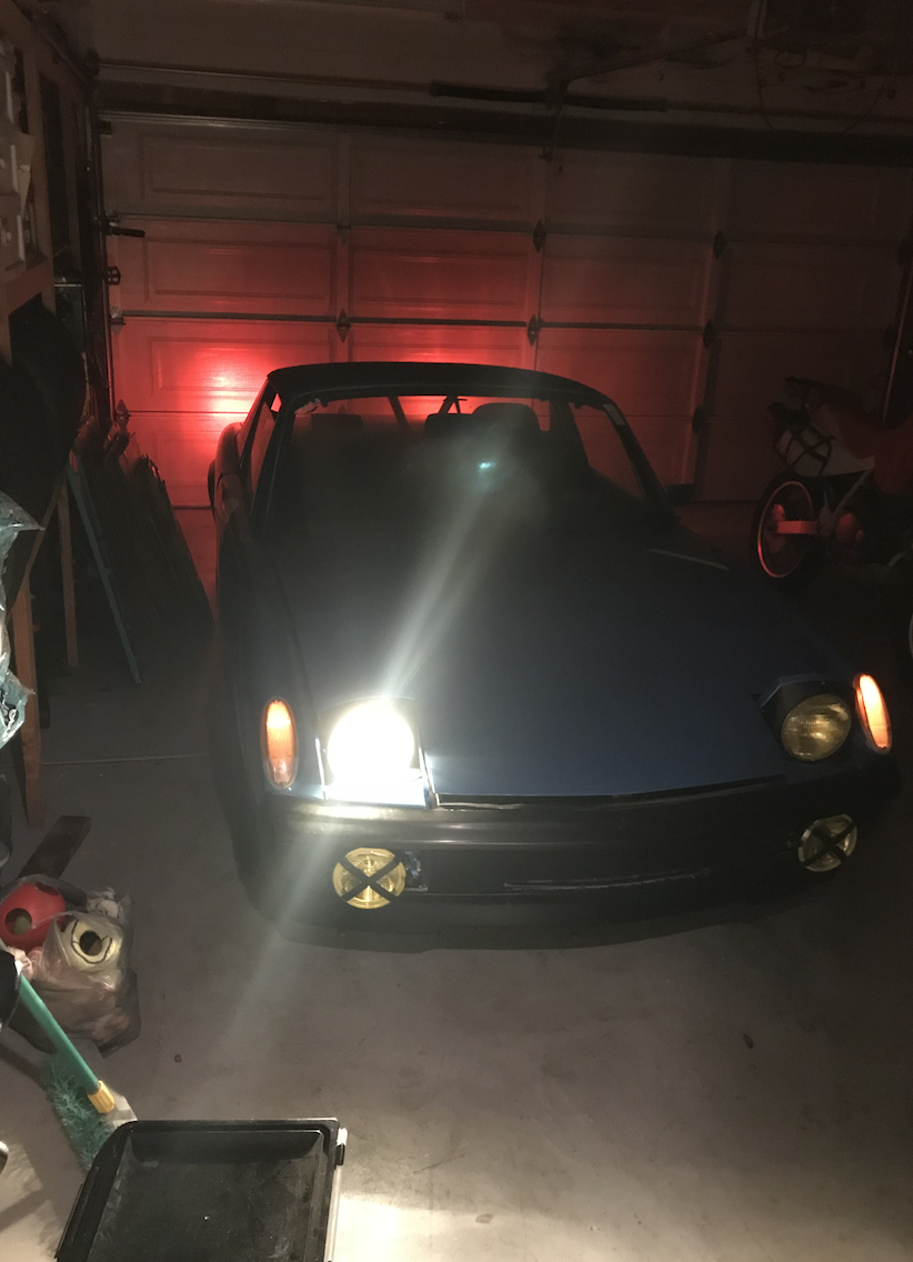

24 hours later, I'm gone and my wife calls me and asked if there was a reason I had the 914 lights on in the garage. I tell her that is not possible, the car is so dead it turned off while driving...she sends me the below pic...
I have never seen this... could the battery have regrouped and mustered some power on its own? haha, I shut the lights off, and for the hell of it turned the key to start and just got a "click" as if its dead again...
Not sure if I should take the battery to get checked by auto zone or an exorcist biggrin.gif

BTW, you have a headlight burned out.

Anyway, The headlights and foglights worked when I was driving, when the car turned its own lights on, it only decided to do that one headlight, parking lights, and tail lights. haha. I'm hoping that it is not a wiring gremlin somewhere.
