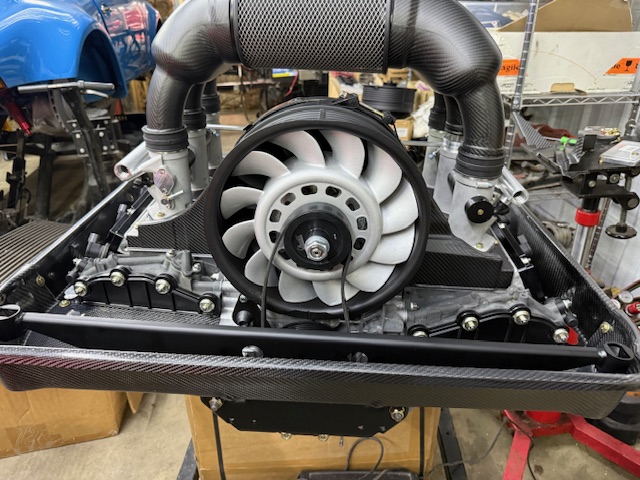

Well a set of Pauter billet heads cost $18k

/6 vs /4 but yes 3K a chamber does sound expensive. Thats still single plug?
Dual plug 964 engine.
