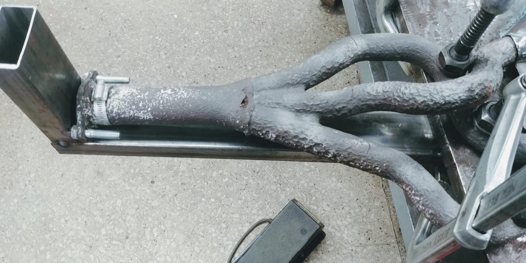

> Heat exchangers rebuild.
mb911
post Oct 10 2018, 10:30 AM
Posts: 7,795
Joined: 2-January 09
From: Burlington wi
Member No.: 9,892
Because I can . Attached Image

Ben,

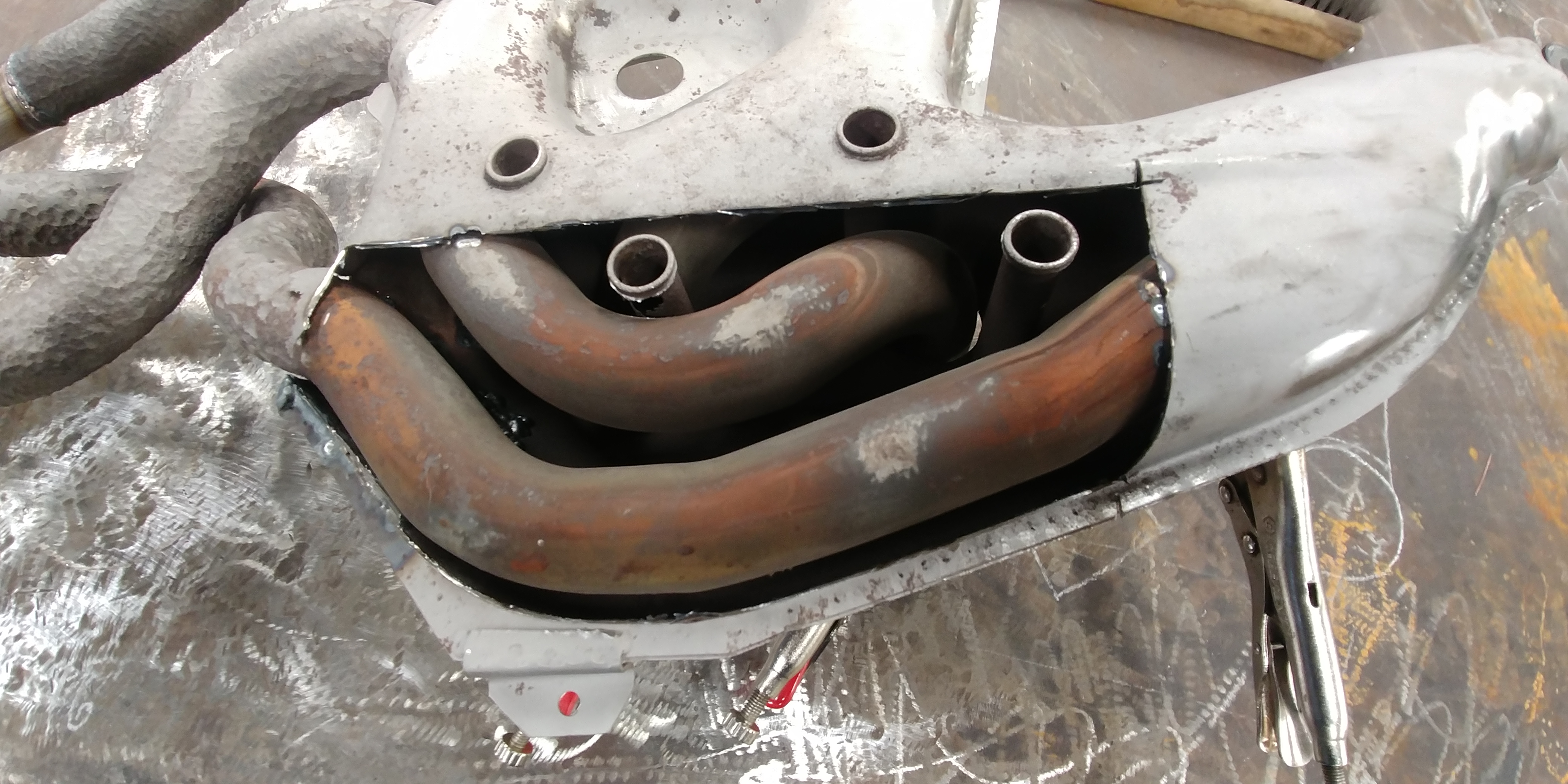

Given the apparent condition of the tubes you haven't replaced, is it really worth the effort? what about holes inside the clamshells?

mb911
post Oct 10 2018, 12:15 PM
Posts: 7,795
From: Burlington wi
Member No.: 9,892
Actually inside the clam shell is perfect.. I vote scoped..
Sit back and wait for the finished results.

We coulda made a deal. I made a set of L&R jigs for replacing the rear tube

QUOTE(IronHillRestorations @ Oct 10 2018, 10:23 AM) *
I made a simple Jig to do the job.. Gonna spray weld the pock marks.
spray weld? Had to look that up. Is that something you do at home or in your class? Would be cool to see it being done in a video in this thread. (IMG:style_emoticons/default/poke.gif) (IMG:style_emoticons/default/welder.gif)

I will see what I can do..

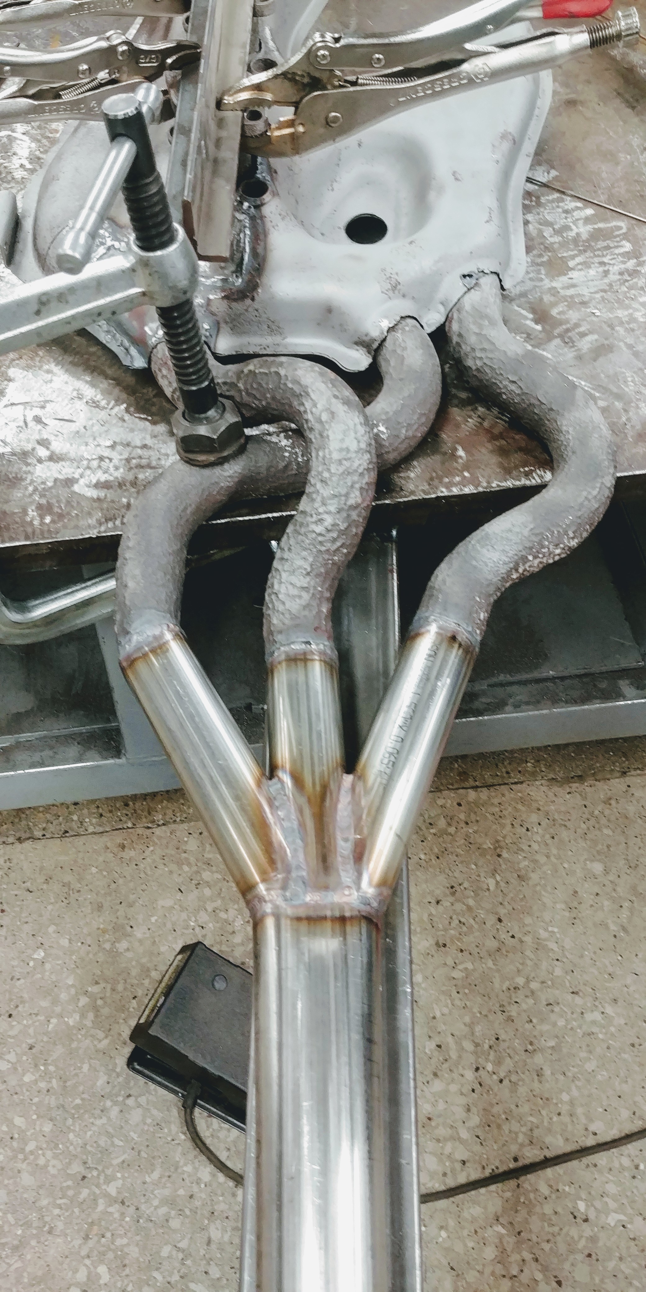

Seeing how even version 2.0 of the dansk reproductions leave something to be desired, I think it’s really worth bringing these back.

Isn't it crazy how these things rust and get all the pock marks...I'm really amazed at the good condition on the inside tubes on this set.
mepstein...what are you taking about on the new dansks ones...are they not the same?
somebody is making new style HEs (IMG:style_emoticons/default/biggrin.gif)

QUOTE(johnhora @ Oct 11 2018, 10:50 AM) *
I think becuase they get fresh air around them blowing constantly so they must control moisture or not heat up as much?

So I rebuilt the other side today and confirmed that the factory tubing is cast steel.. This is a very similar setup to the -4 heat exchangers material.. That is why there is the pock marks.. It is very thick material. Welds nice ..
