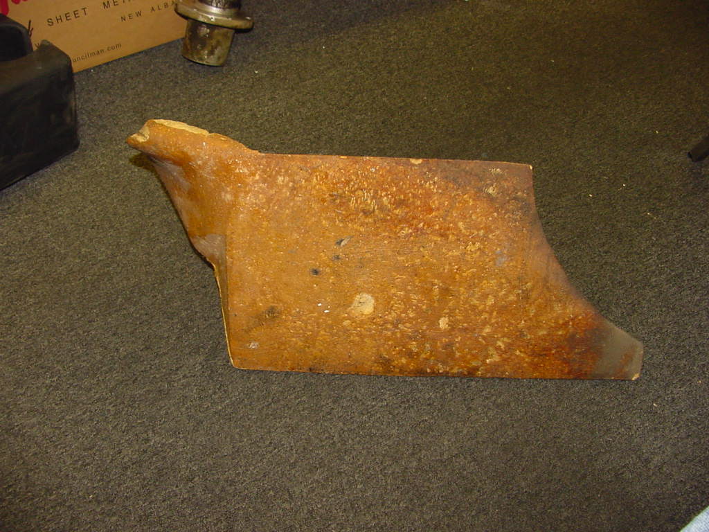

I hate foam - always liked what was done in the 911 for the passenger side - too bad Porsche did not do this to a 914 instead of the foam block.
Anyways - here is the victim to be replaced with aluminum....

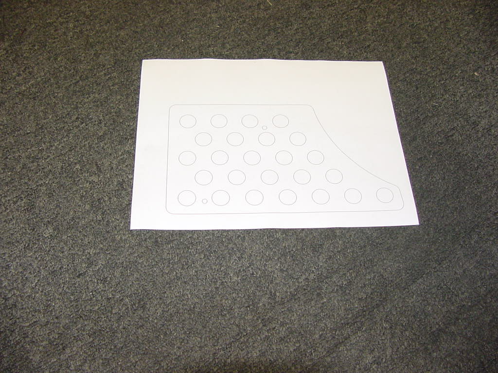

A print is made....
Now I have to wait....

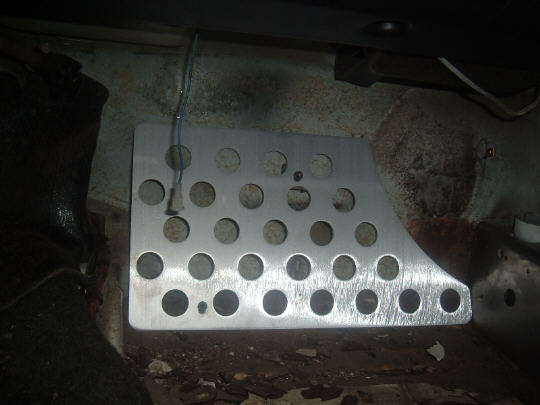

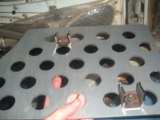

Well should have had this sooner but the heat wave here has been HOT.
Back of board with the two brackets to be weld onto the car....

Board is .19 thickness aircraft grade aluminum, 2.5 lbs

Engman
post Aug 4 2005, 10:25 PM
Zoisite
Posts: 1,349
Joined: 25-March 03
From: New Albany, IN
Member No.: 475
They are done - fit on the brackets is good - just need to weld it in. I am very pleased with the fit. Made two changes over the sample hrpo (hot rolled picleked and oiled) plate I made to test fit.
Will post in the resource section tomorrow - $64.00 plus shipping includes board and the two mount brackets.
