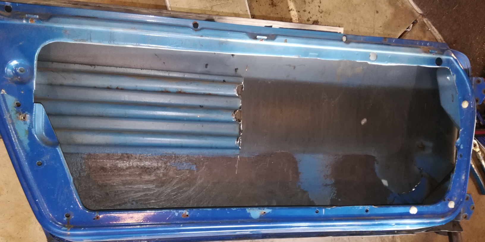

Well, I'm sure that would work. You would have access to cutting it off close to the edge and not mess with the inner panel or possibly even the interior components.
Here is how I got the front bar section out. It is riveted to the inside frame structure. I tried to drill out the rivets, but it wouldn't budge. So I cut that section out. After grinding it down I was able to wiggle it out from there. I'll put that section back in for strength.
Even so just that piece was 8#.
The back section was riveted to an bracket, but also looks to be riveted to the structure where the weatherstrip goes to seal the door to the body.
Weight changes
(bathroom scale measurements)
Full 1975 door weight 55# (no door card, or speakers etc)
remove window, internal components, and latch/handles 34#
remove 1/2 of the door bar 26#

I used a three inch cuter wheel...pretty easy to get most of it, just left the stub..

Thanks Joe, I think I'm going the same way you did on the door. it rains too much to go without windows. I just need to find a good thread on making lightweight windows.
I can see why people have different weights of their bars. Some get a bigger bite and leave less material.

I'll just have to get to it with the cutters and see how much I can get.
That's the window and door opening mechanism I'm thinking.
Simple and light. Did you use glass or polycarbonate windows?

Dan, I eventually cut the door skin off the door frame and welded them closed. I left the door handle in but the door gap is gone. I have had several people try to open the door.
