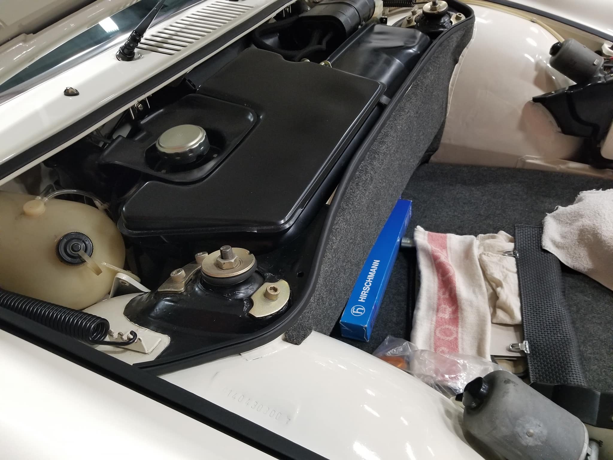

There are no cracks here, there was originally (factory 914/6s) tar around the top mounting area of the strut. This restoration started with a very clean chassis although I would agree that the black underside was a mistake.
Yep that's exactly my thinking as I mentioned in the other thread.
Except, the tar was all scraped off and the area was simply painted black.
So, no tar, just black paint, then what the heck is that if no a ugly weld bead?

Not cracks or welds ..the factory seal has been broken, and hardware replated ,,and new alignment,,leaving the old imprint of the factory alignment.....SIX
edit and some blk touch up....he should have put a pile of black goo on it like the factory did,,,
Except, the shape of the "whatever" does not match the mounting hardware.
If it was leftover goop from the factory, you'd think it would show the shape and outline of the mounting hardware.

true view , It depends how much was piled on and may affect the pop off shape....some had a ton , some a little bit..

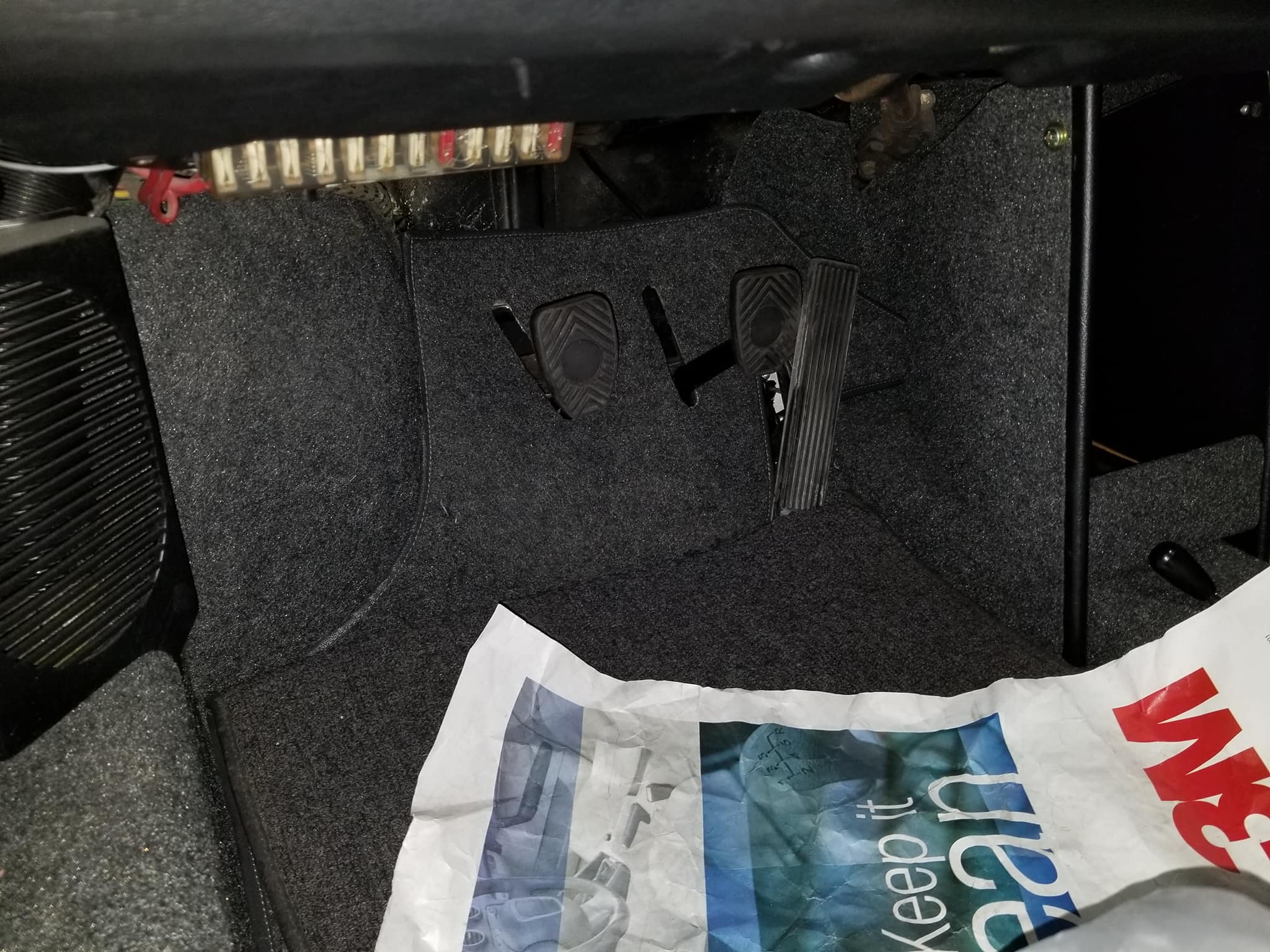

Sure looks like a dash cover to me.
Agreed.
It is a beautiful car. But at what I would guess its 6 figure price ($120k ish asking price?) it shouldn't just be "close" in need of a "few simple things".. It should be perfect.

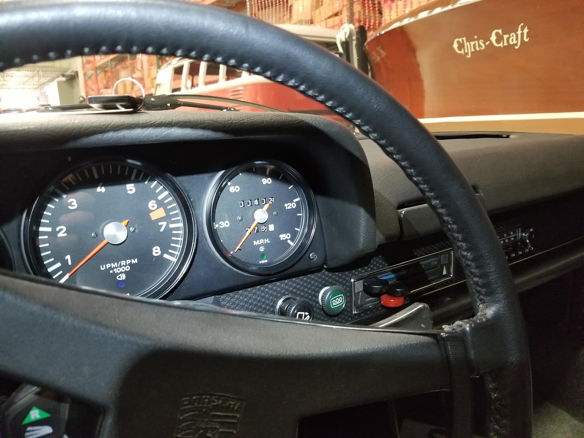

I'm picky, too ... so I noticed that the Tach is wrong (the installed Tach is from a 911T) (IMG:style_emoticons/default/rolleyes.gif)

Nice catch on the tach, most people would not catch that, since it is only the thickness of the redline.
