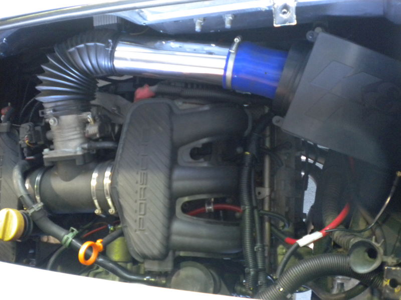

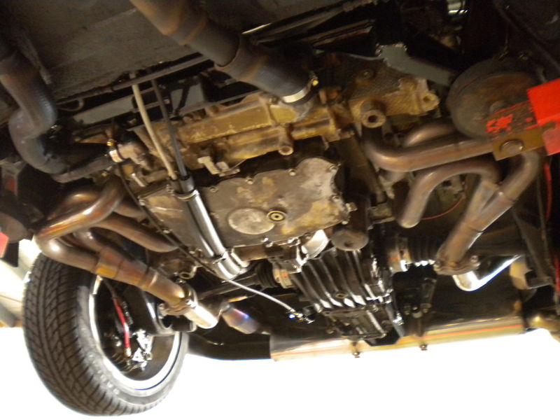

Running driving car with no mods to suspension mounts.

2.7 or 3.4?
Nice.
One of my latest acquisitions.
Chris H.
post Nov 29 2018, 01:59 PM
Posts: 4,107
Joined: 2-January 03
From: Chicago 'burbs
Member No.: 73
Yeah that's the one! Thanks Bob! Looks pretty good in there. Did they use the stock ECU or aftermarket? I remember looking into the wiring and there was an immobilizer that might be a problem.

QUOTE(BIGKAT_83 @ Nov 29 2018, 11:46 AM) *
(IMG:style_emoticons/default/lol-2.gif)
Nice rain funnel bet it connects to the
Coolant tank ?

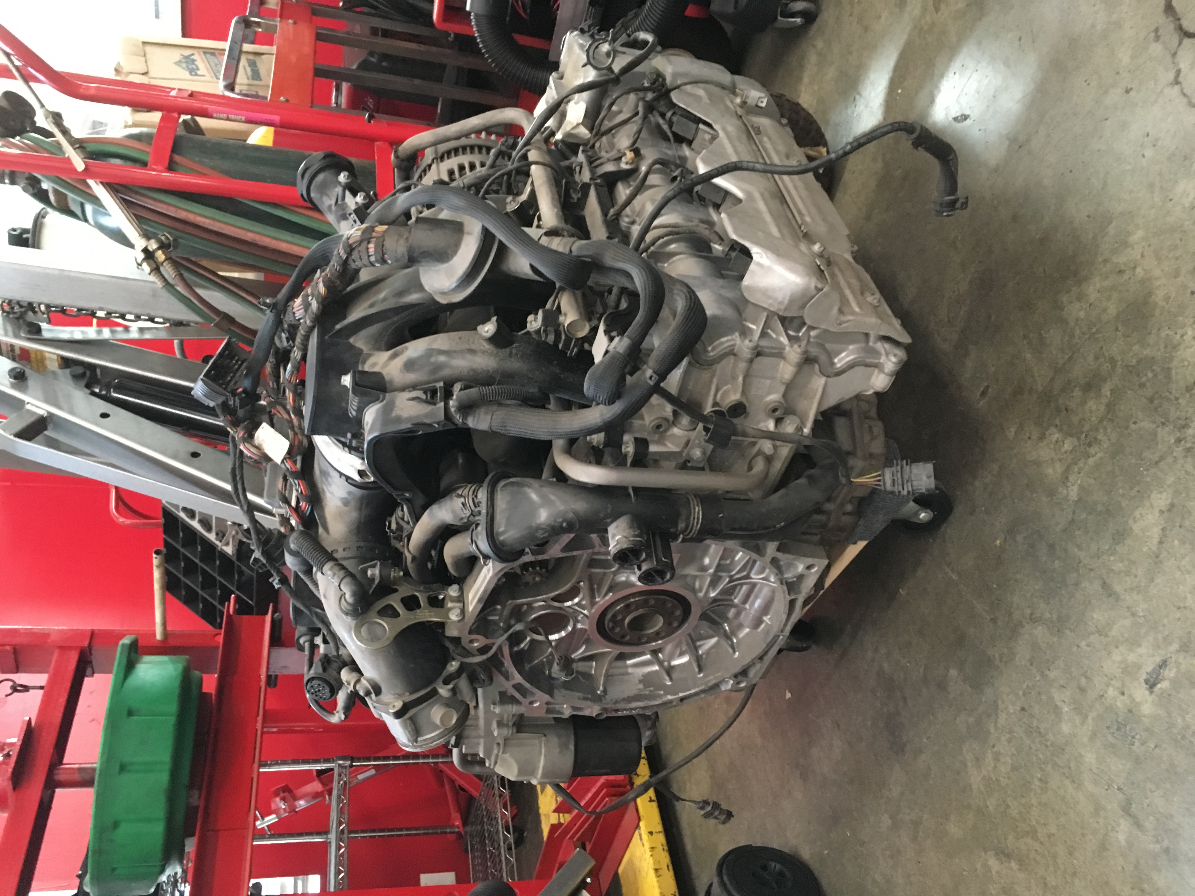

Looks like a nice fit. This there a thread of this build or do you have any photos and helpful advise.
Definitely use the 6M transaxle from the 9A1 but, one question is will the motor need to be moved forward or back to get the axle aligned and center of fender opening.
Another concern is over all height of the motor and how much of the upper truck cross section will fabricated. 9A1 motor measures from the crank center line to the top of intake runner just 15" which leads me to believe the original type 4 with injection was much higher.
Would also need custom axles made to marry the new transaxle and 914 hub.
I've yet to weight the motor but rolling it around on the floor seems 350-400lbs.

9A1 donor
