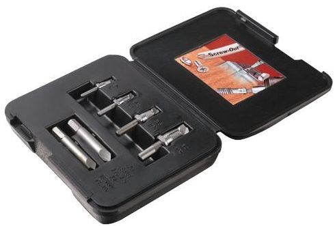

QUOTE (Jakester @ Jun 20 2005, 02:02 PM)
I think they are called "easy outs"
no. they're not.
"Easy-Outs" aren't.
anything you wedge into the stud tend to make it stick better...
check this out...
DrillOut Screw and stud extractors
