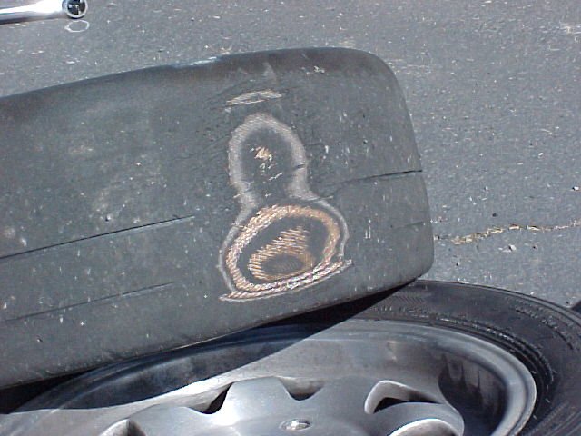

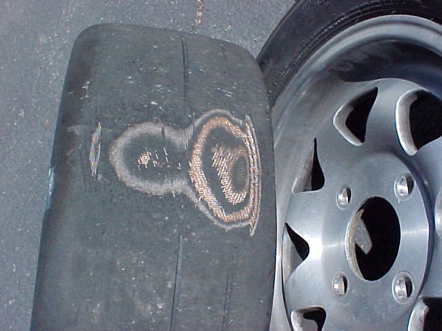

I just took the car off the trailer today to heat cycle my new a/x Hoosiers and lo and behold...
No wonder I couldn't get a time in the afternoon (IMG:http://www.914world.com/bbs2/html/emoticons/ohmy.gif)

The tire was the left front.
Had cords showing all over and the on big rash with a bulge.
The right front was showing cords as well.
Cover your eyes! (IMG:http://www.914world.com/bbs2/html/emoticons/huh.gif)

you should learn to take your foot off the brake when your wheels are locking up (IMG:http://www.914world.com/bbs2/html/emoticons/laugh.gif)

Crew to driver, Didnt you feel the vibration?
Good news you get new tires. (IMG:http://www.914world.com/bbs2/html/emoticons/biggrin.gif)
Funny thing is: NO!
My last run of the day felt really smooth and clean. I thought it was my fastest of the day. (IMG:http://www.914world.com/bbs2/html/emoticons/confused24.gif)
They gave me my time slip and I was shaking my head and saying " no way, no way" all the way back to the trailer.
I have it on in-car video and wanted to time it myself. (IMG:http://www.914world.com/bbs2/html/emoticons/w00t.gif)

That is not an excuse, it's an admission. The driver,owner, builder (that would be you) screwed the pooch.
When you flat spot a tire, it tends to lock up in the same spot again. When you get to chord, it's a certainty....and it takes less braking force. You might wanna write this down somewhere (IMG:http://www.914world.com/bbs2/html/emoticons/laugh.gif)

Holy crap! I'm pretty sure I didnt lock up and no spins while I had those on my car for the first 4 runs. You would have seen something while changing tires right? (IMG:http://www.914world.com/bbs2/html/emoticons/ohmy.gif)

You're all clear, Grant (IMG:http://www.914world.com/bbs2/html/emoticons/wink.gif)
It's all for fun.
I changed our tires out while you were in the field.
There's no way I could have missed that.
It's amazing what concrete and asphalt does to soft tires.
If my new Hoosier's look like this at the end of the day on Sunday, I'm out.
My Yok's are taking a real beating.

Learn threshold braking... flat spots occur when you exceed the threshold, and they will reoccur becuase you squared the tire, and when you brake hard it will naturally find the flat part of the tire, and it will get worse.

Yeah, thanks.
This was the first time on race pads at Alameda for me.
The asphalt sections are very gritty and I was locking the fronts *all day*.
It was interesting, we were walking the course and somebody said, " This surface it great! ".
I said, " No..." Bent down and palmed the surface revealing loose gravel, sand and crud.
Just another thing to deal with. (IMG:http://www.914world.com/bbs2/html/emoticons/rolleyes.gif)

When your times start going backwards and you feel your driving hasn't, it's always time to check the tires.
We've all been in the position where we were driving hard (and well) and had "something" else causing slower times.
Remember this is just part of the education process.
If times are going the wrong way - check the car - something probably has gone off.

You didn't feel that???
When tires are giving up the ghost- its like spring skiing - slogging and the times are disappointing. Nothing grabs good.
