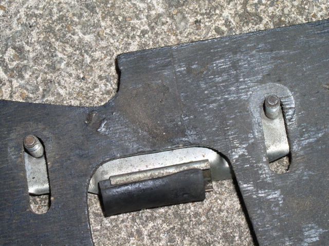

Guys, I was vaccuming my pedal area so I removed the wooden board. I forgot to take a pic beforehand so I need you guys to show me the correct placement for the metal doohickey behind the clutch hole.
Is this correct, or should the black thing be behind the board?

Follow the washer marks, they will guide you (IMG:http://www.914world.com/bbs2/html/emoticons/wink.gif)

Looks good to me.

I said I was an idiot! I was just woried that the black thing was supposed to be behind the wood (Although my brain said no). What is that thing?

Clutch pedal stopper, prevents you from hitting the floor and stretching the clutch cable too much and having another winter project.

Thanks, I supposed they intended it to be adjustable up and down? Hmm. Why? (IMG:http://www.914world.com/bbs2/html/emoticons/confused24.gif)

yes, that's correct ...
that "doohickey" is the stop for the clutch-pedal. without it (or mal-adjusted) you will overstretch your clutch cable and if you're lucky, you'll "only" brake the cable, if you're not so lucky, you'll brake the clutch tube inside the center tunnel ...
the "black thing" is where your clutch pedal rod is supposed to hit the stop ...
btw. clutch stop adjustement (as well as throttle stop adjustement) is done best with 2 poeple, one in the back watching the clutch arm (working the throttle) and one adjusting the pedal stop accordingly ...

QUOTE (Greg Bell @ Jun 19 2005, 08:21 PM)
because no two clutches are the same (wear, resurfaced etc etc). once the clutch arm is all the way in (disengaging the clutch) moving the pedal further down will only stretch the cable but not move the clutch arm any further (cause it can't go anywhere once it's all the way in) ...
so what you do is, you pull down the clutch pedal (by hand) and have a buddy check the clutch arm in the rear.
once the arm hits it's max. movement you adjust the stop so you can't move the pedal any further down ...
same with the throttle stop behind the gas pedal. have a buddy move the throttle body on the engine to WOT and hold it there. then you move down the accel. pedal until you feel the cable to be tight. then adjust the gas-pedal-stop so you can't move the gaspedal any further down ...
doing this will greatly prolong the life of your cables and save you the major headache of rewelding your clutch tube ...
(IMG:http://www.914world.com/bbs2/html/emoticons/wink.gif) Andy

So, should I be worried? I just installed it where the old washers had left an imprint.

QUOTE (Greg Bell @ Jun 19 2005, 08:55 PM)
yes. i'd be worried. you never know if the PO knew what he was doing. get a helping hand and adjust it once and be done with it ...
