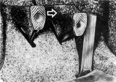

Hi guys,
right procedure to adjust clutch cable and stop:
Adjust the nut at the end of the clutch cable where it connect to the through out arm, so that you can move the pedal about 15-20mm
see the picture
michelko
post Jun 20 2005, 02:53 AM
Post #23
Posts: 867
Joined: 30-November 03
From: Germany, Lambsheim
Member No.: 1,404
after that adjust the pedal stop just enough, so you can shift in reverse without grinding. Thats what the manuel say.
