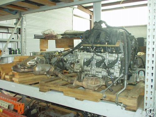

Boxster running gear.
2.7 with transaxle

something about a cable shifter...and relocated rear suspension to do aboxster swap (IMG:http://www.914world.com/bbs2/html/emoticons/idea.gif)

Why would you have to relocate the suspension?

supposedly the boxster engine is too wide and it'll hit the trailing arm "ears"........of course I seen no reason why one couldn't just move the engine a little closer to the firewall..similar to the new subaru kit from renegade...I bet it would fit then.....

Tube rear sub frame to handle entire boxster engine, tranny, rear susp. Oh shit. Not another project (IMG:http://www.914world.com/bbs2/html/emoticons/beer.gif)

Remove the suspension ears.
Now that I have your attention, use the 996 rear suspension complete. Just make mounts for the 996 rear subframe and weld them to the underside of the 914.

I did all the research on this a few months back. The 996 rear suspension complete with brakes and hubs is 3K. It would take flares to put it on the rear of a 914 because of the offset, but the front mounts for the suspension would end up really close to where the current mounting ears are for the trailing arms. The rear would end up close to the cross brace in the rear trunk that supports the transmission.
It's hard to tell exactly where things would fit, but it looks like it would be really cool.
Now take that suspension, add a 996 front suspension by removing the wheel well s and replacing them with the 996 parts, a boxster 6 speed and cable shifter, and a VW W12 motor (500 HP, dry sumped, 12 cylinder engine that is no longer than a flat 6) and you get a 914 supercar.

Oh it WILL fit w/o 914 susp, I've seen Jason's. Should've taken a pic but you know how (IMG:http://www.914world.com/bbs2/html/emoticons/ph34r.gif) he is... (IMG:http://www.914world.com/bbs2/html/emoticons/laugh.gif)
Lot's of (IMG:http://www.914world.com/bbs2/html/emoticons/sawzall-smiley.gif) and (IMG:http://www.914world.com/bbs2/html/emoticons/welder.gif) but it will be cool...
