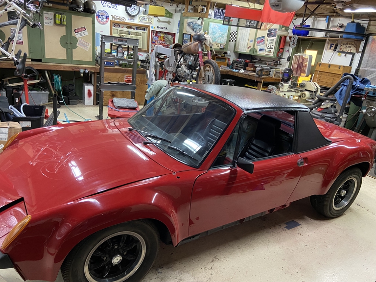

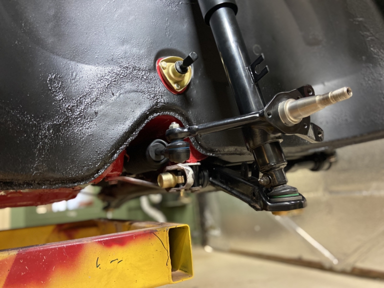

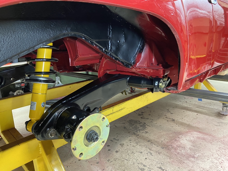

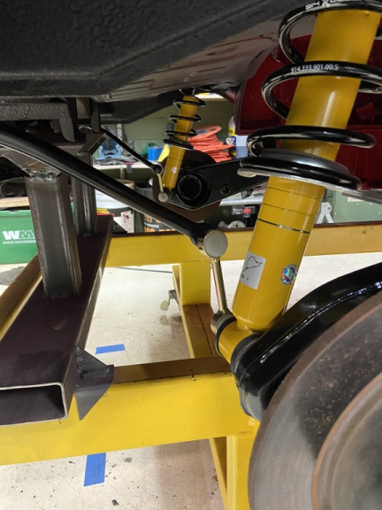

Well, it's officially a rolling chassis. No brakes though -- just good enough to roll onto a trailer.
Seems odd to have it sitting so low. I've grown accustomed to safari height with it sitting on the build cart for so many years.
Bittersweet knowing that this is sort of the end of the line for it for a couple years while we get moved. First order of business is to build a shop built so I have a place to finish it.
A few of the pretty bits. Thanks to @mepstein for the plated torsion bar caps!
Front ARB is just there plugging the holes so water doesn't get in there during the transport.
The rear ARB drop links were a bit of a PITA but got those installed so I don't have the rear ARB just swinging around under there while in transport.
Unlike when the car was 1st transported to me - it now has the axle stubs to prevent the rear bearings from being damaged and/or separating.

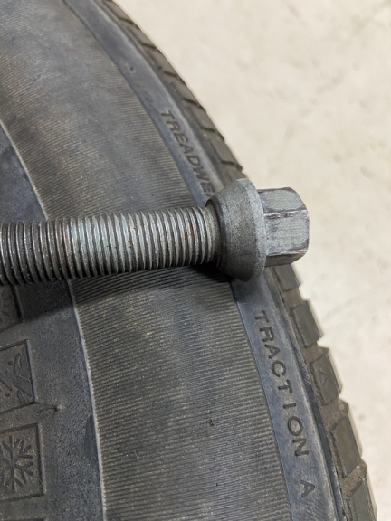

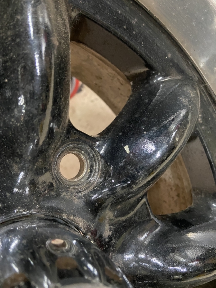

As has been the theme of late, here's another public service announcement.
Make sure you have the right lugs for the wheels you're running.
Here's another case where I didn't pay much attention when I stripped the car down. Wheels are supposed to use Ball Seat lug nuts. Someone was using conical lug nuts. This is a dangerous combination.
You can see that there is only minor point contact between the wheel lug seats and the conical -- this is a really good way to have wheels come loose on you! Don't do this! (IMG:style_emoticons/default/headbang.gif)
Will work OK for my transport purposes but I'd never drive it like this! (IMG:style_emoticons/default/screwy.gif)

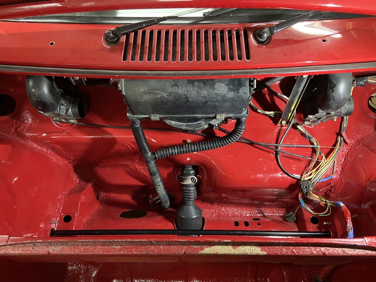

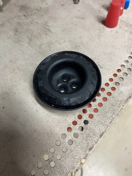

Airbox installed to give rain water a place to go when it inevitably gets rained on during transport.
Airbox was updated with new seals from the 914Rubber airbox kit Group Buy last summer.

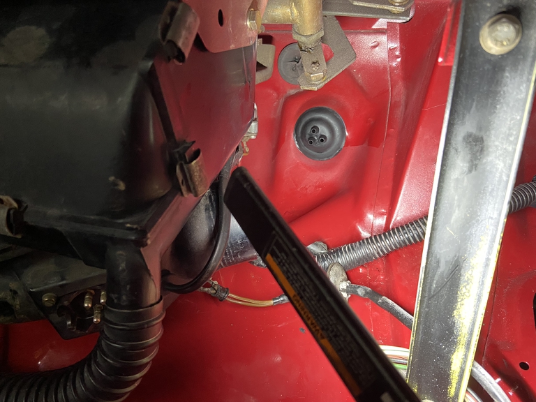

Here's the super secret rework to get the Bowden cable seal installed. @Mikey914 Although the seal is a faithful reproduction of the OEM seal dimensionaly, the durometer is harder than my 50 year old seal and wouldn't install properly.
After much futility trying to install it without modification, I had to rework it.
Reshaped the backside to provide some lead in. The removal of some rubber also made it soft enough that it could be deformed and pushed though the hole with some trim sticks . . . and maybe some profanity. I don't know why but the profanity helps. (IMG:style_emoticons/default/rolleyes.gif)
Finally - installed.

We fit into a 75 to check this. Looks like there may be some variation.
Sounds like if we go to a softer durometer of rubber it would solve the problem. The current is 75 duro. We could drop to a Shore 60A and that would be more flexible.
Superhawk996

QUOTE(Mikey914 @ Jun 14 2022, 02:12 PM) *
@Mikey914
Remember those types of grommets were installed on a production line, shouldn't take more than a few minutes to get one installed. Having lived a good portion of my life in assembly plants, I can tell you that grommet would stop the line, land an engineer in front of the plant manager, and the ergo committee in about 5 minutes flat.
Huge interrelationship between dimensions, durometer, and shape (form) as I'm sure you already know. All I can say is my 50 year old grommet is softer, and I'd expect that to be significantly age hardened.
That OEM seal design has a ton of meat behind it that has to be compressed a lot to go though the sheet metal You could probably drop down into the low 50's and still be fine. That grommet does nothing but guide 3 Bowden cables (that are already largely self supporting) and help seal the firewall from air / noise infiltration. A move down from 75 durometer would be a huge help.
Good excuse to fund a development fleet. You probably need a 70', a 73', and that 75'! (IMG:style_emoticons/default/happy11.gif) Thanks for looking into it.

My biggest concern was that it wouldn't make a good seal. 75 Duro is a typical hardness. The sample I had was in great shape and tested out harder, so we tried to emulate that we had. If there is variation and they very well may be, the softer option should work well. I'll just have to double check it on an earlier car too. Which I now have.
-Mark

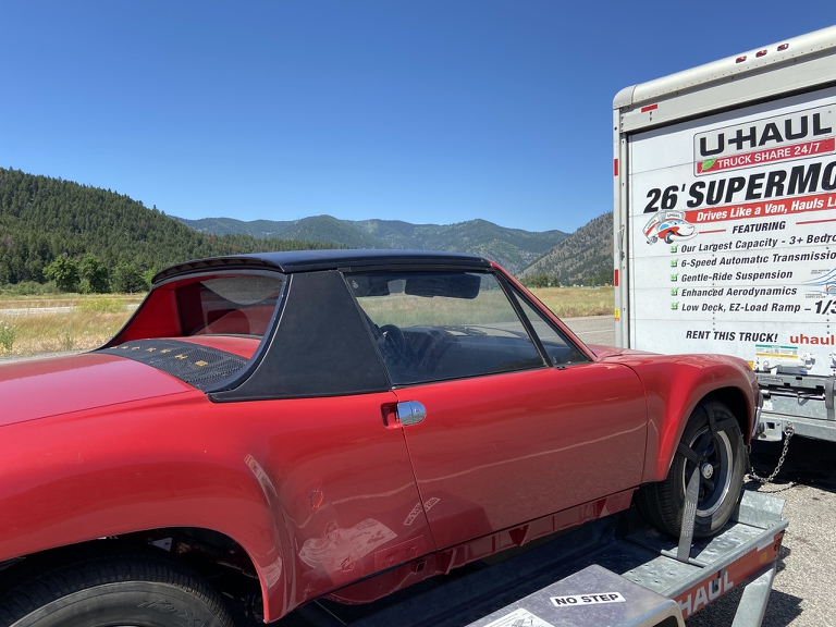

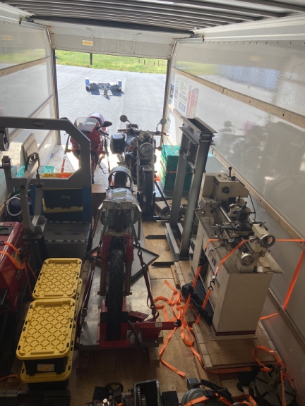

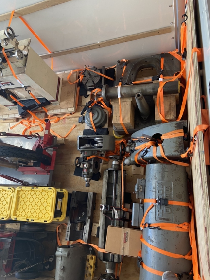

Since I just can't seem to get into another day of packing boxes today I'll post a quick update on the 914 project and the move.
The 914 arrived on the other end successfully.
I hope I never have to move again unless it's to a hole 6' in the ground. Moving 2 cars, 5 motorcycles and a garage full of shop equipment has been a logistics challenge.
I did learn a good trick to using U-Haul's. Put down 3/4 plywood as a floor inside the box. That way, you can tie off stuff to the floor. Normally, this isn't possible since U-haul makes no provisions for actually tying stuff down other than their flimsy 3/4" thick wall boards.
Using the plywood floor, a variety of 2x4 blocking, and about 50 ratchet straps, I was able to get everything tied down. Nothing moved or shifted during the 2200 mile trip(s).

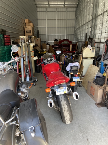

Once the 914 was on the other end, it was put into storage until I can get a garage erected.
The 914 didn't look so bad on the 1st load.
But after the 2nd trip, it's now thoroughly buried.
Final pickup of household stuff / furniture is in a couple weeks. Thankfully that will be done by professional movers.
I did leave my engine parts fairly accessible so maybe with a little luck, I might pull off an engine build (in the house) this winter -- don't mention this to my wife just yet ... (IMG:style_emoticons/default/laugh.gif) She won't be totally surprised though. The black motorcycle in the last picture is a 1964 Honda Dream. The engine to that one was built on the kitchen counter of my studio apartment when I was in college.

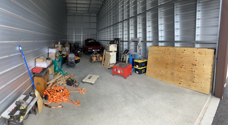

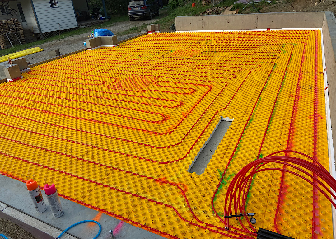

Status Update. I guess since I can’t post on the 914, I’ll post an occasional update on what is keeping me from working on it.
The short version: I don’t have a garage yet. The 914 still languishing in storage. (IMG:style_emoticons/default/sad.gif)
The garage foundation is almost complete. Slab pours next week. (IMG:style_emoticons/default/smile.gif)
The 3’x3’ pads without heating are for hoist placement.
