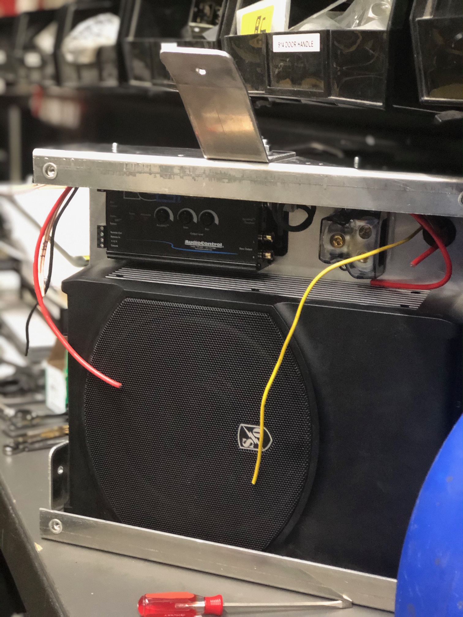

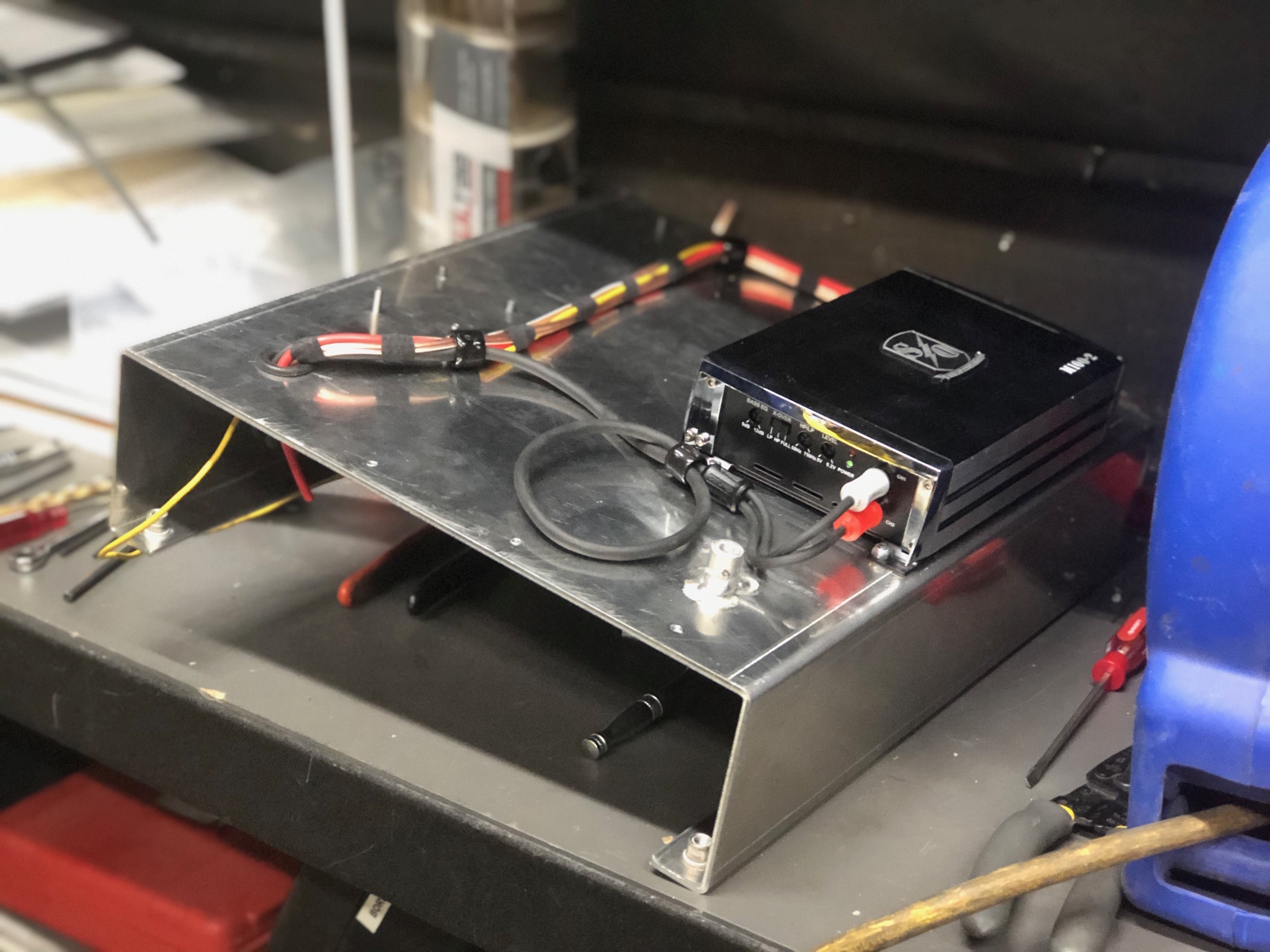

Posted on my 6 build.
From Eric @PMB:
 Testing fitment. Your custom German square weave would cover all of this. Mounting plate would be made to limit intrusion on the body. So far is shy of where the factory foam pieces would go so... all good.
This is the sub that we are using with a Bluetooth control so I can use my phone for a sound library. Fit should look just like a 72 interior as far as the footrest goes. This should sound good
Bob B
http://www.914world.com/bbs2/index.php?sho...7620&st=200
Hi Johnny,
Dale my interior man is building a new 1970 style center console and PMB decided that this was the best set up.
Bob BAttached Image Attached Image
