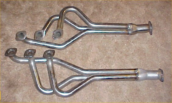

Patrick Motorsports sells the extensions.
bwilless
post Jun 21 2005, 07:09 PM
Posts: 156
Joined: 24-January 03
From: Tempe, AZ
Member No.: 192
pic

Bet they break.... (IMG:http://www.914world.com/bbs2/html/emoticons/dry.gif)

That's what I need. I'll call them and see how much they want. I will also see if I can get the loose parts and weld them up. (IMG:http://www.914world.com/bbs2/html/emoticons/welder.gif) (IMG:http://www.914world.com/bbs2/html/emoticons/welder.gif)
