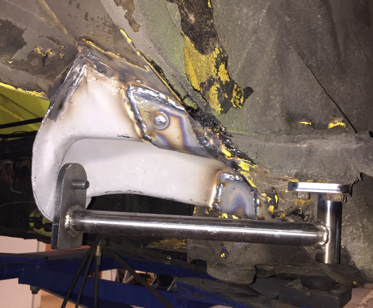

I made this jig as parts of my Celette bench project, specifically with this yellow car in mind. Finally got to doing the work and this beauty worked perfectly. I'm also surprised by just how far off it would have been by just lining up the new metal with the old. This is inevitable with reproduction parts. But that's just part of the game. Now I know and now I've got the jig to make doing it right a lot easier.

I would have bought one of these when I was doing mine. Would that jig also work in reverse to locate the outer suspension console from a correctly positioned ear?

I would say No, it's won't work that way. The outer section is very accurate due to having three mounting holes. The jig is self aligning when mounted on the outer. To do the reverse, you would have to spend more time ensuring the accuracy, because the single mounting hole would allow for quite a bit of movement and essentially infinite rotation options. Also, the outer holes must be in the correct PLANE to be accurate. The inner hole simply has to be at the correct POINT in space. As long as the pivot shaft bolt goes through the hole, it's correct. But that being said, it wouldn't be too difficult to add a third branch to include the motor mount and then I'd have a jig that could be used for inner, outer, OR motor mount replacement with confidence. (IMG:style_emoticons/default/idea.gif)
That's a great explanation of GD&T in a practical, real-world application there.

I would say No, it's won't work that way. The outer section is very accurate due to having three mounting holes. The jig is self aligning when mounted on the outer. To do the reverse, you would have to spend more time ensuring the accuracy, because the single mounting hole would allow for quite a bit of movement and essentially infinite rotation options. Also, the outer holes must be in the correct PLANE to be accurate. The inner hole simply has to be at the correct POINT in space. As long as the pivot shaft bolt goes through the hole, it's correct. But that being said, it wouldn't be too difficult to add a third branch to include the motor mount and then I'd have a jig that could be used for inner, outer, OR motor mount replacement with confidence. idea.gif
Hi Mark,
I have a question about this. I'm going to be replacing the whole right long with a factory part and want to make sure all is well prior to welding it in. My question is you mentioned using a third point for reference. In my case it's going into a factory 6 so there's no engine mounts next to the inner ear. I know there's a factory measurements from the firewall to the inner ear. What would your thoughts be on this.
I have a jig/frame built to hold the chassis but that doesn't mean that things are within factory specs. I would rather install it correctly the first time then have to redo it. Measure a 100 times weld once.. I maybe in for a set of these as well.
McMark
post Mar 5 2019, 02:44 PM
914 Freak!
Posts: 20,180
Joined: 13-March 03
From: Grand Rapids, MI
Member No.: 419
A replacement that large really should be on the Celette bench.
But if you're gonna go without I could make a version where the left and right are attached together. That's still no guarantee things are in the right place though. Going from left to right is a pretty long piece. So small variations get compounded. So if you're basing everything off the left and that's off by 1°, that'll translate to the right being off 25mm or 1". (IMG:style_emoticons/default/yikes.gif) So honestly, I feel like I'd be giving you false confidence.
The big scary part is what I mentioned in the original post. The replacement panels don't necessarily match perfectly. Original pieces may be better, but at this point I'd have a hard time trusting any replacement metal. So if you just line things up, you may feel confident, but it may not be right just because the pieces lined up. (IMG:style_emoticons/default/sad.gif) (IMG:style_emoticons/default/sad.gif) (IMG:style_emoticons/default/sad.gif)
