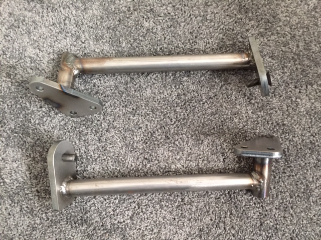

I made this jig as parts of my Celette bench project, specifically with this yellow car in mind. Finally got to doing the work and this beauty worked perfectly. I'm also surprised by just how far off it would have been by just lining up the new metal with the old. This is inevitable with reproduction parts. But that's just part of the game. Now I know and now I've got the jig to make doing it right a lot easier.
Purchase and Rental:
1. Rental: These will be rentable for $100 for 2 weeks, $150 for a month.
2. Purchase: To own a set, it'll be $350 for the pair or $250 for just the right side.
These will take me 2-3 weeks to assemble and ship.
