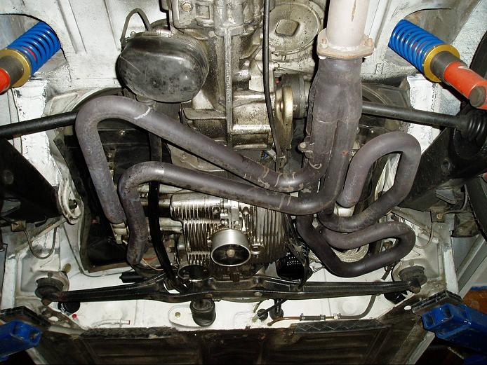

I'm running a Triad West header.
In the picture from Triad Dave's website, you can see why I have a heat problem. This is not my car pictured, but you can imagine if there was a slave cylinder in the space where the clutch cable bracket is how little clearance I have. I don't think I'd have a problem on the street, but during a race the header does get a bit hot.

Wow. That triad header is right on top of your slave cyl alright. I didnt' realize it was the collector camped out right on top of it. I figured you had one pipe that was close. Now I get it. Your collector is much closer than my turbo. You could ceramic coat the header (or wrap it). I bet that would help a bunch.
