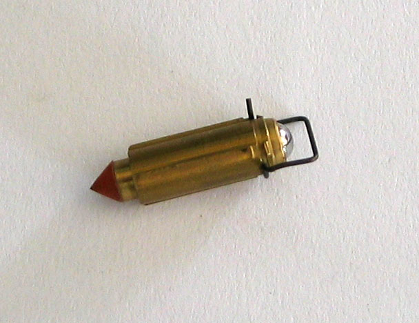

Here's a photo of the needle that came out of my vintage IDF's, the ones I got with the new kit have Vinton tips. Can't hurt to check yours and see what's in there and the condition? You'll want to check the float levels anyway they are typically off from the factory.
Tim

Richard at PMO is a great sounding board for any weber carb rebuild, and he does not hesitate to lend advice. You could call him.
QUOTE(tmessenger @ Mar 21 2019, 08:15 AM) *
Tim

My old IDFs from 80s had solid brass float needles and seats. When did they change to rubber tips? I see your point and I do agree rubber WILL harden with age.
I’ll double down though. Personally I would still just try them without disassembly.
Worst case you get a slight seepage past the needle, which runs up the bowl fuel level and it runs a bit rich. Other potential downside would be continual weepage past needle IF the fuel tank were higher than the carb resulting in gravity feed. This would lead to long term bowl flooding and continued fuel weeping into manifolds during storage which wouldn’t be cool: This isn’t possible in a 914 since tank is below carbs.

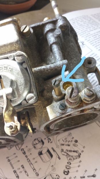

Also, these carbs actually did come set up with port vacuum. They are drilled and blanked on both the port and manifold sides and the port side already has a tube fitting installed. (IMG:style_emoticons/default/piratenanner.gif)

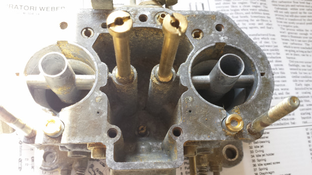

(IMG:style_emoticons/default/unsure.gif)
Wow. I'm looking for the eating crow emoji.
Not what I had envisioned as NOS. Were they stored outdoors?
