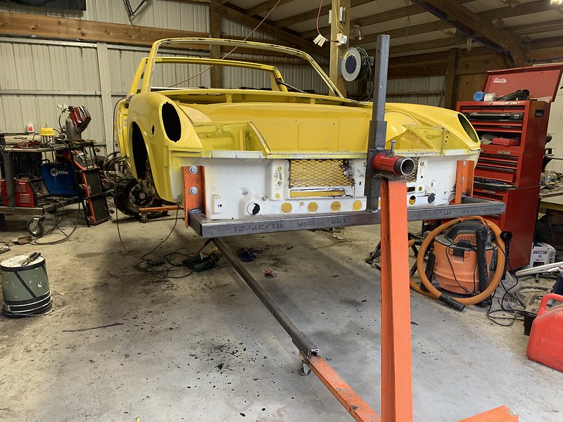

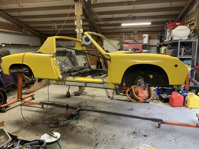

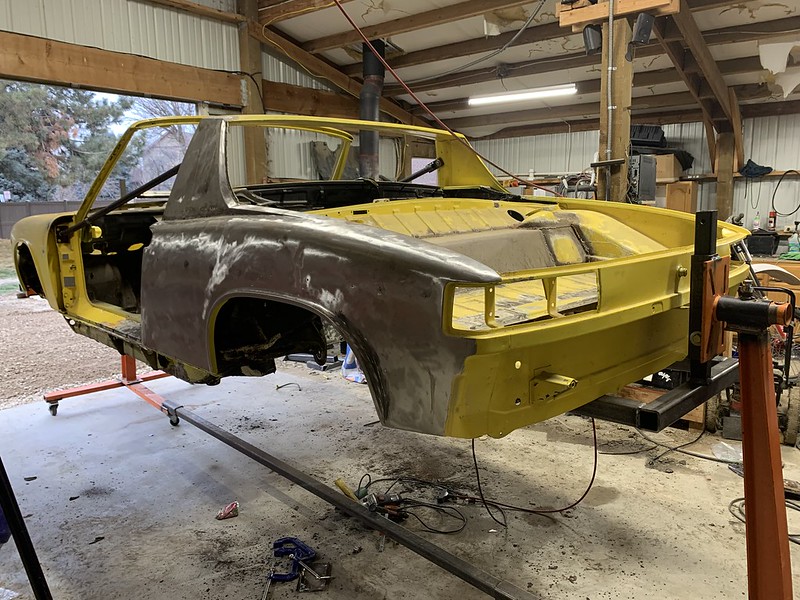

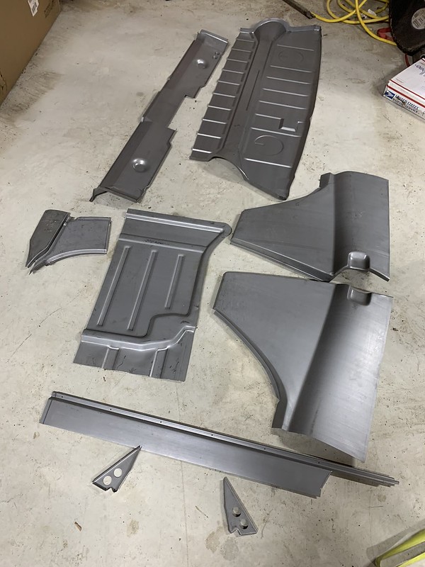

After two years of renovating a new house and barn, I'm finally finding the time (and space) to work on my project. After discovering all the rust spots, I built a rotisserie from some old home depot shelving at the local metal scrap, stripped the car down, and got it up on the skewer, and as I write this am having the tub bead blasted. I also got my RD order with most of the body repair pieces I think I'm going to need.

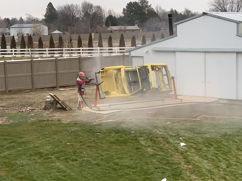

The sandblasting is finished and wow, what a difference. Being able to see everything gives me renewed excitement. There were a couple of surprises - like the tapdance someone had performed and then covered with filler on the targa roll bar. WTF!! Also, the seal trim in the front is a bit worse than I thought. But otherwise, nothing that I didn't suspect.

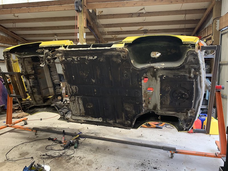

So after a few well-spent bucks, a huge mess in front of my shop, and an hour with the leafblower - here's what we're looking at...

Here's the money shot. This made sandblasting worth every penny:
